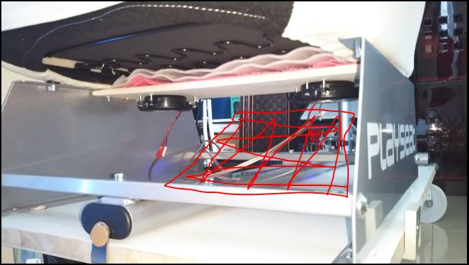

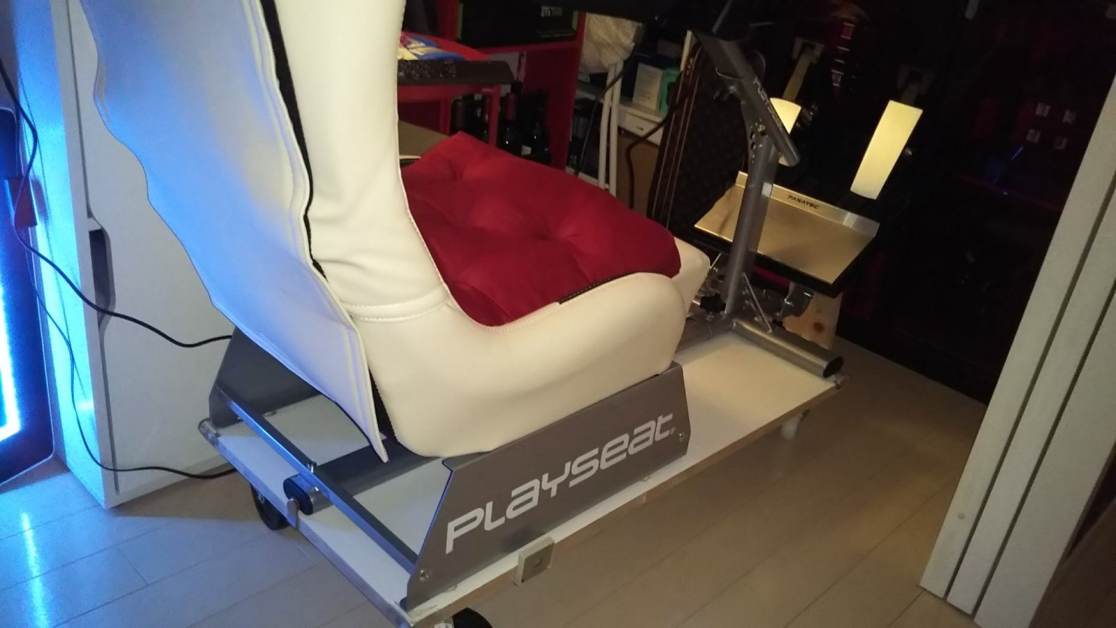

    I have been building my 1st Simrig since the beginning of the year going with a PLAYSEAT Evolution now sitting on a plywood board with industrial casters simple yet effecient DIY.

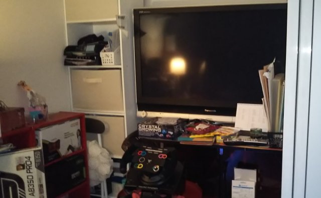

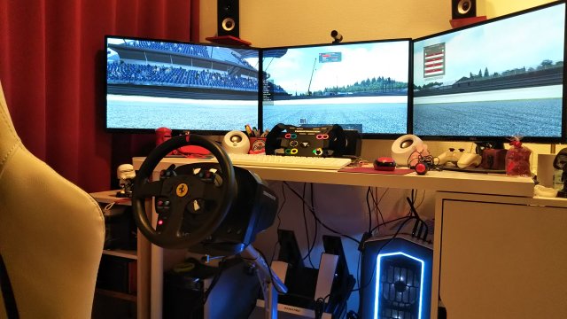

    My rig is indeed sitting in my private Office with a rather small available space (roughly 8sqm) and I am switching between gaming on Triple screens or TV if the Sim does not support triples well (ACC do you hear me....) so I needed compactness and mobility altogether
    I think the pics attached are self explanatory for you guys to figure out.Its a cramped space but I think I have managed it well for the 2 intended purposes.

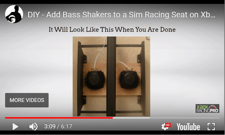

    Last month I decided to move one step more far with immersion adding bass shakers (2 DAYTON pucs) under the seat.Once the Japan holiday are finished and I go back home,I will add one more puc on the back of the seat and one puc under my pedals plate.
    All the bass shakers will be driven by a 5.1 amp on the hardware side, and SImhub and VMB for the telemetry tactile effects.
    Tactile feedback has been a fantastic upgrade to my whole simracing experience.

    I understand the DOFreality MS2 has specific mount for my Playseat but I am concerned with packaging constraints due to motors and arms creating possible clash with my DAYTON pucs as well as the amp driving them.
    I am also a bit concerned with how the plywood board would cope with the actual motion effects. The 2 caters at the back have brakes but I wonder if that would be sufficient to keep things stable while driving long runs.
    Also potentially concerned with the strength of the plywood getting hammered continuously with pitch&roll movements.

    Unfortunately, bass shakers need to remove, there will simply be no space for them under the chair.
    The strength of the plywood will be enough for the SM2 due to the limited movement and speed of the platform itself.
    I would recommend to look at the model H2, it compact as Playseat and you can also attach wheels for transportation and with bass shakers. Also in the future it will be possible to improve to the version with three axes.
