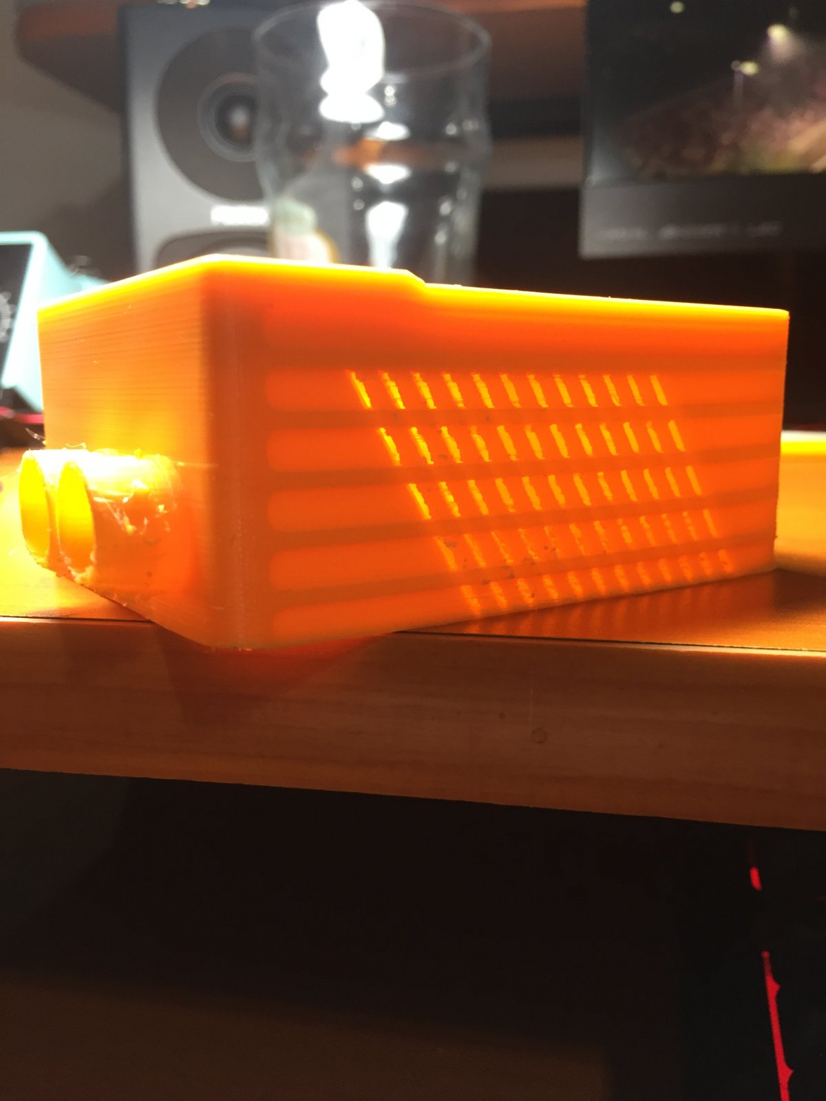

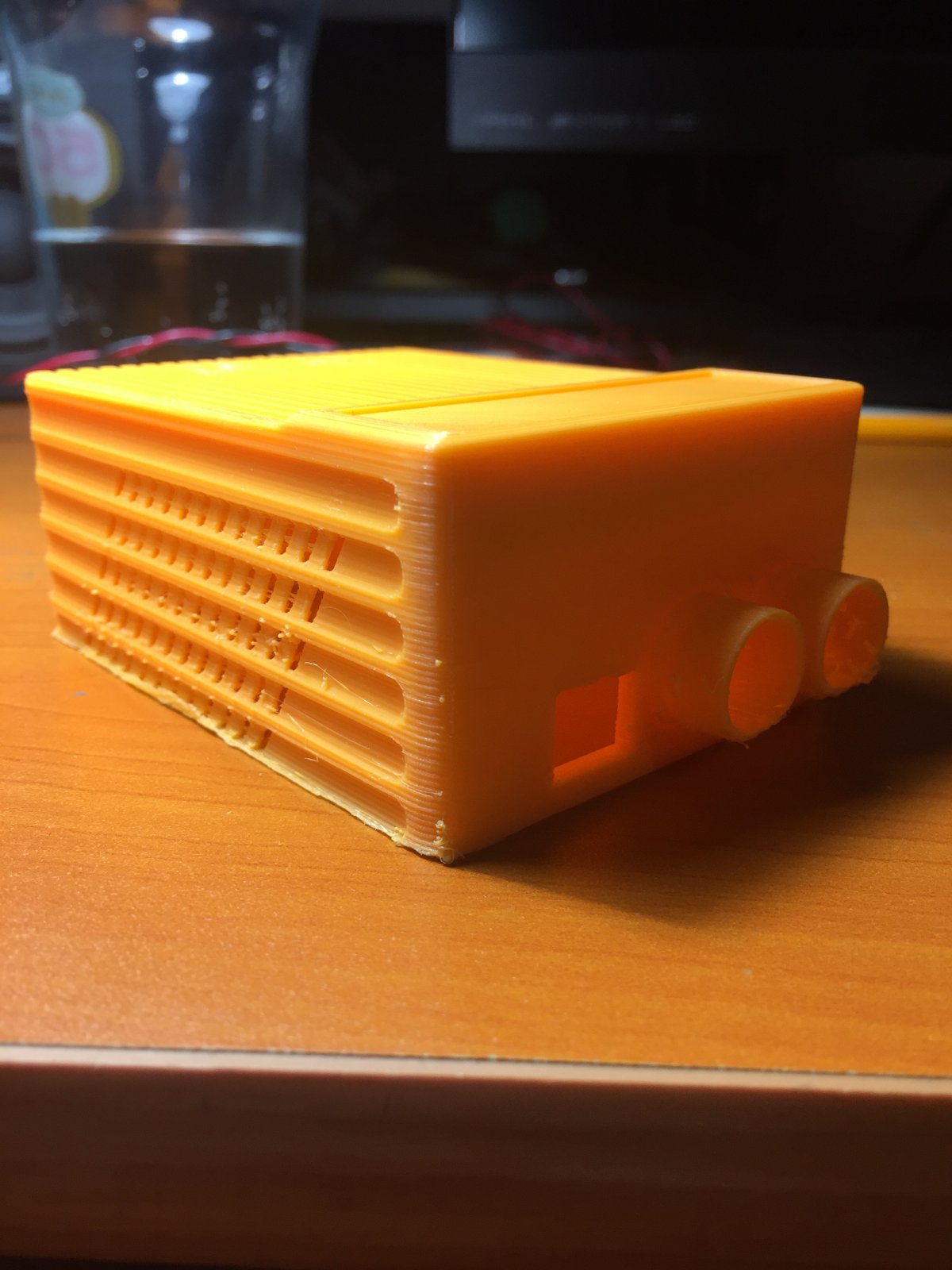

    IMG_1482.JPG SO far I've printed a box for my arduino and adafruit motorshield from here. Any setup tips to reduce those stringy fuzzies you see would be appreciated. https://www.thingiverse.com/thing:2781281

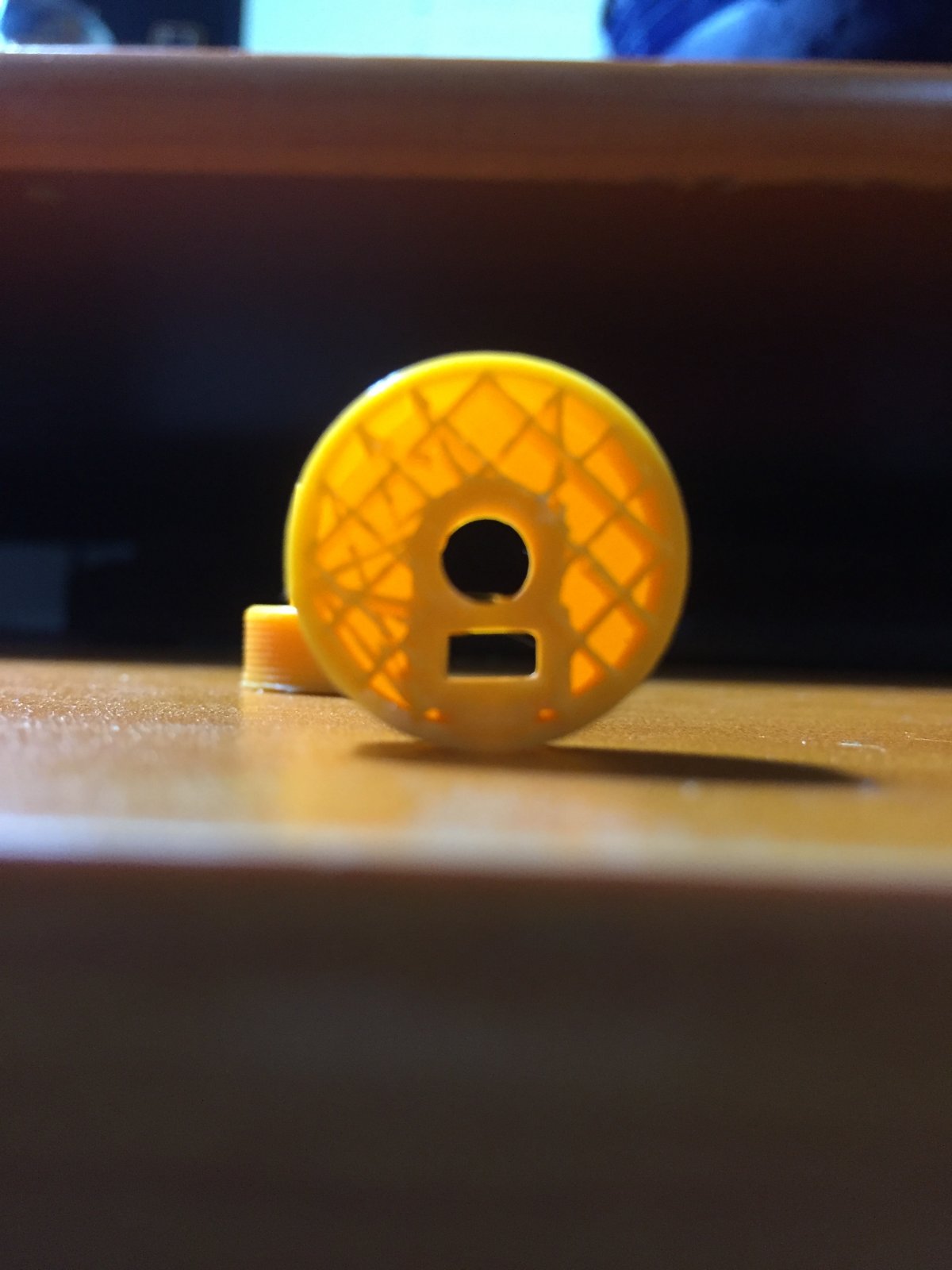

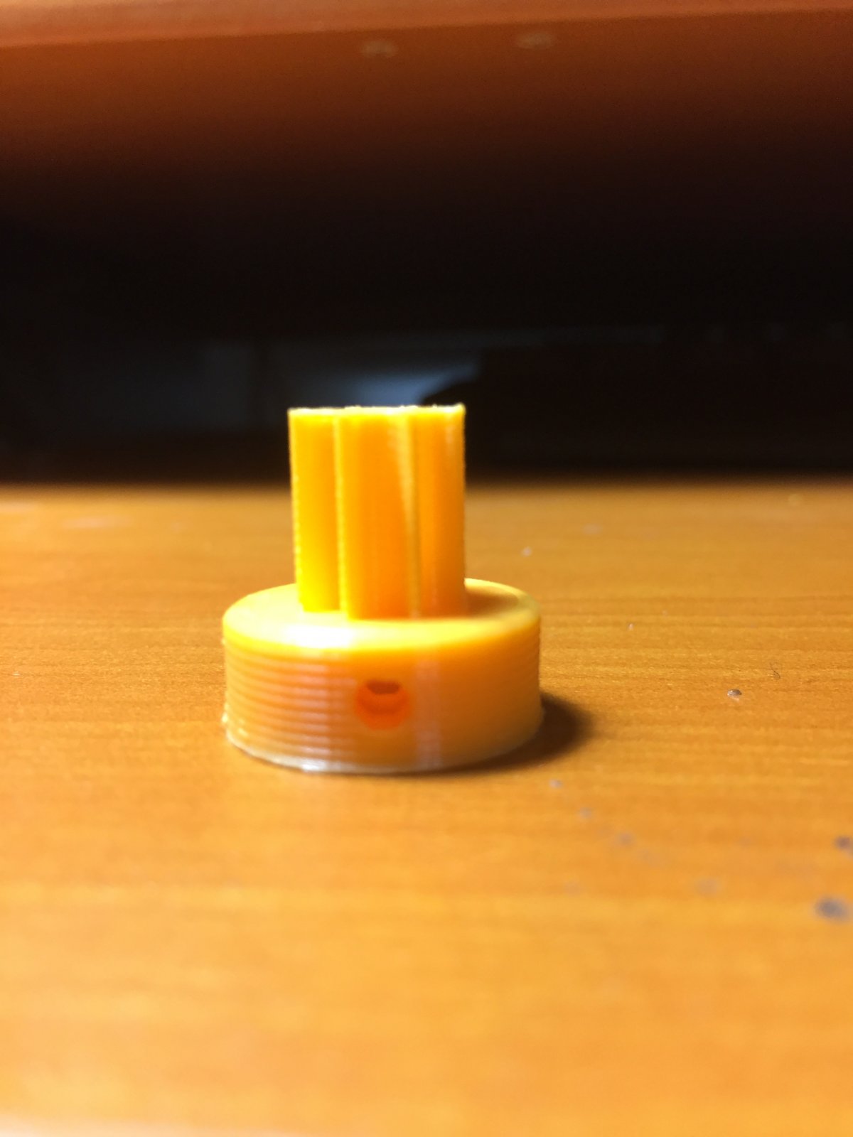

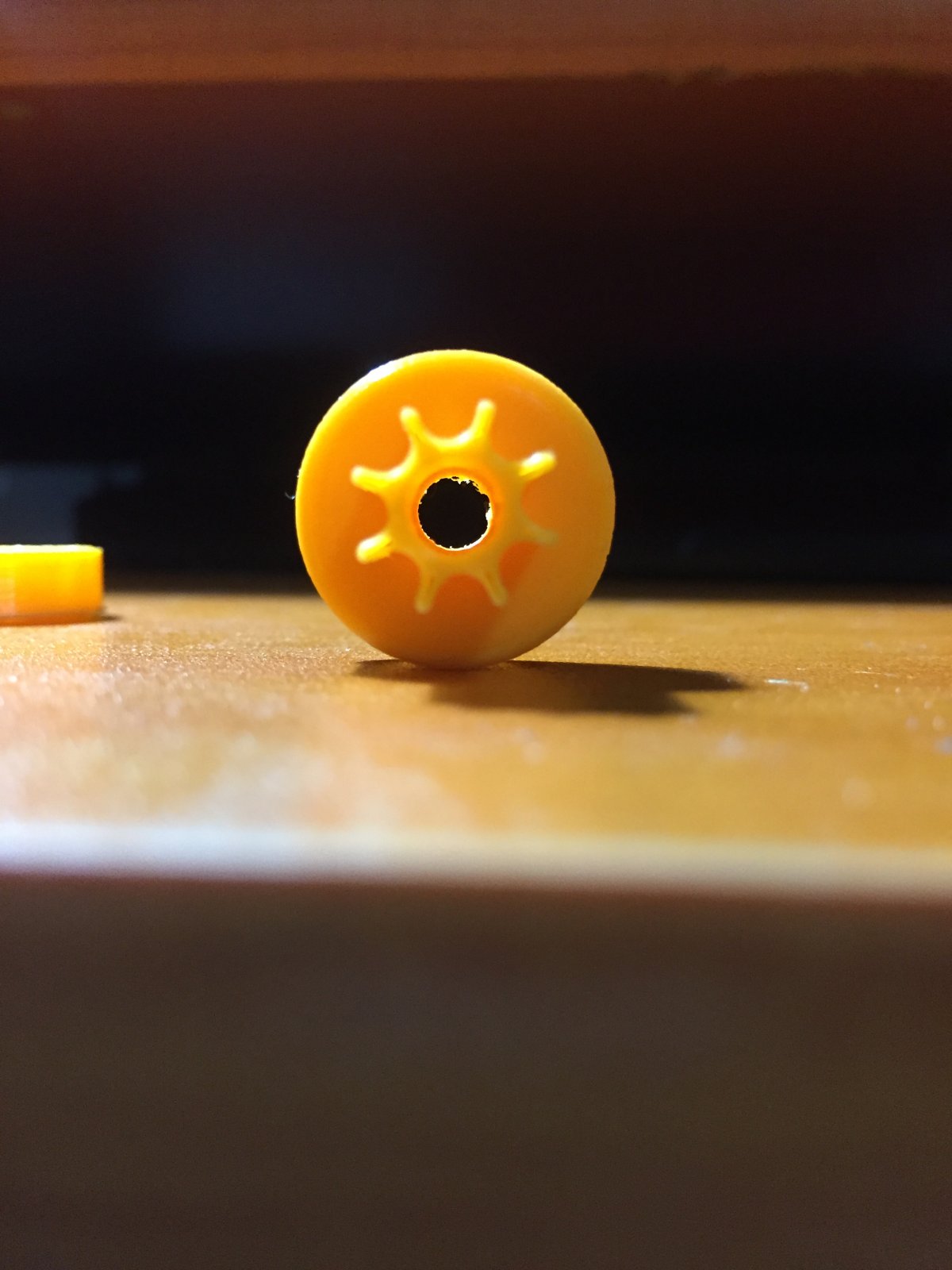

    A GT2 Pulley that failed, then one that worked. I tried streaming the gcode for the failed part via USB. I'll just stick with the SD card for now. It is interesting to see the internal structure, and how it's adjustable. What a time to be alive.
    I have downloaded Fusion 360 and OpensCad. I can't describe the amazement I felt and still feel watching these things work. I imagine a future where manufacturing can be done from home and the plastic polluting the oceans can be farmed and recycled into new materials over and over. Just imagining.

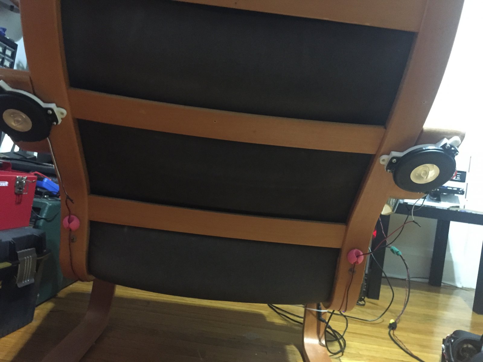

    I ran out of PLA and picked up 1kg of ABS and 1kg of PETG. They are noticeably more difficult to work with. I switched to blue tape with the PETG and ABS with better results than the tack paper or whatever came with the printer.
    Made a couple holders for my Dayton Audio pucks. A big improvement over mounting them on a board and screwing it to my chair.
