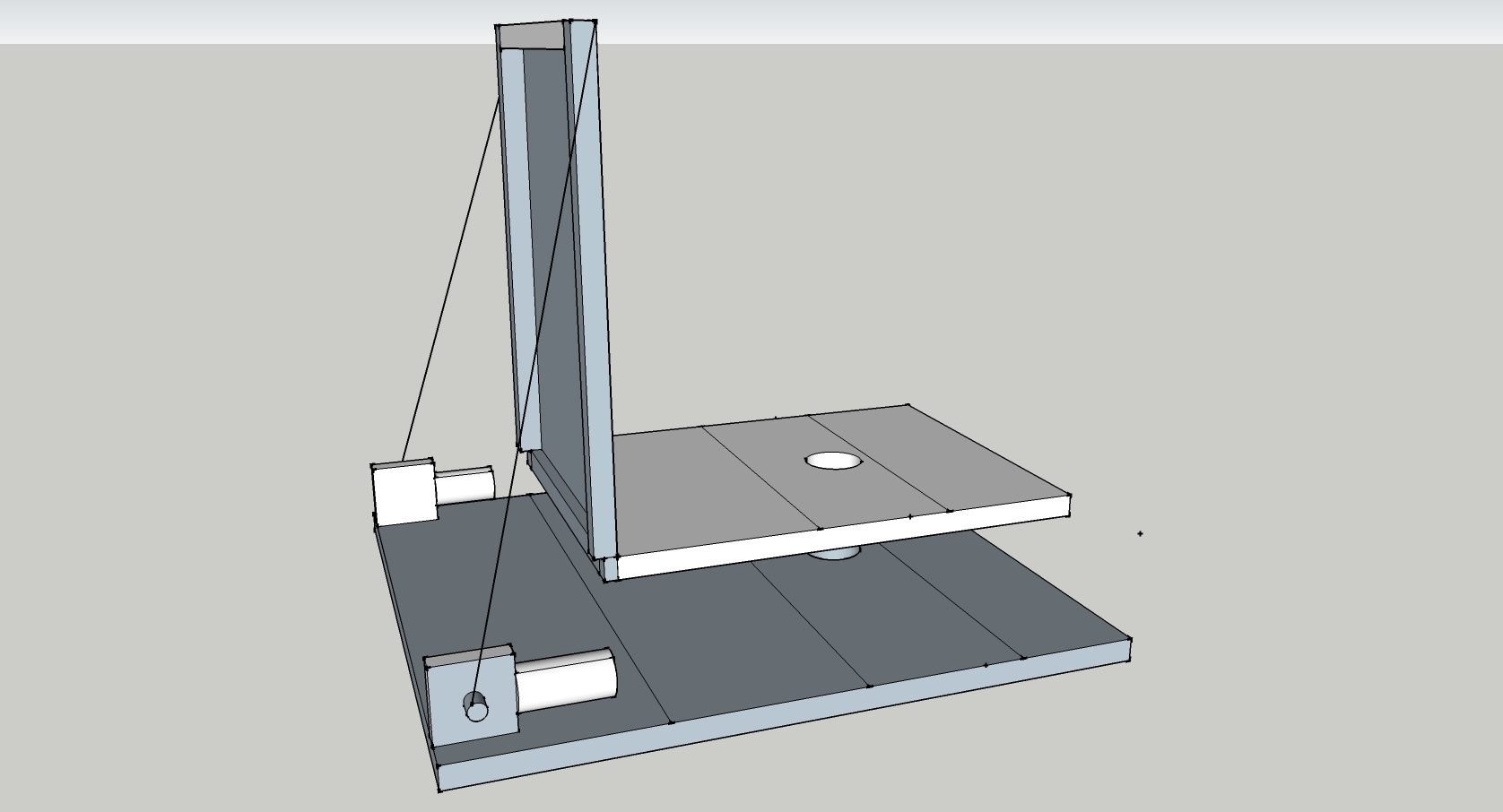

    i want to change the original RnR cylinder with new one, maybe the Festo DSN-20-40-P or i add them to the existing org. cylinders for more power
    the original cyl. have a lifting/movement (?) about 20 to 25 cm, it will be a problem with larger cylinder with a movement of 40cm ? how can i limit them ?

    You have two way for more power, bigger pressure, or bigger cylinder diameter (same when you use two cylinder).
    1 bar=100000 Pa, 1Pa=1N/m2
    When we have a 4 bar pressure, with 4cm diameter cylinder (400000Pa*0.02m*0.02m*3.14=)502N~50kg (i hope my calculation right :D, check it pls)
    When u need a double power, try with 6bar, and 5cm diameter= 1177N
    When u use a 400mm cylinder, (but only need ~200mm) place the potis at full range of movements (or protect then for crashing) because the simulator weight its move over a bit. You can set the maximum and the minimum working range of the potis, in the 2.0 X-Sim. When the simulator reach this point, the software stops the sign.

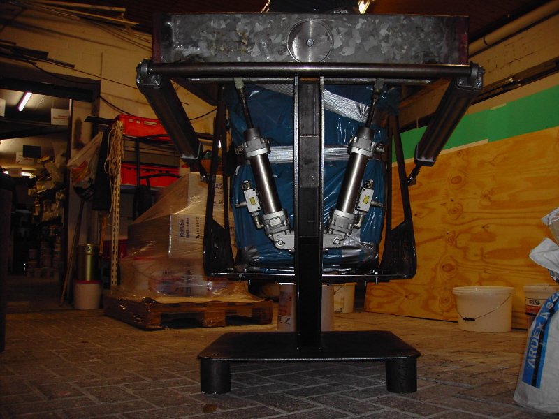

    at the moment, i allready use up to 5 bar, mei weight is about 110 kg (193 cm and very heavy bones ;-) ) an the movement of die RnR is sometimes to slow. (im in the testtime with the org. interface and will change to the usb interface soon)
    i think its better to change the org. cylinders with some new one with bigger diameter, im not really want to weld some new mountingpoints at the RnR ;-)

    All depends on the cockpit balance. check this
    50mm dia. cylinder with 5bar, still enough to move everything! :D (check mine, 50mm*400, between 4-5 bar, without a good balance, still now)
    Just, be sure that you to have enough air, in a big tank.
