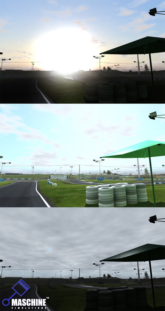

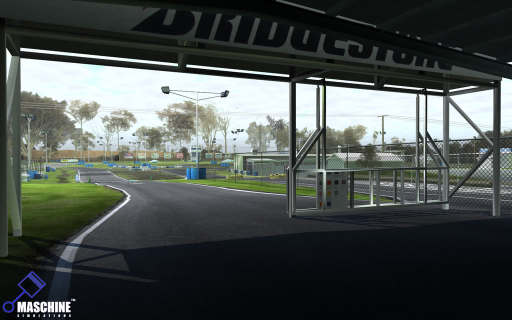

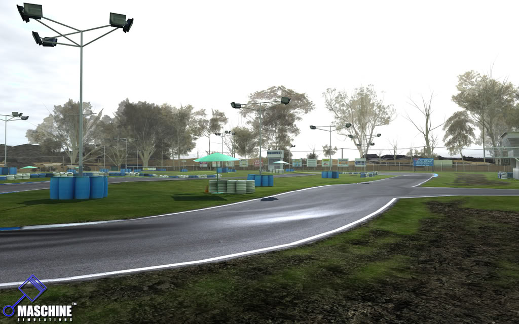

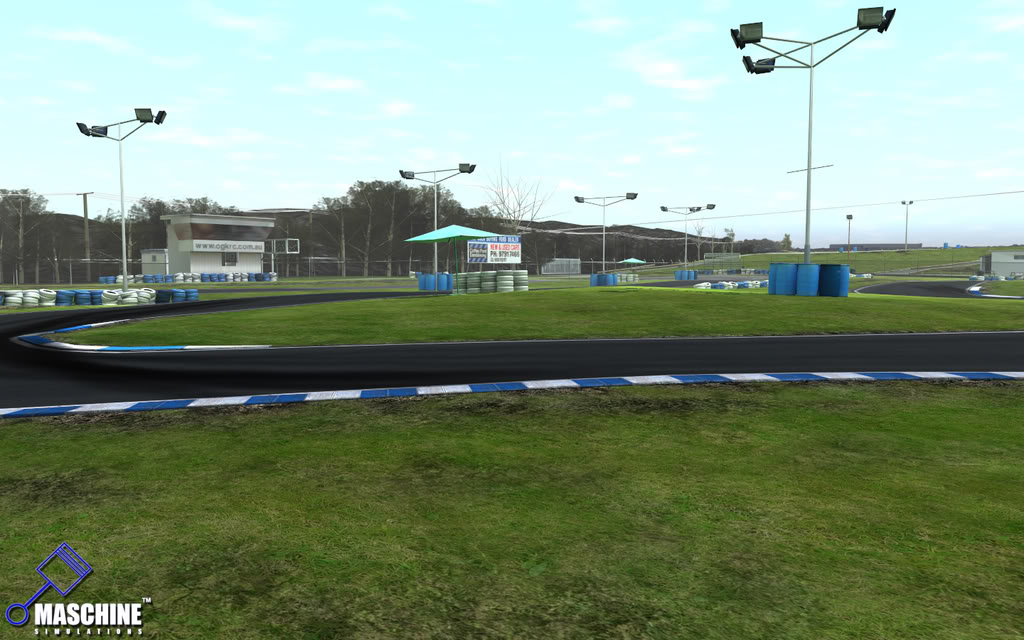

    We're currently developing KartSim which you may have heard of. I've put a few screenshots of it below.
