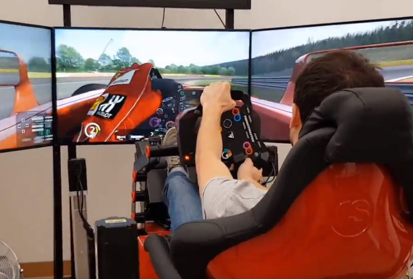

    This is a video for example with a Rseat Formula 2 :

    Hi, to be honest, and please do not understand my remarks as an offense - heave, surge, sway and yaw are quite limited, the buzzing is bugging. Especially in real a F1 car you suffer from the bumbs - virtually no suspension (see here) The actuators are pretty high and therefore visible in front of the middle screen (vr not affected of course). Since you are pros you should know that Assetto Corsa is natively supporting triples with a correct view of angel (and not stretched as we can see in your video). What I like is the clear design. On the other hand the price is very high, starting from 8 490,00 € up to 19990,00 is not to be sneezed at all

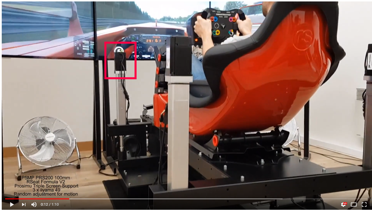

    The actuators are not hight : where do you see the actuators at the middle of the screen? Or i don't understand your explanation.[​IMG]

    Sorry, i did not mean "in the middle", I have written "visible in front of the middle screen". As a result of the height of the front actuators the screens are far away from the driver. upload_2018-9-18_15-50-5.png

    With the Formula V2 the pedals are higher than actuators, so the screen must be after the pedals.
