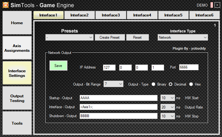

    I had remove v1.3 and install v2.1 yesterday, and the output rate is still low. (I found the packet rate change to output rate in v2.1)

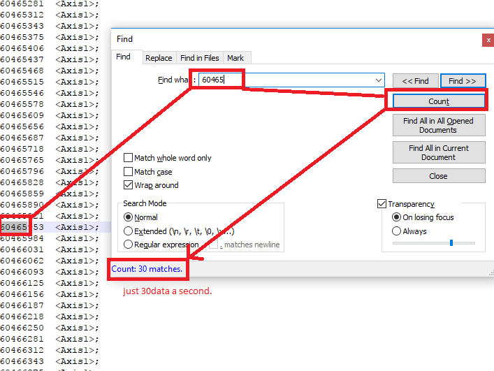

    To simplify the question. I provide the step to reproduce the phenomenon.
    1. Lunches game engine, setup interface settings as bellows.
    1.1. interface type = network
    1.2. ip=127.0.0.1, port=6666
    1.3. output - bit rate=7, type=decimal
    1.4. interface output=<Axis1>;, output rate=20ms
    2. Lunches a receiving program to receive the data.
    3. Switch to output testing in game engine, and press turn on button.
    The game engine start to send data to receiving program.
    Then I count the data in a second, and found just 30 data in a second.
    I used this in different desktop, and results are all the same. How can I make the output data=50 when output rate sets to 20ms?
    Thanks very much.

    I upload 2 picture for my setting and result.

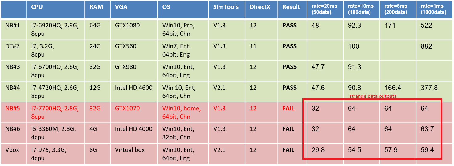

    Here I upload my testing result, I can't understand why NB5, NB6, VBox data output are 32data, 64data... It looks something wrong..

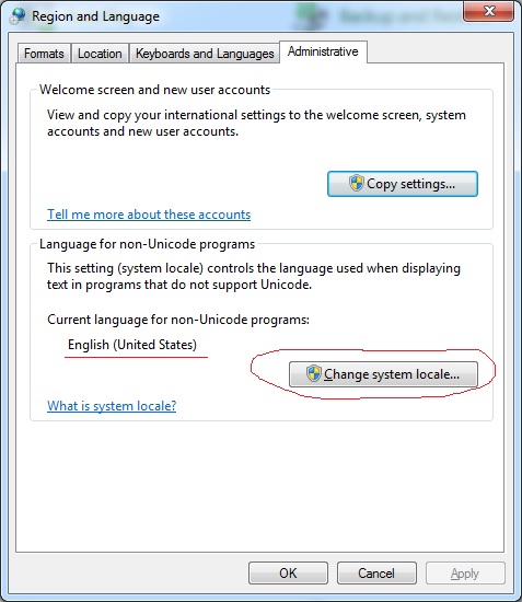

  11. yobuddy
    5,433
    51,015Coins
    +5,181 / 19 / -0
    See if this makes a difference on your system buddy.

    astone New Member
    Aug 17, 2017
    9
    taipei, taiwan
    244Coins
    Whatever win 10 is Chinese version or English version, all of them already set to "English(United States)".
