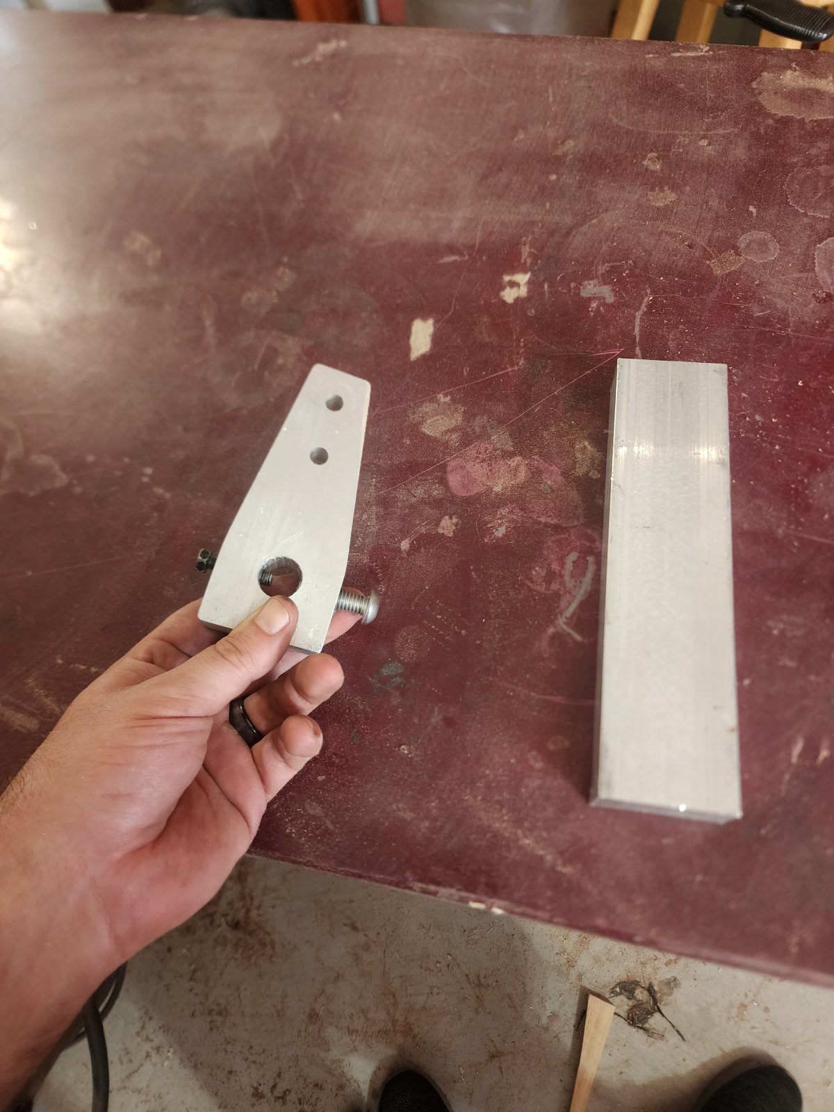

    sorry i cant help dont have the size. When you make youre one and you want a presice fit
    drill hole 16.9 mm and use a hand reamer 17h7
    regards Ad

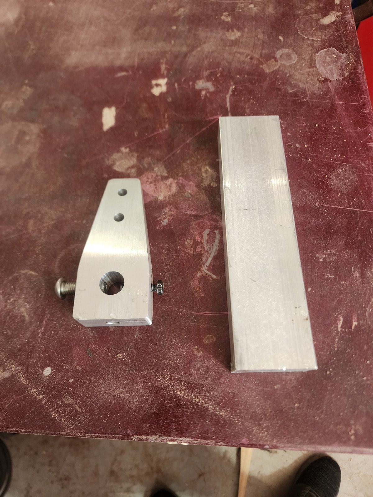

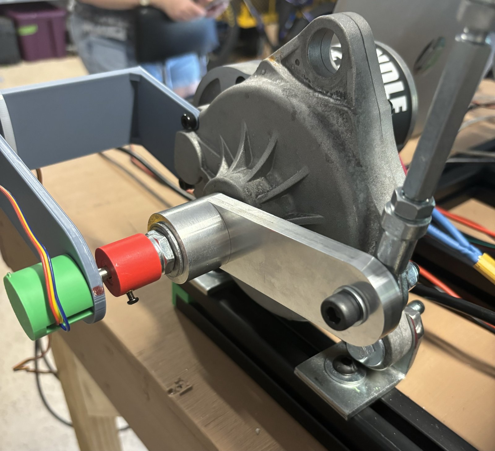

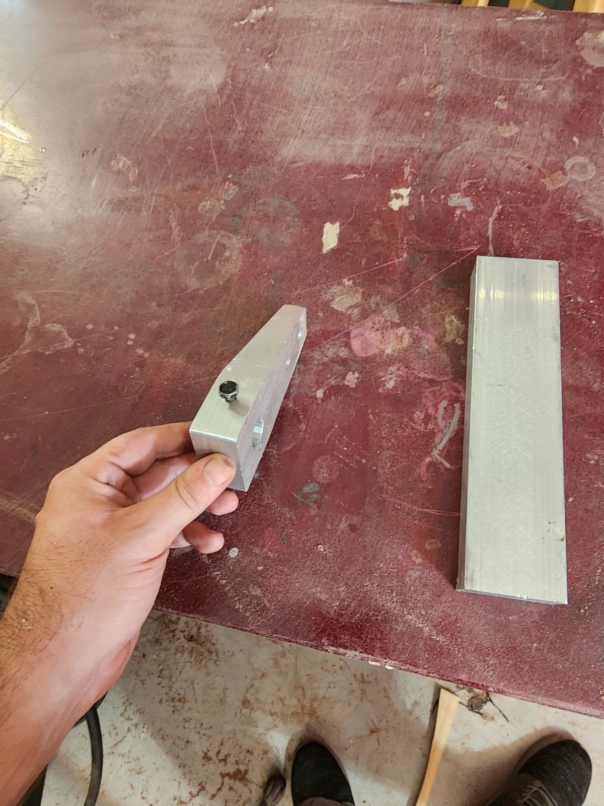

    I did a thing! I only have a drill press and some basic metal tools, BUT here are my new control arms.
    I bought a end mill bit and very carefully and SLOWLY, milled these out of solid bar aluminum.
    -P.S. - Thank you adgun. The hand reamer worked perfectly and the fit is extremely tight.

    Thanks Yinger
    I am happy to hear becauce i made a mistake the hole must be 16.7 not 16.9 mm before the reamer
    This is the old way to make presice holes.
