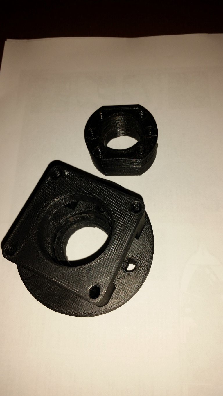

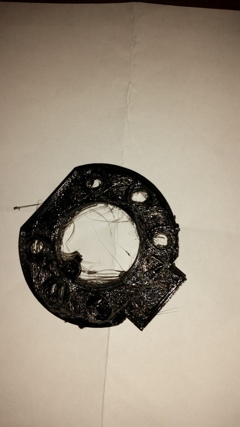

    I recently purchased a roll of PETG filament and have been having major problems trying to print with it. It seems to be stringy and huge globs appear in the print which end up meaning i have to stop the print, since the print head wont go over them.
    I am printing it at 230c. its 1.75mm filament. 0.2mm nozzle.
    I have tried slowing the feed rate but still get problems and I upped the hotend temp from 215c to 230c which didnt seem to help either.
    Has anyone experienced this before and can recommend what I might be doing wrong?
    Alternately - could it just be a bad batch of filament?

    hopefully this illustrates problem. this was a test print so i can check sizes and shrinkage etc. With the big blob in the centre i didnt allow it to finish printing, but you can see the stringy natures, plus the blobs.

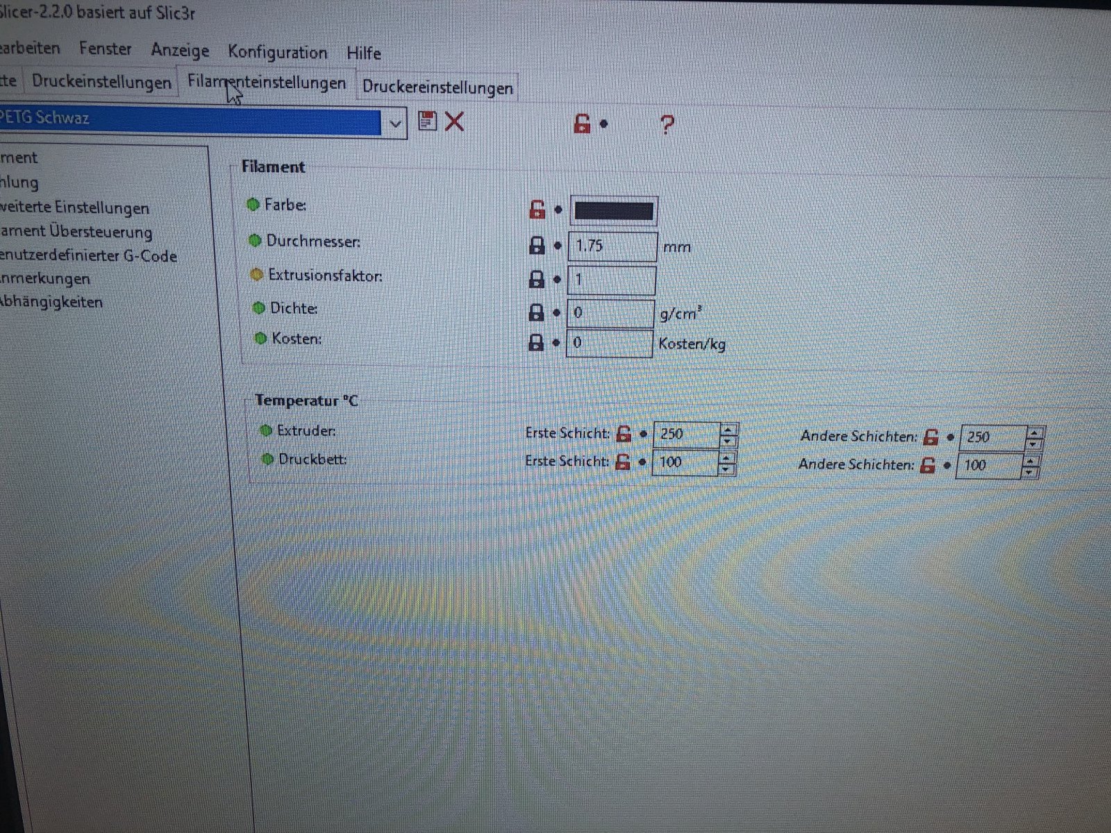

    I print PET-G with a 0.4 nozzle at 250 degrees C.

    wow, thanks. if mine came out like that i would be very happy.
    I will try and emulate some of your settings and see how i go.

    I also print PET-G with a 0.4mm nozzle at temps between 240 and 250 at 60mm/s depending on the filament that arrives as they vary a bit. Its a little hard to tell from a single photo but looks like the problems i was having before i upgraded to a j-head v6. The nozzle heats up initially before you start printing but as the filament passes through the nozzle it cools as it heats the plastic until the nozzle temp drops bellow the PET-G melting point and jams the nozzle. Once it is jammed and no more filament can pass the heater brings the nozzle temp up again as the filament is no longer moving and where the extruder was still trying to push filament through while jammed that pressure causes a blob with a string on it. Also the retract wont work while jammed no matter what the settings are. Nearly drove me mental i can tell you.
    The things i would try are raising the nozzle temp to 250C and turn the print speed down to about 30mm/s until you get it printing and the bring the print speed up until problems start then back it off a bit.
    If you are using a Bowden setup then this will increase the problem as there is loads of elasticity in the Bowden tube. I use a direct drive extruder with a mount that i printed myself from a thingiverse design that allows me to print PLA, PET-G, ABS, TPU as these are the ones ive tried. My next adventure is a hardened steel nozzle and carbon fibre.
    You may have a completely different problem to the one above but it might help
    Does your printer print PLA ok?

    Thanks @yellofella I print PLA and ABS with no problems. One thing I found after watching it carefully for a long time, was the petg was oozing out from where the heater block joins the threaded throat. That was causing the blobs. I tightened the heater block to the throat while whole unit was at printing temp and it improved that part of the print.
    I am going to run some ABS and try a couple of prints to make sure everything is working and the filament is the problem - not some other printer issue. Then I can try the larger nozzle.

    The filament oozing out of the top of heater block is usually a sign that the hotend was not put together properly before printing. There can be no gap at all between the threaded throat and the nozzle inside the heat block or the filament will melt and run up the threads and produce the mess that you describe dripping off the heat block. I myself would change the threaded throat, nozzle and heat block for new ones as they probably wont come apart now that there is melted filament gluing all 3 parts together and you will probably snap the threaded throat when you try to remove it from the heat block now anyway.
    The procedure for installing the nozzle/hotend is as follows
    While cold screw new 0.4mm nozzle all the way into the heat block with fingers then slacken off a quarter of a turn.
    Screw threaded throat all the way into the heat block so it is touching the nozzle (there can be NO GAP).
    Heat hotend to its maximum with no filament loaded then tighten the nozzle the quarter turn that you backed off before with a spanner to create a good seal between the threaded throat and nozzle (referred to as hot tightening). You have to make sure that you hot tighten the nozzle at a temp above what the printing temp will be and please be carefull as it is extremely hot. Also be aware that the spanner you will be tightening the nozzle with is made of metal and will suck the heat out of the hotend while tightening so be fairly quick with the spanner then let it heat up again for a few seconds then check its tight. It may not need the full quarter turn but you get what i mean.
    This will completely stop the problems you are having with the blobbing and get you printing buddy.

    Fantastic, thanks for the help everyone. I replaced the heater block and throat and did the hot tightening thing. I have been able to print in ABS with no issues.
    Now to test for PETG again.

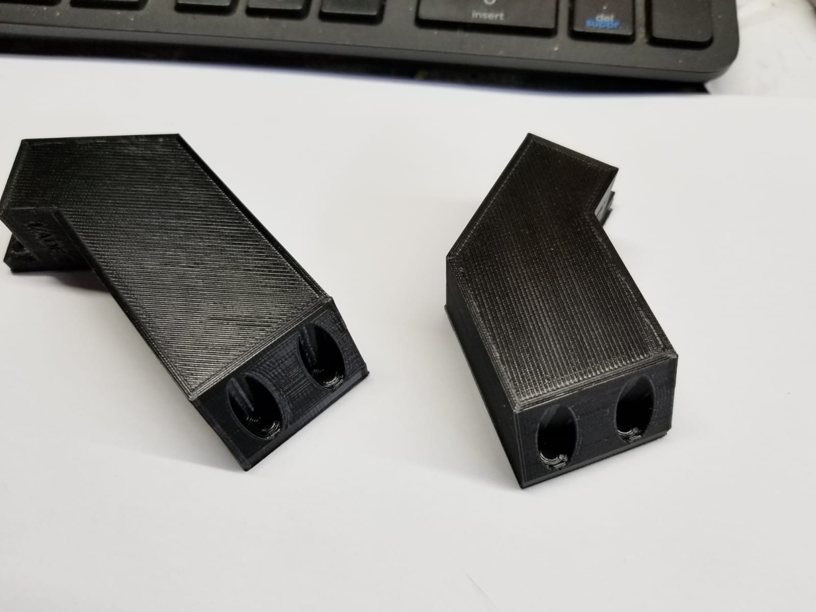

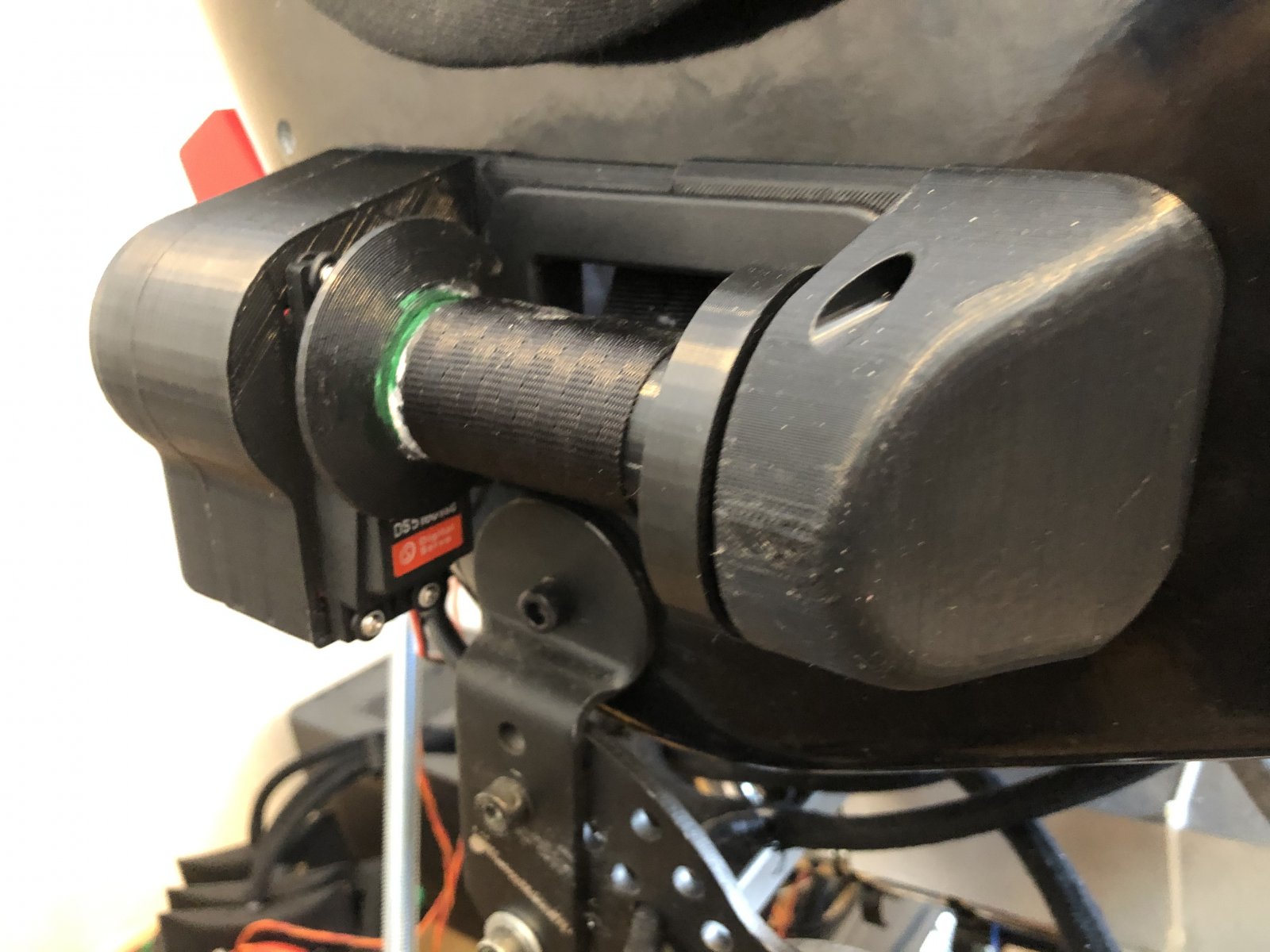

    Here are the latest prints after taking some of the steps advised by yellofella and xxpelle.
    Much better quality than previously. These are in ABS not petG though.

    Sounds like you need to calibrate your settings; especially if you haven't done so already. Make sure temp, esteps, z height and flow are are calibrated. Keep in mind, PETG generally needs around 5-10c more than PLA. I use an all-metal hot end, sand print at 245c nozzle and 65c bed.

    petg is a bit tricky compared to PLA or ABS. all petg filaments from different manufacturers have slightly different properties which will greatly affect the stringing and quality of your prints. Requires quite a bit of tuning for the filament up front, so once you got a good working profile save it and always buy the same brand to keep this consistent. You will need to tune for speed, retract speed & distance, and temperature. I've seen some PETG work well at 210*C whereas others would need to be heated up to 240*C to function properly. All of this needs to be found out as part of your tuning process for that material, best way is to download print something called a temperature tower and also a stringing test. Search on thingiverse and a lot of items will come up for you to test. Even the best tuned printer will still have a bit of stringing or runoff while printing PETG, unless you incorporate things like nozzle wiping, etc but those greatly increase print time. It's just nature of the beast and you will need to deal with it in post processing step. For wall speeds I'd recommend something in between 25-40 mm/s with overall print speed of 40-60. Travel speed should be 120 mm/s
    edit: to specifically answer your OP: if you see stringing, you generally want to *lower* your print temp. Oozing means the filament is liquifying too much, and is a result of it being melted at a higher temperature.
