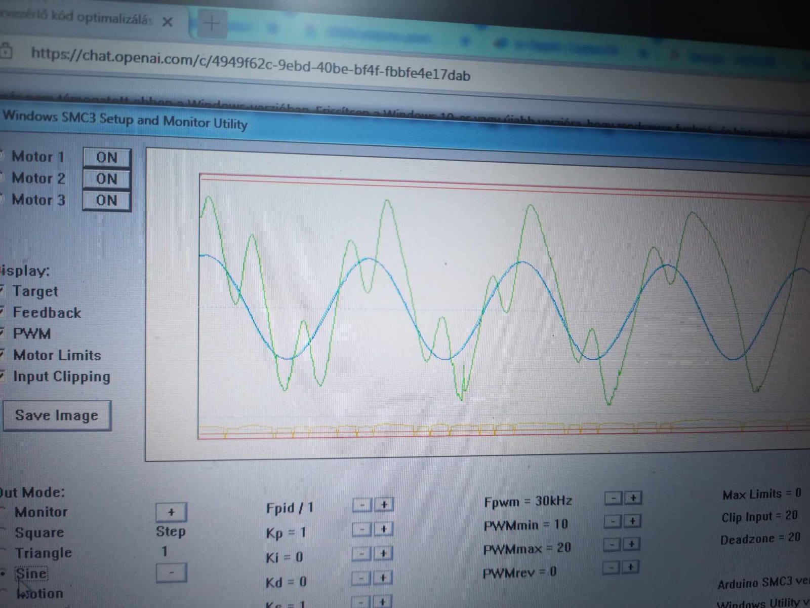

    The system looks like this: there are 4 working cylinders with 4 control valves (R414002005). I branched out from the outputs of the valves, with one branch connected to the lower part of one working cylinder, while the other branch is connected to the upper part of another working cylinder. To control these, an analog signal of 0-10 volts is required, so I received a TLC2272 operational amplifier. Feedback is provided by two SM6-160 (R412010411) mounted on two working cylinders, which also communicate on 0-10V, thus receiving some resistance.
    I've approached the issue in several ways, tried putting analog signal directly to the output, tried with ibt2 and l293 insertion, and currently, the program is in MODE1, with each input of TLC2272 connected to a direction (IN1+, IN1- ---> ENA, PWM; IN2+, IN2- ---> ENB, PWM), with outputs going to the two valves working in opposition.
    Truth be told, I've reached the same point through various routes where I'm stuck now. When I start the system according to the description, I set all variables related to PID to 0, and the system stops. As I increase the Kp value even just to 1, the system starts moving, goes to the requested position, and starts oscillating there. For instance, if I choose "sine," it follows the signal and oscillates around it. The PWM values are still at zero. I'm attaching a few pictures and the currently modified code snippet.
    Please somebody help me.

    can you increase the deadzone ?
    perhaps you need a stop routine till the potentiometer is out of range

    Deadzone in 20, but if i change it, nothings happen.

    can the internal valves move quick enough ?
    increase the P number - see what happens

    Actually, changing any of the values doesn't seem to have much effect. If kp=1 and kd is around 60, the amplitude of the oscillation decreases, sometimes stopping for 1-2 seconds, but in return, it doesn't move smoothly, rather erratically. I believe the significant difference between the two systems, and consequently in the program, is that while with the motor, you need to stop it, with pneumatics, you should maintain uniform pressure when in position to prevent the platform from moving due to its weight. So, there are two possibilities for the error: either it overshoots and repeatedly corrects itself, or it stops in position, shutting off the valve, or it adjusts to an improper pressure, causing the weight to shift. However, for consistency, I would lean towards the former.
