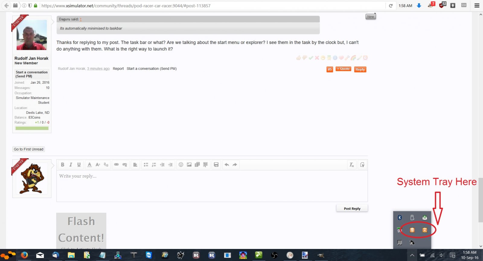

    Thanks for replying to my post. The task bar or what? Are we talking about the start menu or explorer? I see them in the task by the clock but, I can't do anything with them. What is the right way to launch it?

    They minimise to the Windows system tray:

    @Rudolf Jan Horak Once you launch both SimTools programs they get minimised to task bar by the clock click the show hidden icons arrow (windows 10) then double click both game engine and game manager and it will open on your desktop

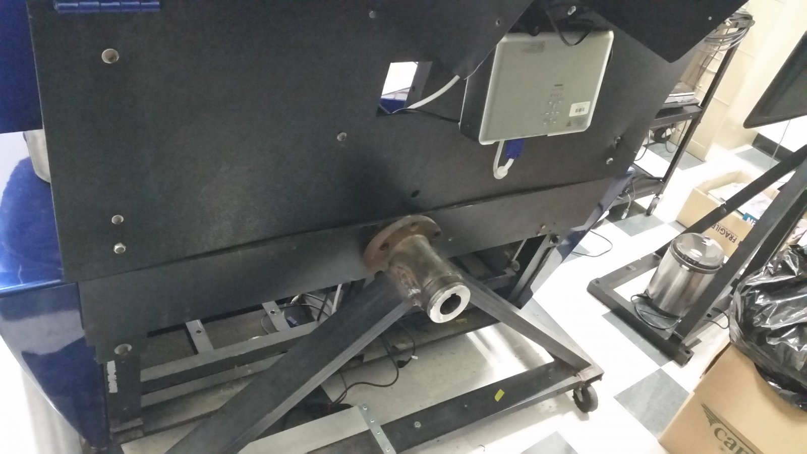

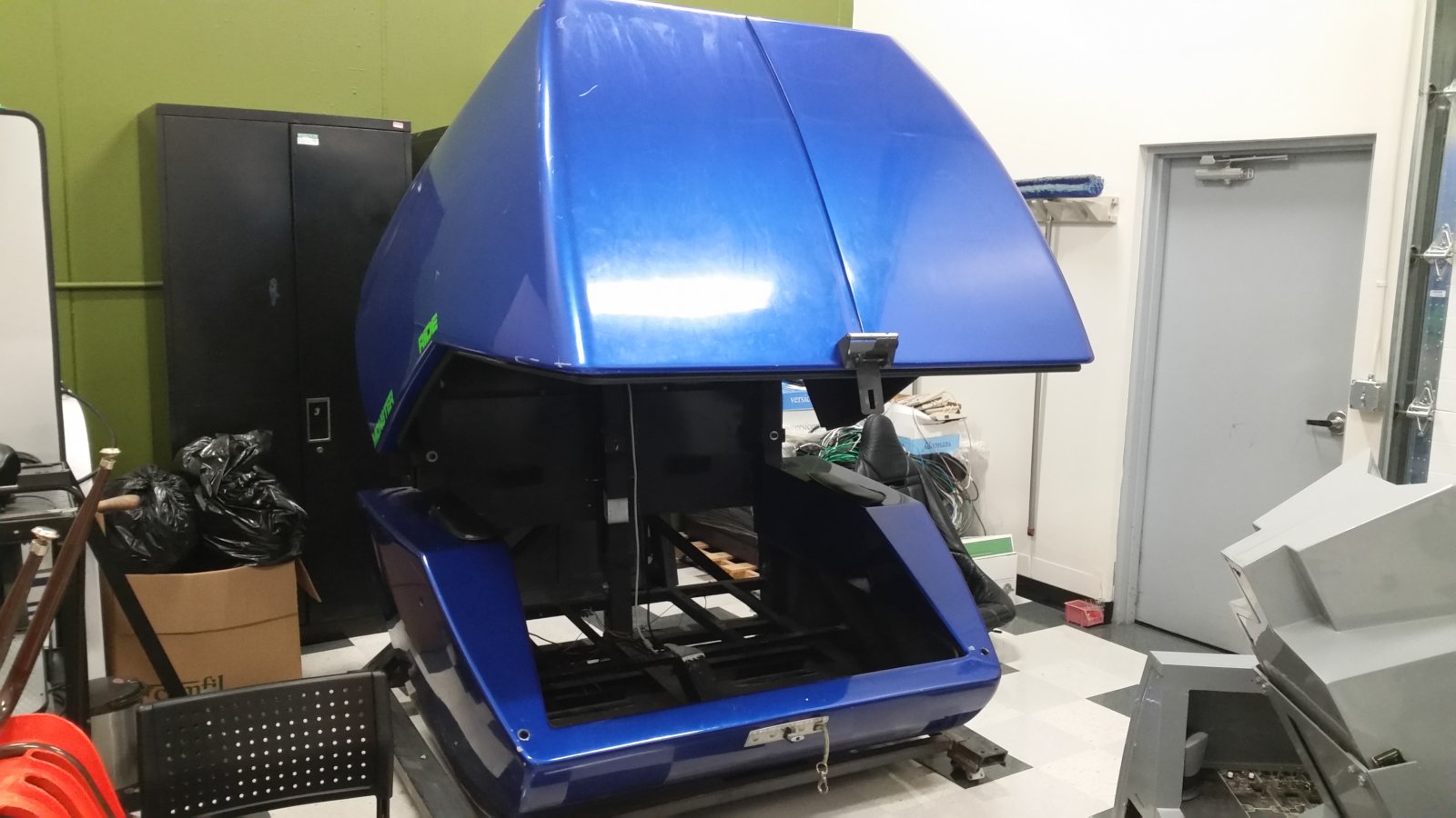

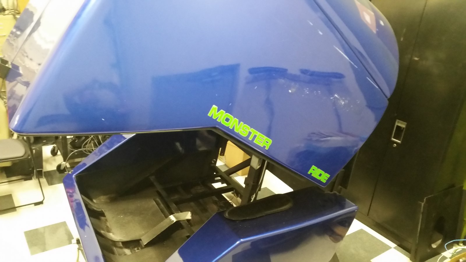

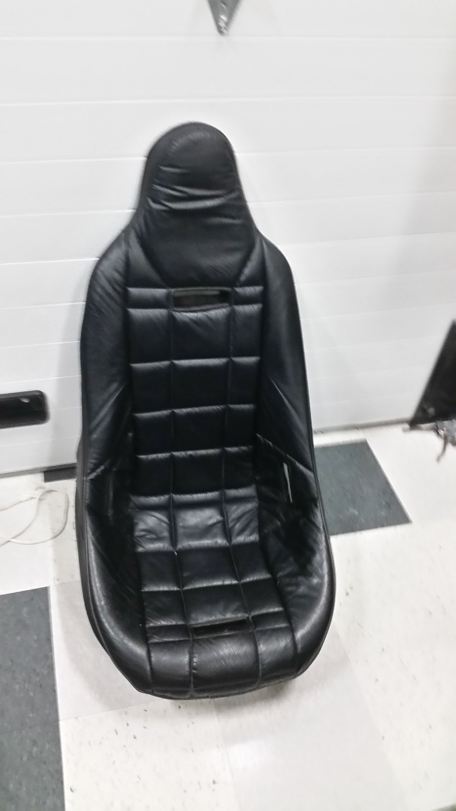

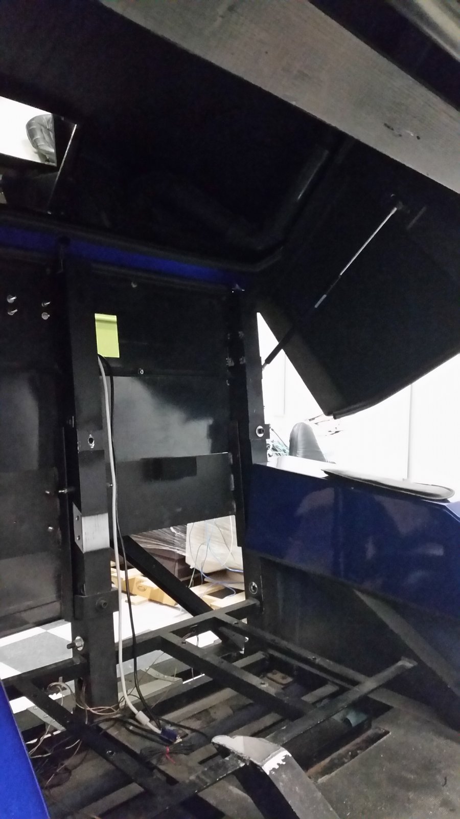

    Here are pictures of the cabinet that we are starting with. This was an old monster truck simulator. It had a long rectangle behind it and the front piece, shown here would be able to move. We did not get the computer or anything else with it
    Here is what we are working with. The cabinet is great but very heavy. I am very excited to share and to hopefully complete it by December. Any coin donation is welcome as we progress. The next post will show our parts list.
