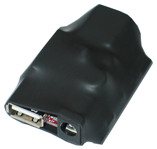

    I have ordered this one...

    Good choice, easy to use and nothing to solder :D USB-Galvanic-Isolator...

    And it works... problem solved
