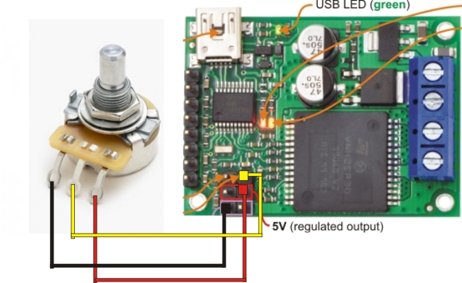

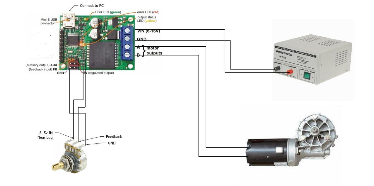

    :hi: hello friends, today I want to connect the potentiometer on the card pololu 12v12, I'm not sure how it's done :? , I put a graphic aui and I wonder if I'm right, thank you!

    You are right sir!
  8. bsft
    either way will work here. I've done both, both work.

    thank you very much for the info, I could connect the cables! :clap:
