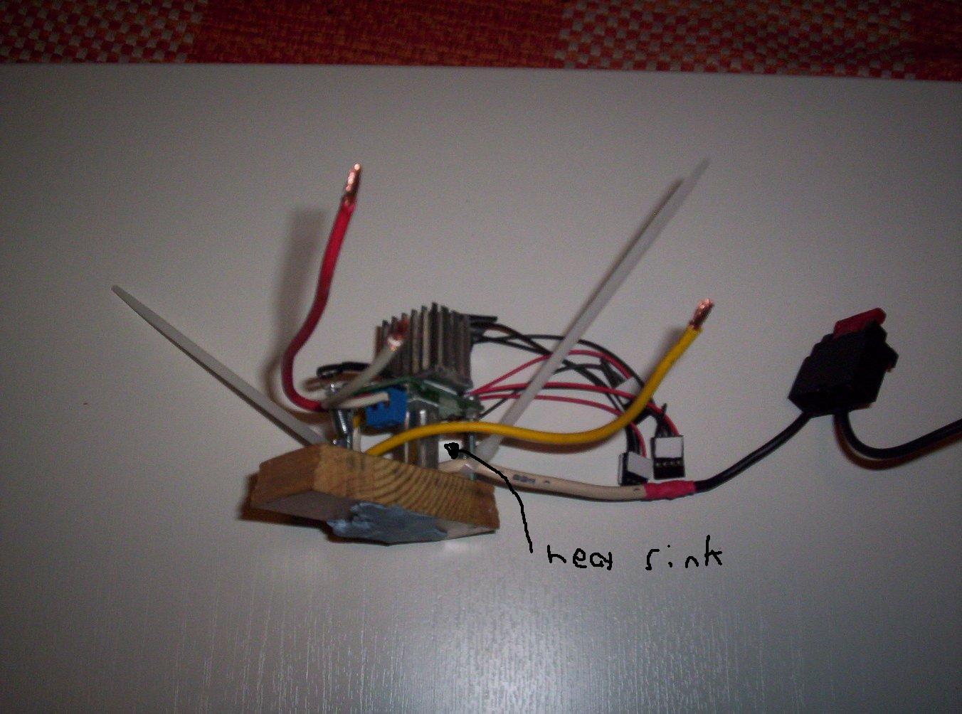

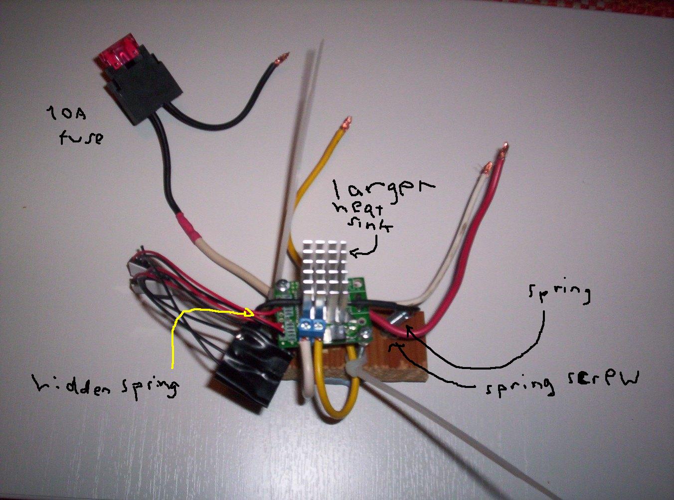

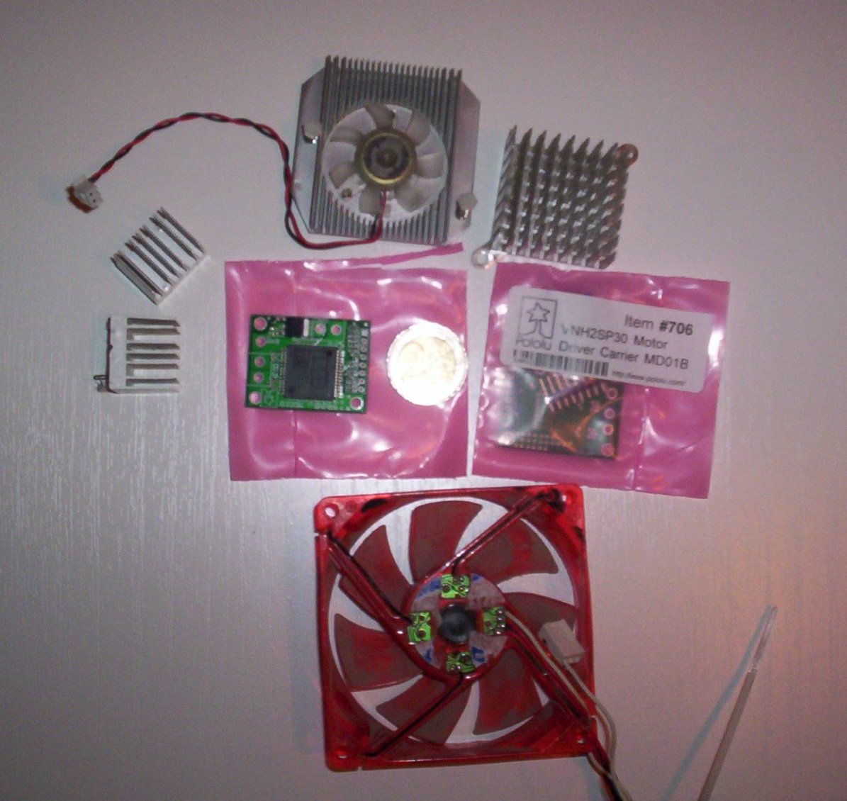

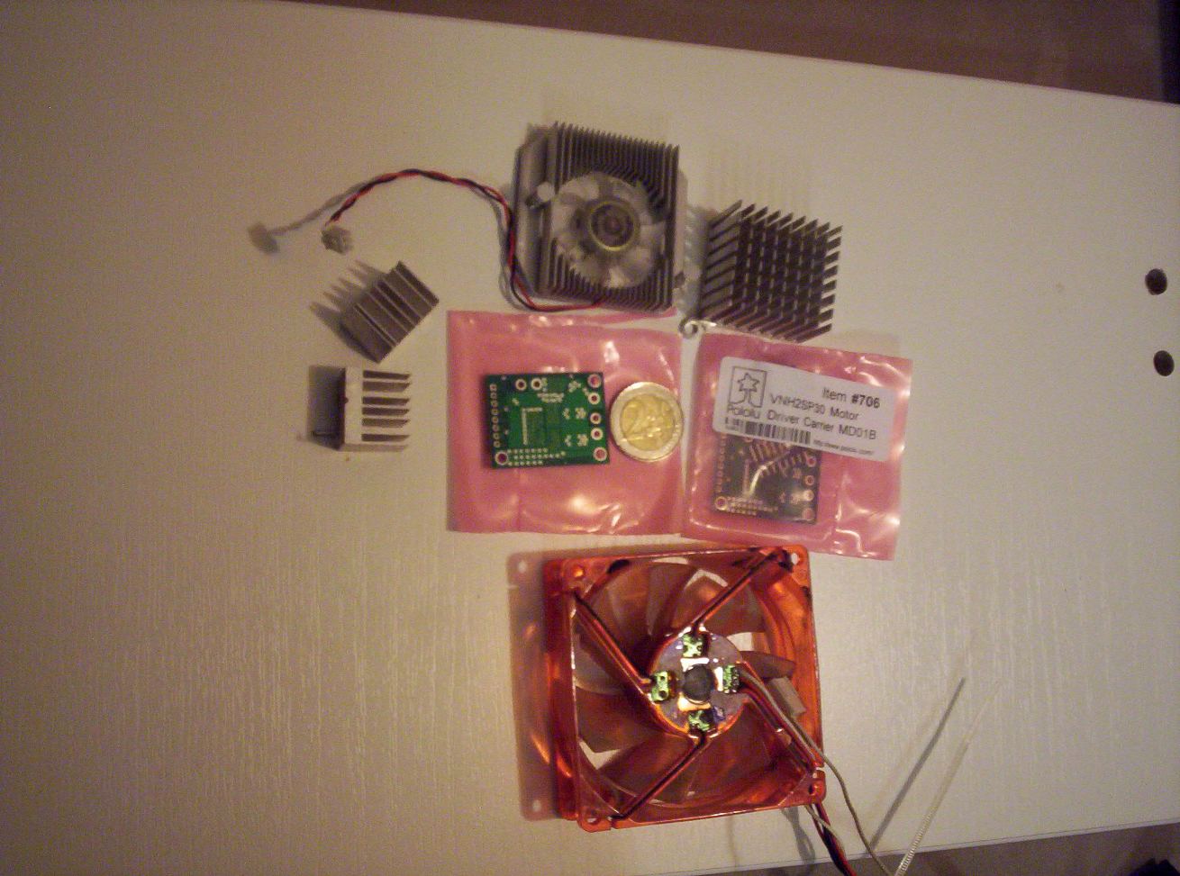

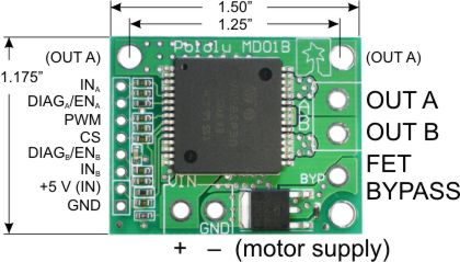

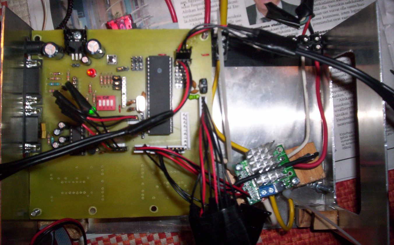

    After DIY electronic PCBs, Pololu boards are just incredibly small. In picture 1/2 you can see the boards, cooling accessories and comparison with 2 euro coin. Heat sinks are ordinary computer coolers picked from an old broken PC. Pictures are very fuzzy, but I believe you’ll get the point.

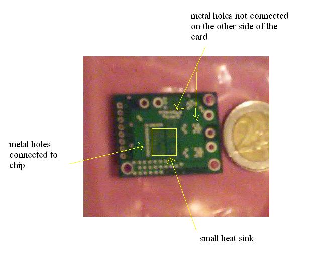

    Underneath the Pololu card, there are lots of elecrical connections, some of them are directly in contact with the chip. On sides of the board, there are connections to AMC, motors and power supply. For this reason I decided to put a larger heat sink on top of the chip and a small one under the board. This way it doesn’t touch any conductive area. Small springs press the upper sink against the chip.
    Here is the way I connected Pololu (motor1) with AMC:

    In addition to above, VNH2SP30 has also DiagA/ENa and DIAGB/ENb pins. I didn’t connect them with AMC. Should they be connected, I honestly don’t know. Data sheet explains them this way:
    Open drain bidirectional logic pins.These pins must be connected to an external pull up resistor. When externally pulled low, they disable half-bridge A or B. In case of fault detection (thermal shutdown of a High-Side FET or excessive ON state voltage drop across a Low-Side FET), these pins are pulled low by the device (see truth table in fault condition).
    So is their task to shut down Pololu card in case of fault but doesn’t have any other purpose?

    So everything was hooked up and it was time to test. I did the test without connecting AMC to computer. When I connected 12V battery to motor driver, motor started to spin like expected. Position feedback pot’s position was about 1000 on the AMC lcd. When I decreased position pot to about 600, motor stopped spinning. In the halfway, ~^450-550, motor made electrical noise, but didn’t spin at all. Now when pot value was increased or decreased motor didn’t start to spin in either direction. I disconnected battery and motor driver was cool and 10A fuse still unbroken.
    In second test I put position pot value to zero and connected battery, motor started to spin in other direction than before as expected. Behaviour was still the same: near value of 400 motor stopped spinning and didn’t start to spin again. After this I checked connections to AMC with multimeter and added some solder to Pololu connections just to be sure.
    Again time to run tests: no difference noted, but I decided to try fast changes of direction with pot. In this way, motor changed its spinning direction, but if pot was turned too slow, motor stopped. I also realized that if I waited a few seconds when pot value was zero, motor started to spin without disconnecting the battery. That didn’t apply in the other end (1024), waiting didn’t put the motor to spin.

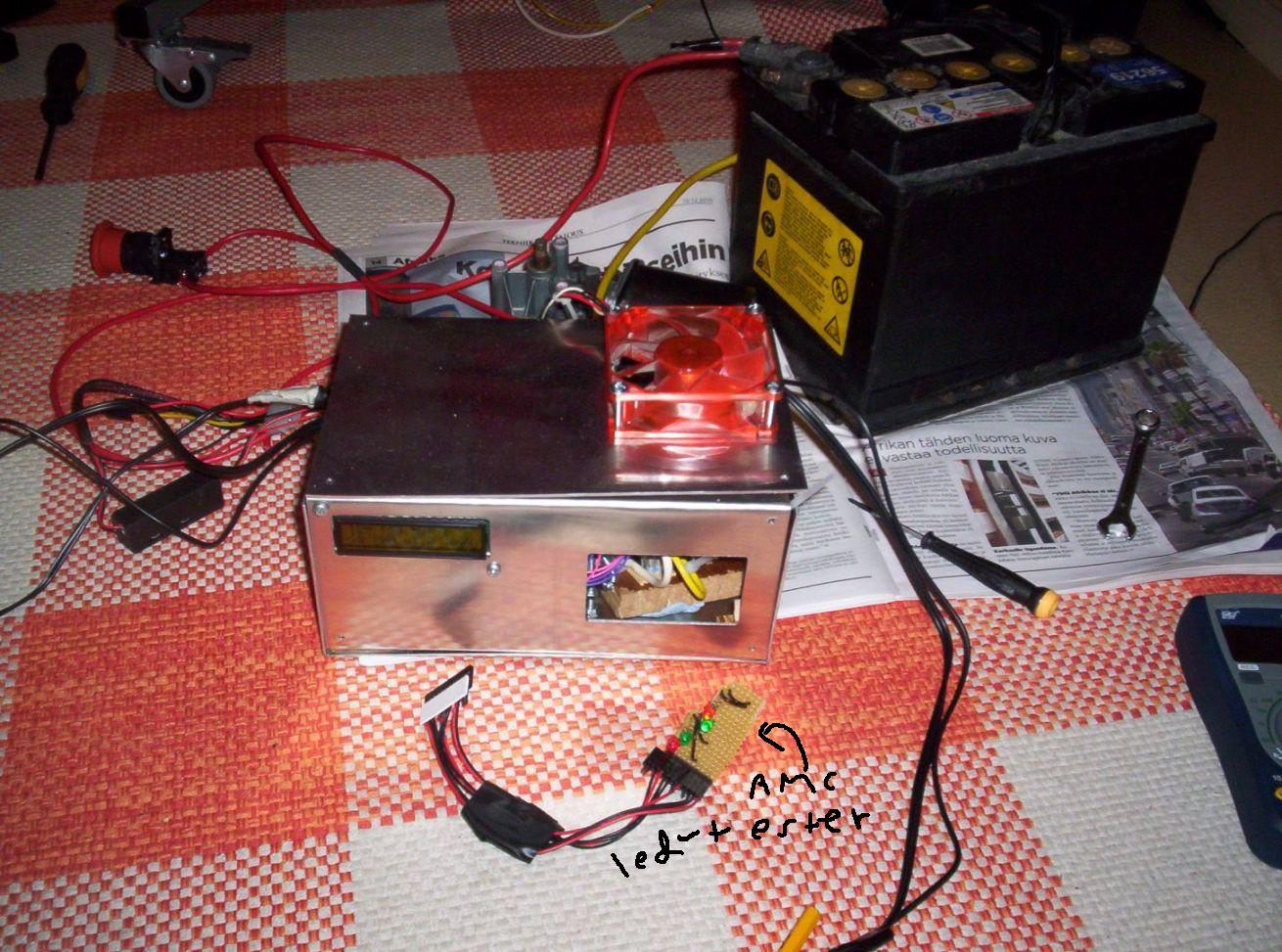

    I believe the fault isn’t in AMC, as I have tested it with DShmb with success. After some tests few weeks ago eventually I ended up having broken mosfets (IRFZ44N) which I replaced with IRL540N. Anyway, that’s another story but proves that AMC has worked before. Altough only motor 1 worked and motor2 didn’t. I made a led tester assembly to test was the problem in AMC or DShmb, and led tester worked well for both motor outputs. Led tester was introduced by Thanos and is discussed in AMC topic: tronic-s-amc-motor-motion-controller-with-pwm-servo-output-t559-630.html
    I use AMC with 18kHz crystal, so that shouldn’t cause any problem. Any suggestions what might be wrong?

    You should put the larger heatsink on the back of the board and smaller on top of the chip. Back of the board makes much better contact.

    Thanks Frakk for guiding me in the right direction! However, after reading datasheet again, I just don't have any idea what that means. Let's assume I don't use this fault function, where should I place a resistor? Does it mean that when they are pulled low, resistor value should be low? And in normal operation a high resistor? Needless to say that I belong to that majority who knows very little/nothing about electronics. :no:
    Underneath the card, there were connections to chip's mounting legs. That's why I placed a smaller one underside. In picture there can be seen these connections. You mentioned earlier about that it should be covered with solder mask, but this mask doesn't cover the connections. Or is it possible to put an extra layer of mask to cover the connections?
