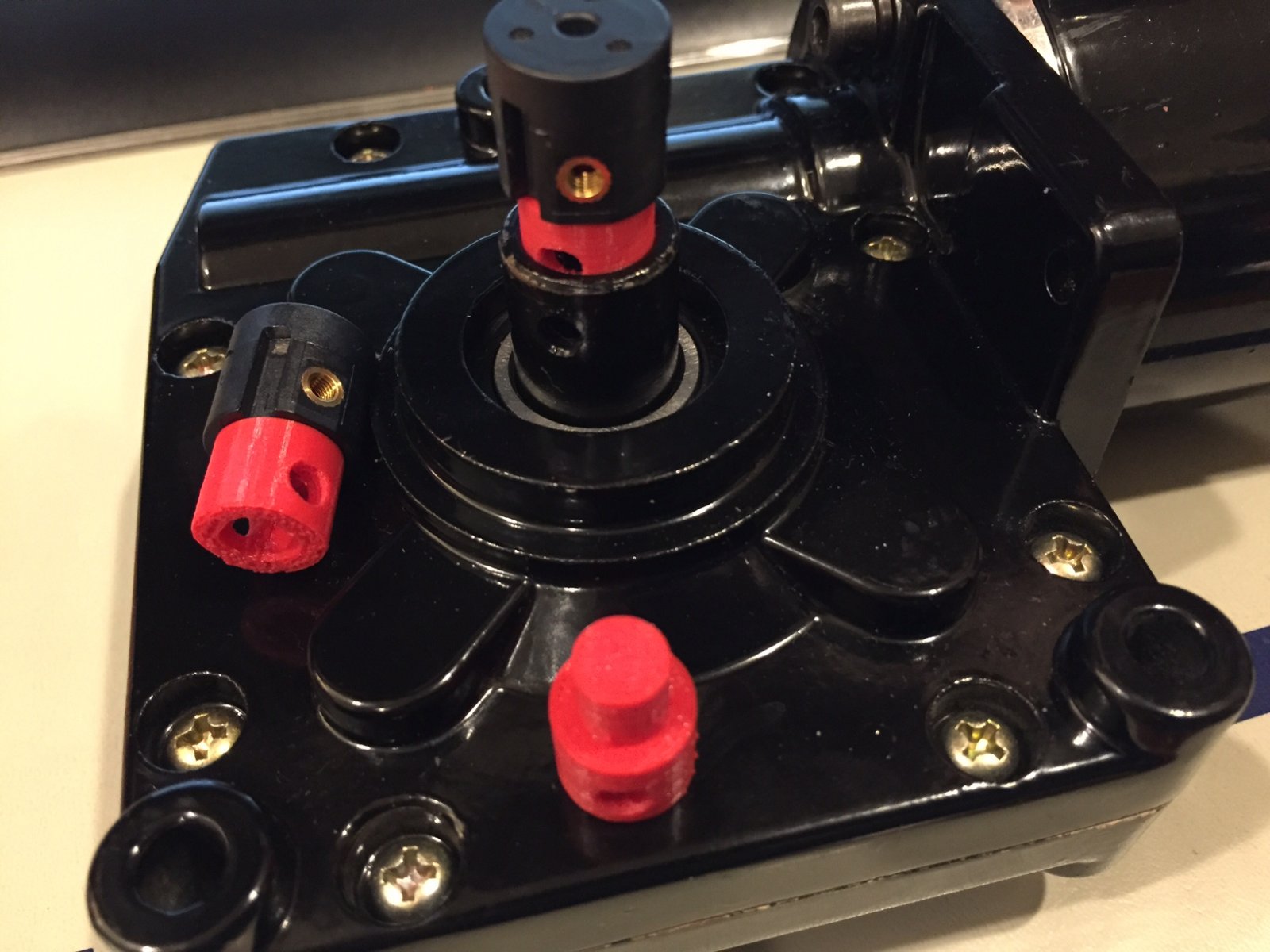

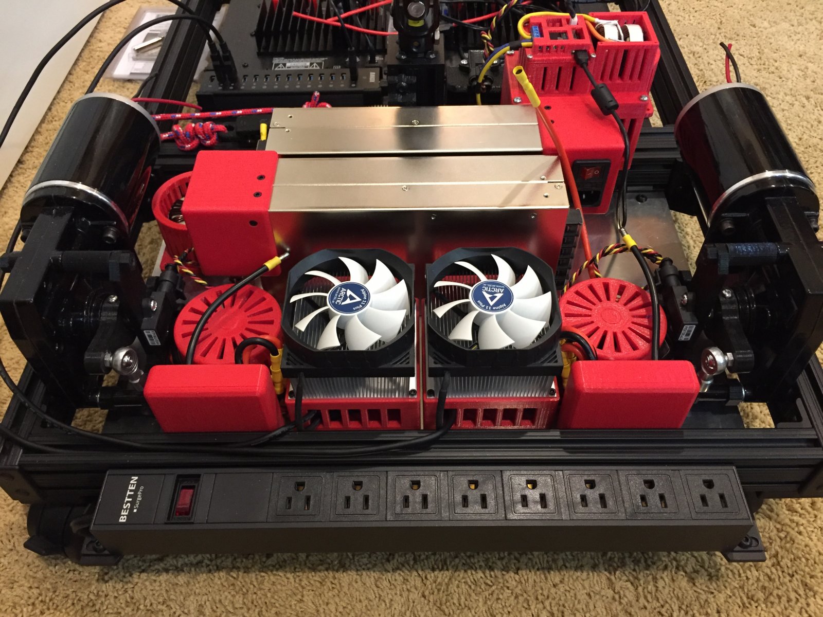

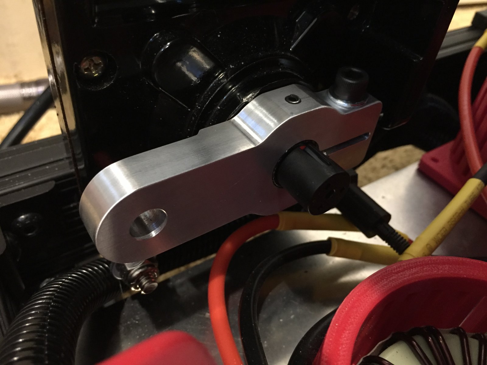

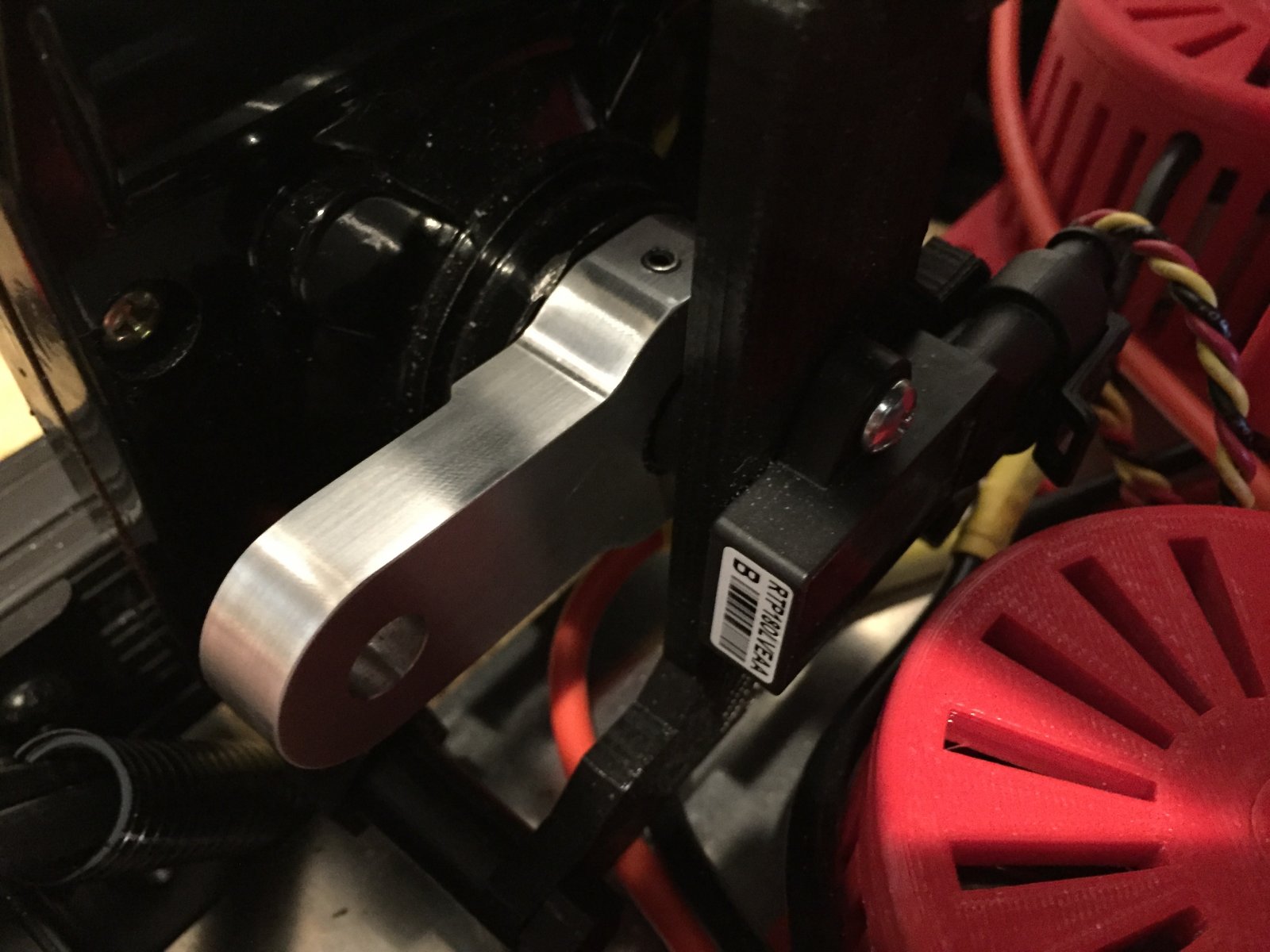

    These are a bit hard to make things out since I printed the plastic in black and it doesn’t photograph well, but it should get you the idea. The black thing in the center of the output shaft is the magnet. It has a couple of setscrews that lock it in place on a little adapter I printed that fits snug inside the hollow output shaft.
    In the second photo you can see the end of the 1/4" mounting stud on the lower left and the printed plastic adapter on the lower right mounting. In the third photo the sensor mounting plate and sensor is mounted up.
    That’s how I did it but there are as many ways as people. And again, shafted sensors work great too.

    @Zed Amazing info and description - and thank you for the pics. The whole, "No friction, binding, or flexible couplings, maintenance" is definitely enticing at around an only $20 increase cost per motor. I'll have to stew on this over the weekend and read around some more, as I see some forum matches for "RTP180LVEAA."
    Did you design the printed parts yourself?

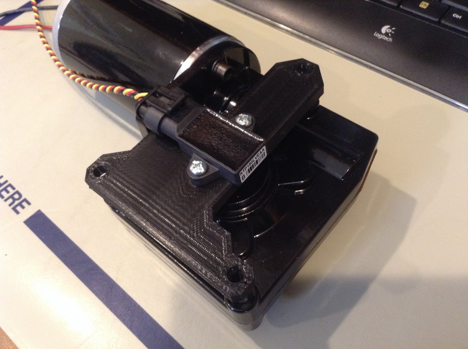

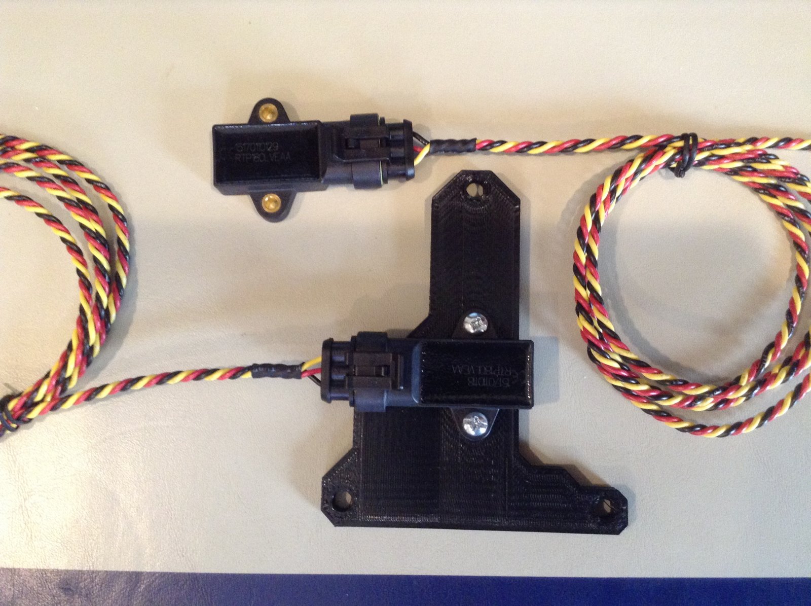

    I did. I was going to post it all when I put up my build thread but I’m happy to post the stl files now if you want to print.
    The mounting plates have internal pockets to set nuts into during printing. The standoffs are internally threaded 1/4-20 since that was the stud size I used to mount my motors. I also have a long standoff for the top because at first I didn’t have a bolt on that one but was getting some flex so added a plate and a bolt. But you either print three of the short standoff’s and three nuts or two shorts and a long and 4 nuts. Or just use regular bolts and nuts. The plates are the critical part and the application note shows the proper gap which the standoff’s get you with a thin washer in there.
    One thing about the standoff’s is you want to chase the threads with taps and dies to keep stresses low. In all the disassembly/reassembly steps I’ve had to print extras since the threads would sometimes break.
    But there are also mating connectors required ($1.50 each plus you need the contacts). Those connectors are latching and make disassembly and reassembly trivial. So these do take more work but to me it was worth it. They make for a very neat installation but you need to be comfortable with tiny crimp connectors or willing to just solder to the sensor pins.
    If you do a search at DigiKey, there are also sensors from Littlefuse that look good and are also non contact. They are cheaper, have wire leads, and would need a different mounting. I haven’t used them to say for certain that they are interchangeable, so make sure they are appropriate. I think they are something like $12-15 so not as big a deal if there are issues. They are cheaper but you would need to engineer proper mounting to get the proper alignment. Even without a bearing, alignment is important or it can make the response go a bit non-linear. A motion platform is probably pretty forgiving though.

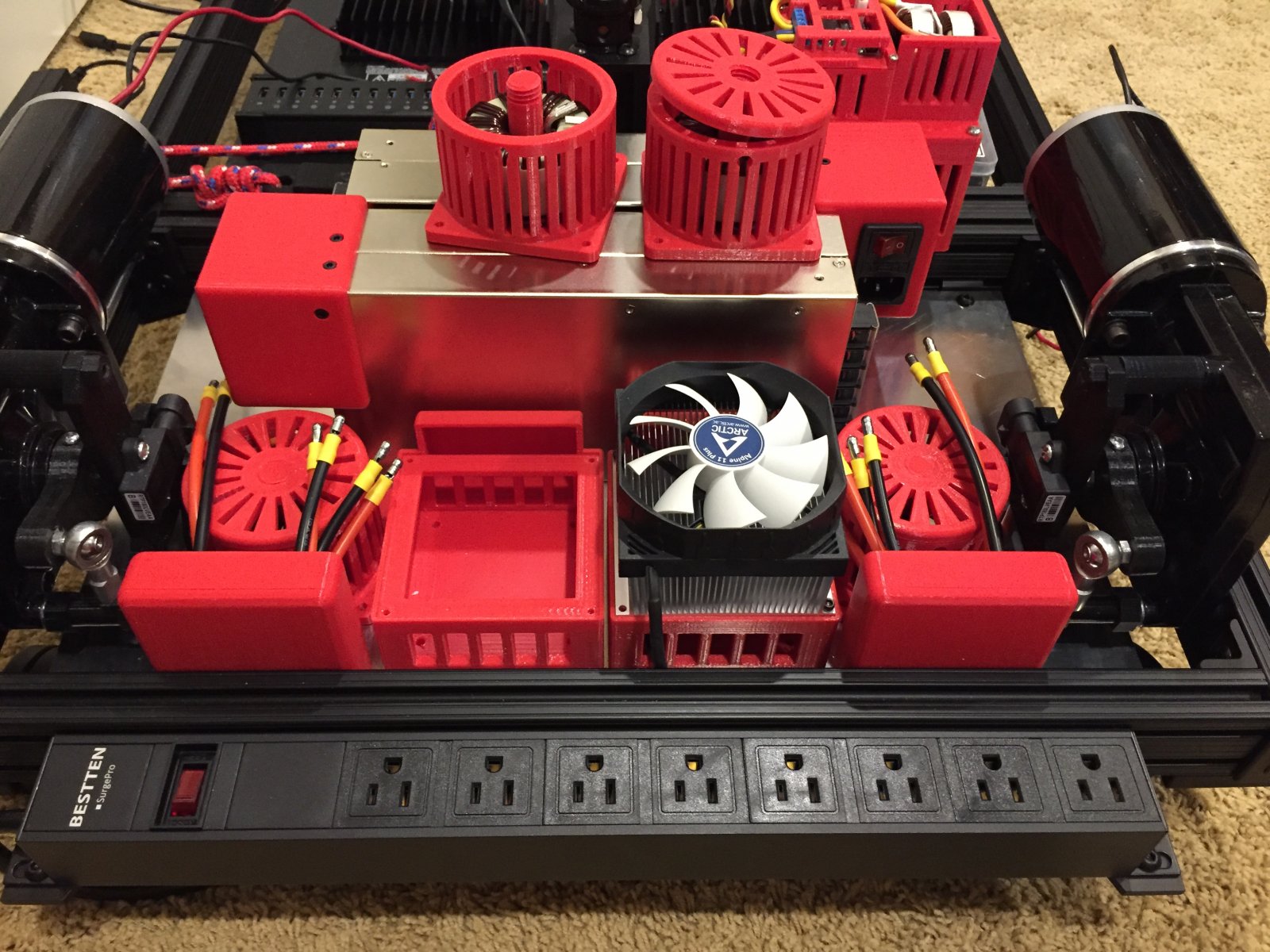

    The wiring for the Hall sensors doesn’t need to be heavy gauge. It’s just milliamperes on those wires. You only need enough gauge really for strength and durability. You should twist the wires, though. It helps to minimize noise pickup.
    This picture shows the twist but also shows a bit bulkier, older, mounting plate than the .stl files I posted. The new plate is clearanced to give more room for the system to sag and still not have output arm fittings hit the plate - at least on my system.
    On those big terminal blocks for the JRK, they are a good idea if you aren’t just going to solder to the board. You do want the ability to disconnect, though. I used bullet connectors on pigtails I soldered directly to the boards.
    These don’t show the actual connections on the JRKs, but you see the bullet connectors. I forgot to take photos of the JRK connections. They are upside down in the square red housings with the heat sink/fans. You need to be a little careful with the screw terminals because if you overtighten them, you can strip them - what I did but with the stock ones - and had to take them back off the boards. The larger ones should be harder to strip but that’s why I went to soldering direct and using the bullets.
    F81F164B-16C0-4861-A50C-07FAC7291F23.jpeg F2200628-03F2-45A3-931E-2BC0584455BD.jpeg
    But if you are going with screw terminals on the JRKs, I’m definitely with @noorbeast. It sounds like you are considering just using thinner wire gauge overall but something to keep in mind is there are voltage drops. You can look up typical wire resistances by gauge online per unit length. Get the length of your runs and that gives you the wire resistance. Voltage drop is just i x R so is proportional to the amount of current you are pulling and 30 or more amps is quite a bit. Lost voltage is lost current and torque and turns to heating in the wires. The pgsaw motors have fairly small gauge wire leads. I cut mine back to just a couple of inches and put bullet connectors on them. The rest of my wiring is all 10 AWG to minimize resistance losses but I also have other stuff in the circuit so wanted to minimize losses.
    Can’t tell you how necessary the heavy gauge is. It depends on how long your runs are. https://www.cirris.com/learning-center/calculators/133-wire-resistance-calculator-table At 4 feet (remember it’s total length both ways), the resistance of 14 AWG is 0.01 ohms. At 30 amps that’s 1/3 of a volt lost and turns 12 volts into 11.7. It’s not huge but if your wire runs are longer, it can get significant. And all other resistances in the loop count too - connectors, circuit boards, motor leads, etc. Just something to be aware of. 12 gauge should be fine for reasonable runs. Maybe even 14 for short runs.
    Last photo shows the Hall wiring. Black is ground, red is +5, yellow is feedback/signal.
