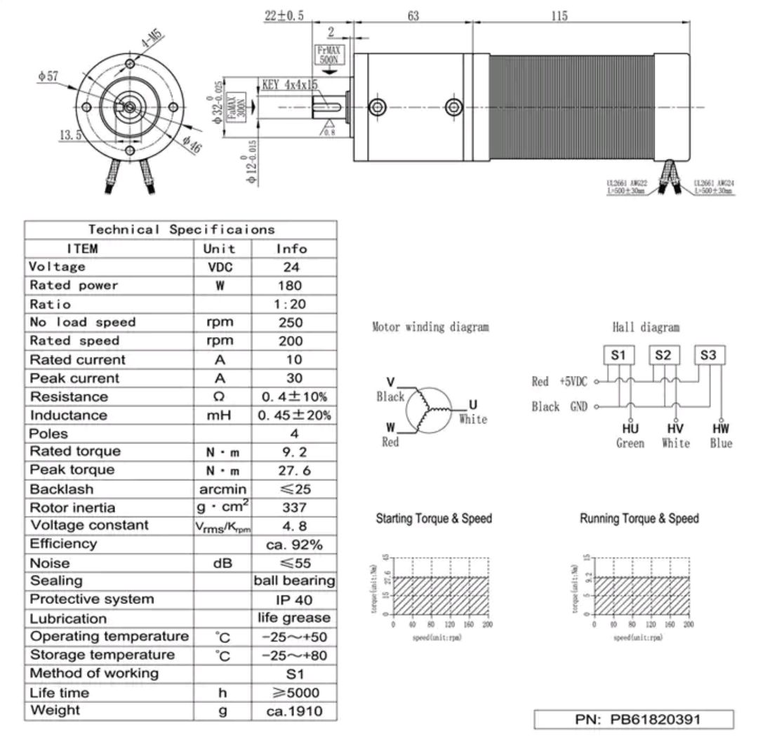

    I've decided to go for BLDC motor, do you think it is possible? (Specsheet screenshot included)
