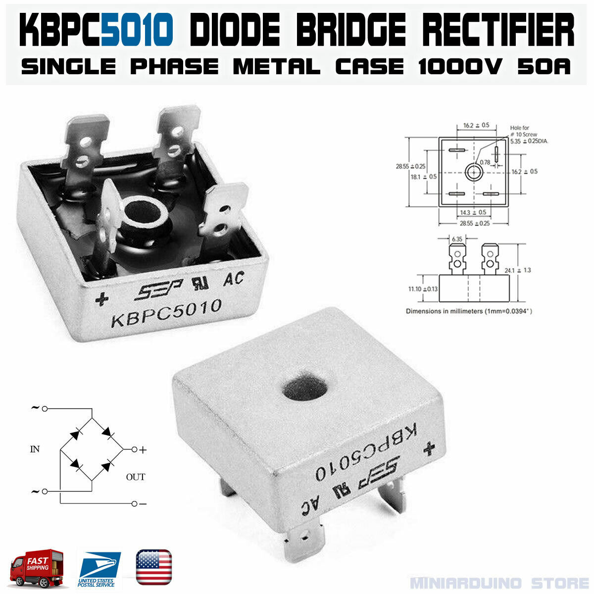

    For more safety and better heat dissipation capacity I think I'll use 6 of the KBPC5010 Rectifiers, having one before each driver, so the back current from the motor on one driver won't be able to get to other drivers. Hoefully if any occurs it will be converted to heat by the rectifier. Here's an updated schematics:
    (I'm also cross-posting it to my main thread to keep it current)
    Should I test with 2 batteries before the rectifiers are connected? I guess there wouldn't be any reverse current on the battery if the rectifiers are present.

    The rectifiers are like check valves. The let the current through in one direction and completely block it in the other. This prevents damage to the suppy and to other drivers. But it doesn't dissipate the energy. If the diodes get hot then it's due to switching losses from the high frequency of the PWM.
    For the test with the car batteries you don't need diodes. They would in fact stop the test from working at all. The battery can take reverse current.
    The shunt regulators are the ultimate cure. But you'd need 6 of them as a single one can only handle ~10A peak and 15W continous. But I think car batteries are less expensive than 6 shunt regulators. Used ones are OK. They don't need to supply current for an engine cold start. But they must not be damaged. Connect one of your motors. If it runs and the voltage stays above 12.0V then it's ok.

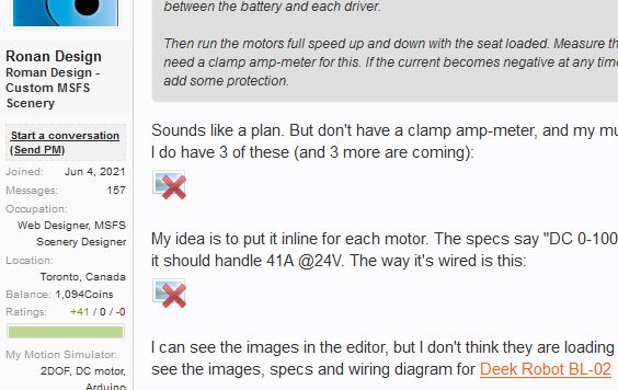

    BTW, I don't see most of your pictures. The schematic is visible but the other pictures are only displayed as "X". How did you upload them? I drag pictures over the message editor and then select "insert thumbnail".

    BTW not sure why those images didn't load, I did the same as I always do. But the link has the details.

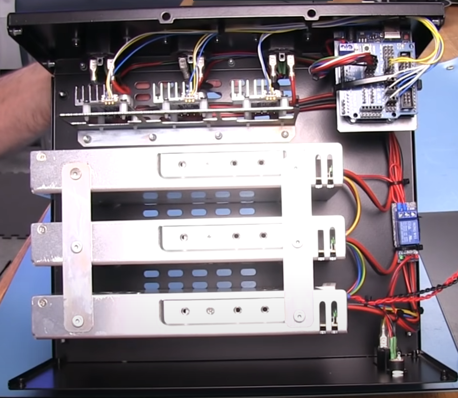

    In DOFReality H6 review the internals of the control box is shown. There are 2 identical boxes. each has 3 24V PSUs, Arduino with a dev shield and 3 of the same MD13S drivers I'm using (that's where I got the idea from), with added heatsinks. Note that beside the relay for the emergency stop button there is nothing else there. The top 3 things are the backs of the AC plugs. So they use no capacitors, no rectifiers, no battery and it's a commercially sold and popular motion system. They do have different motors than I'll be using, so there's that. But they are not less powerful, most likely more.

    OMG! What a complicated piece of gear! Prop shafts with U-joints and ball screws to convert rotational motion to linear and then back to rotational and with the lever arm back to linear, again! I wonder how they can make this for an affordable price.o_O:confused:Why not a toothwheel gear and drive the arms directly?
    Maybe their overcomplicated mechanics has enough friction so regenerative energy is not a problem. Maybe I'm just overly cautious and all this is not necessary.

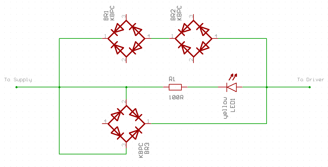

    Ok, I have an idea how to test if protection and/or batteries are really necessary. No need to buy expensive stuff just to find out that we eventually don't need it...
    All you need is the rectifiers you already have, two car or marine batteries and an LED and a resistor.
    The purpose of this circuit is to generate a small voltage difference (4 diodes in series = ~2.4V) when current flows back to the supply (batteries). The LED indicates if/when this happens. The third bridge rectifier BR3 allows current to flow in the normal direction (battery to driver). Use a bright red or yellow LED. green or white LEDs need to much voltage.
    So the test goes like this: Connect 5 Motor drivers directly to the batteries (with a fuse if you want). Connect the 6th to the batteries with the circuit shown above. Run all motors simultanously with max speed up and down. If you see the LED flashing then there is reverse current. If not we don't need to worry.

    What a great idea! I'll definitely do that. I have 2 relatively new marine batteries - they are good for sure. Just started the outboard yesterday to drain all gas from the carb before storing it. Is there a reason to connect all motors? The rig is not ready yet, so I can connect a single motor with no load on it. Or I can add a short arm to it and attach some weight to it to create inertia when changing direction. I can just connect a single motor and driver with your circuit and feed it the square wave in SMC3Tools. There won't be a heavy load on the motor, but I guess it still would generate reverse current when reversing direction, if it's prone to that.
    Not entirely sure about KBPC connections: KBPC has 4 pins marked + - ~ ~ so the pair is for AC current and a -+ pair. Recommended connection for protecting the PSU is to both ~ from PCU and then + to the driver. From the image below I assume that top 2 rectifiers are connected PSU + to BR1 + , BR1 - to BR2 + , BR2- to driver +. And PSU + to BR3 both ~ inputs, then BR3+ to LED and BR2-. Am I correct?
    Or, in simpler words, in your diagram on rectifiers 1 = +, 2 = ~, 3 = ~, 4 = -, correct?

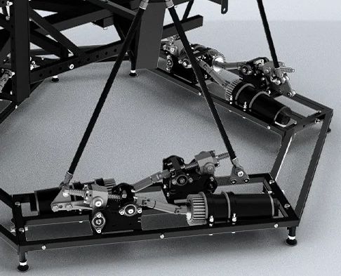

    The original model used a geared motor, but suffered from backlash. This was mitigated somewhat by the use of gas struts and dampeners which were added later as part of a redesign. The current design is meant to be more stable still though I haven't any experience with it personally. I thought it was quite a clever little design to get the benefits of a ball joint for precision but without needing a long actuator, but I don't know how effective it is in reality.
    I do enjoy the innovation of new designs and ideas. I love this one in particular, though it looks very complicated to control:

    Ah, interesting. Without gas springs backlash should not be a problem as the weight usually bias loads the gear so it's always on the positive force side of the backlash. Only in extreme situations (crashes, loopings) you have negative g forces and then you don't care much about a little bit of backlash.
    But with the gas springs the forces of the actuators chang direction quite regularly so backlash becomes an issue. Maybe the gas springs should be adjusted to not support all of the weight but only half to three quarters. This way the gear is kept biased a bit in most cases.
    Yes, looks interesting. What are the benefits? Bigger range with shorter struts and unlimited yaw? But the drawback is the motors mounted below the curved racks take a lot of space, vertically. The curved rails and teeth racks also look expensive. And you also need low-backlash gears.

    There are videos on YouTube about DOFReality H6 having not only backlash but large shuddering during slow movements. Struts were helping with that as well. I guess that's why they changed the design to that complicated arrangement. I'll see if my rig would have similar problems or not... I got 2 struts 120lb rating each. That means they should hold 109kg which is definitely less than me (80kg) + top platform weight with seat and stuff (?) but not by that much (20-30kg I'd guess). I'm a bit worried that they are too stiff. I can even compress them by hand at all. But we'll see...
