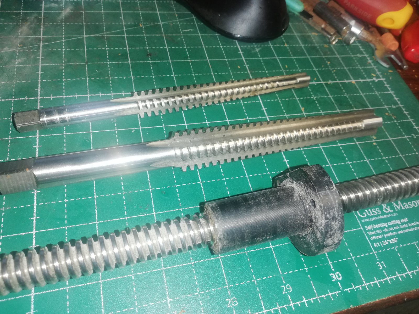

    this topic brings me a new idee /option ? i got made/ in the past , cnc machines with 1605/2004 trapezium tread bal nut . did make the balnuts out of pom c material . they did hold up good , got the tool for making nuts still here , i believe also got the 20mm tool for it . must look into it , i,m also looking into making accurator system , and maybe i wil give this a try . trapezium tread 1605 pro mtr is verry cheap , about 15 euro 1 mtr. got lots of it here .

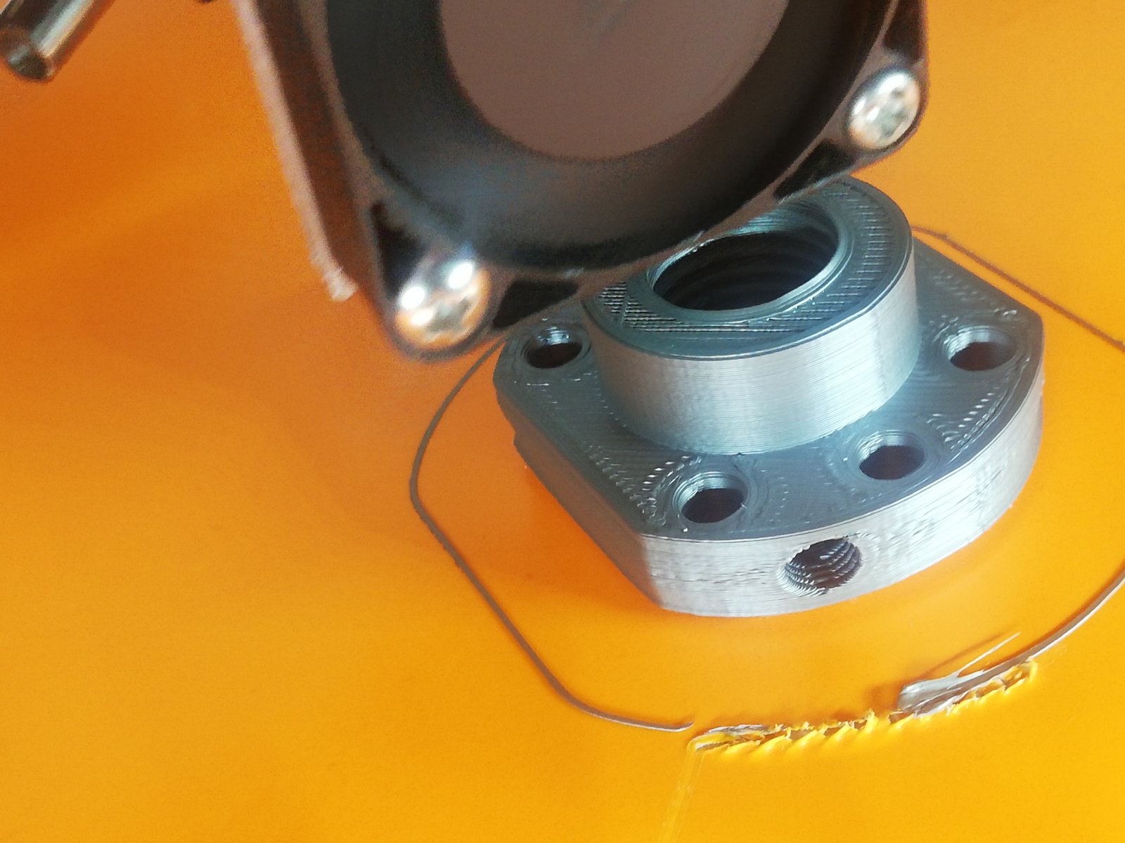

    im printing it in alu . not just the color but 20% real alu , i use this alot , verry strong , behavior is much differend then pla/abs/petg/nylon . ...whe wil see what the result is , i let you know .

    Are you sure it's a good idea to print the snail with a filament containing aluminum? The main characteristic of the snail is that of being as smooth and silent as possible. For this reason, from my point of view, the suitable material must be self-lubricating, for example nylon or pom. Any material can be suitable for the test, even if not resistant but certainly not an abrasive material or one that creates friction Tonight I tried to print the snail with nylon (Esun epa-natural) simply by converting the file you linked but without modifying it by adding tolerances or anything else. Unfortunately the thread seems too tight and doesn't even screw in, I have to work on the file to give it the right tolerance

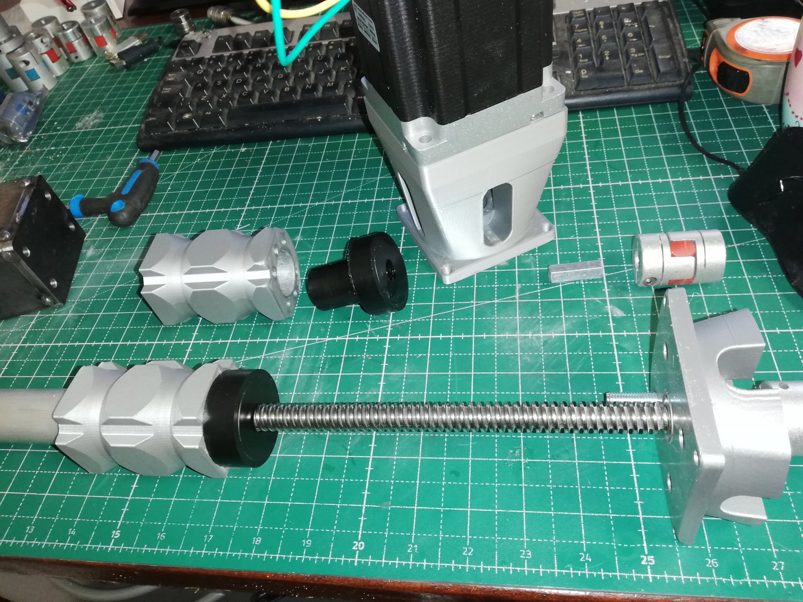

    yes , i also had a tight fit , the alu printing is just for testing.. in first place i make a sfx-100 with the trapezium and pom c nut . in the past getting good results with it for driving cnc machines with it . i got 5 axis cnc machine here ad home with toolchanger , so i wil making al the parts from pom-c . with alu 80x80 construction .

    did print and assembled some parts , waiting for the alu profiels .. 1605 trapezium, pom-c ballnuts IMG_20240206_105333.jpg IMG_20240206_110725.jpg

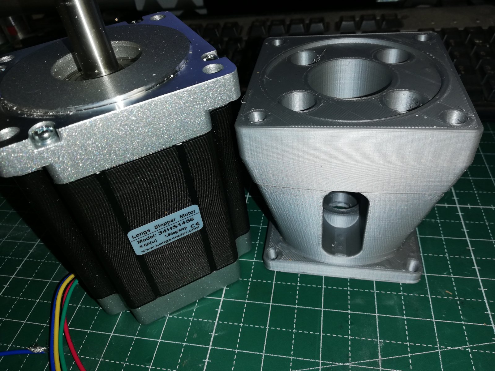

    I recently built SFX100 actuators but using a 80×80 aluminum profile. I had to modify the slider, so instead of using the original metal ballnut and a 3D printed slider, I combined the two in one : a 3D printed slider including a SFU1605 thread, in PLA. It is really solid if you print it with more than 50% infill.

    i did made pom-c ballnut trapezium ..trapezium tread rod is left over from a project , ball nuts i did made home because i got the tool for it ..in the pic above is the test stl fx100 slider . i,m now printing the fx80 slider , got a sketch for arduino 2560 for my steppenmotors , got everything ready to wire up and assemble the actuators and test it . i see no problem with it , because i build cnc machines this way .. trapezium and pom-c nut ..the rig and myself is about 120 kilo total , 4 x 12 nm steppenmotors wil do the job . when actuator is ready and working i will post a movie clip here .. alu profiel i did orderd 300mm lengte ..actuator wil be about 180mm travel . next problem is adding some home position swich onto it . and writhe it in the arduino sketch .
