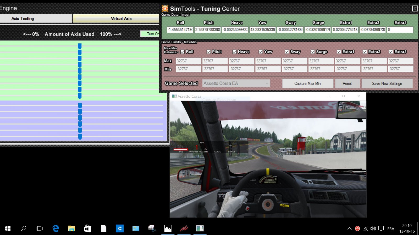

    Hello, here is my problem:
    All worked well until the updated Windows 10 on 4 October.
    The computer rebooted when I threw Simtools and Assetto Corsa!
    I reformatted and reinstalled without any updates Windows 10.
    Installing Simtools V1.3 is OK.
    I have put the plugin for AC 3.0.6.0. in Game Manager and I put 127.0.0.1 IP setting.
    I patched D: \ Steam \ steamapps \ common \ Assetto Corsa
    In Game Engine, I make Axis assigment and interface setting
    I use Output Testing and 4 SCN6 work (DOF and Axis outputs).
    So I run Assetto Corsa 1.8.1 and SCN6 do not move!
    I check in Tuning Center game data verry little move! Only a few units or tenths of units.
    They should move up to + and - 32767?
    In Game Engine Output Testing Virtual Axis very little move not more!
    So SCN6 do not move!
    Anyone has had this problem?
    Thank you in advance for helping me.

    In Tuning Center, when AC plays, I did this:
    1. Press the Capture Max Min button.
    2. Press the Reset button. (Clears the current settings – step not shown)
    3. Drive around the track carefully not to bump walls or hit anything that will skew the results. You should see the new Max/Min values being captured in the Tuning Center window.
    4. Click pause on the game, if you want to alter any of the setting by hand now is the time to do it.
    5. When you are happy with your new settings click the Save New Settings button. And the new Max Min will be applied live while the game is running.
    6. Press Stop Capture if you are finished altering the Max/Min limits.
      Now SCN6 move well! I hope this will help solve your problem too @Willem Pienaar
      Thank you all. Best regards.
