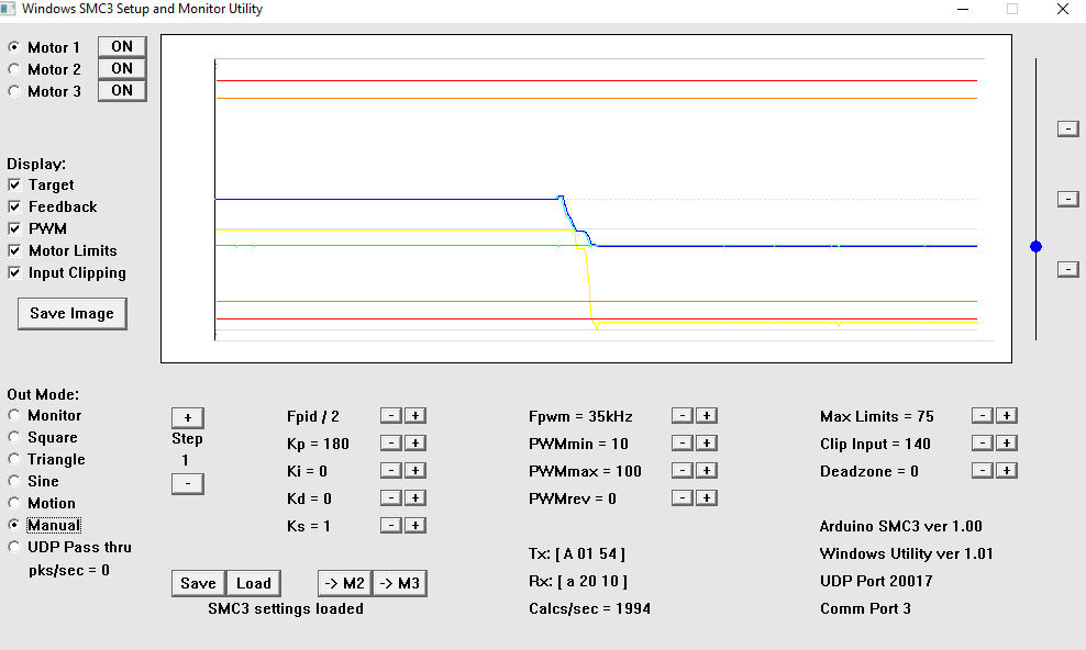

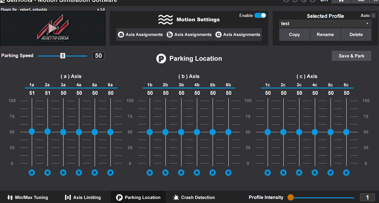

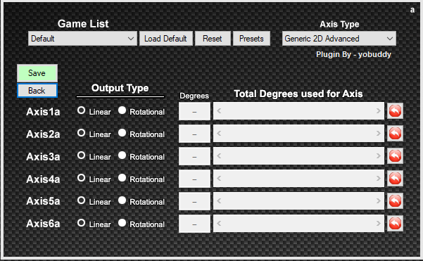

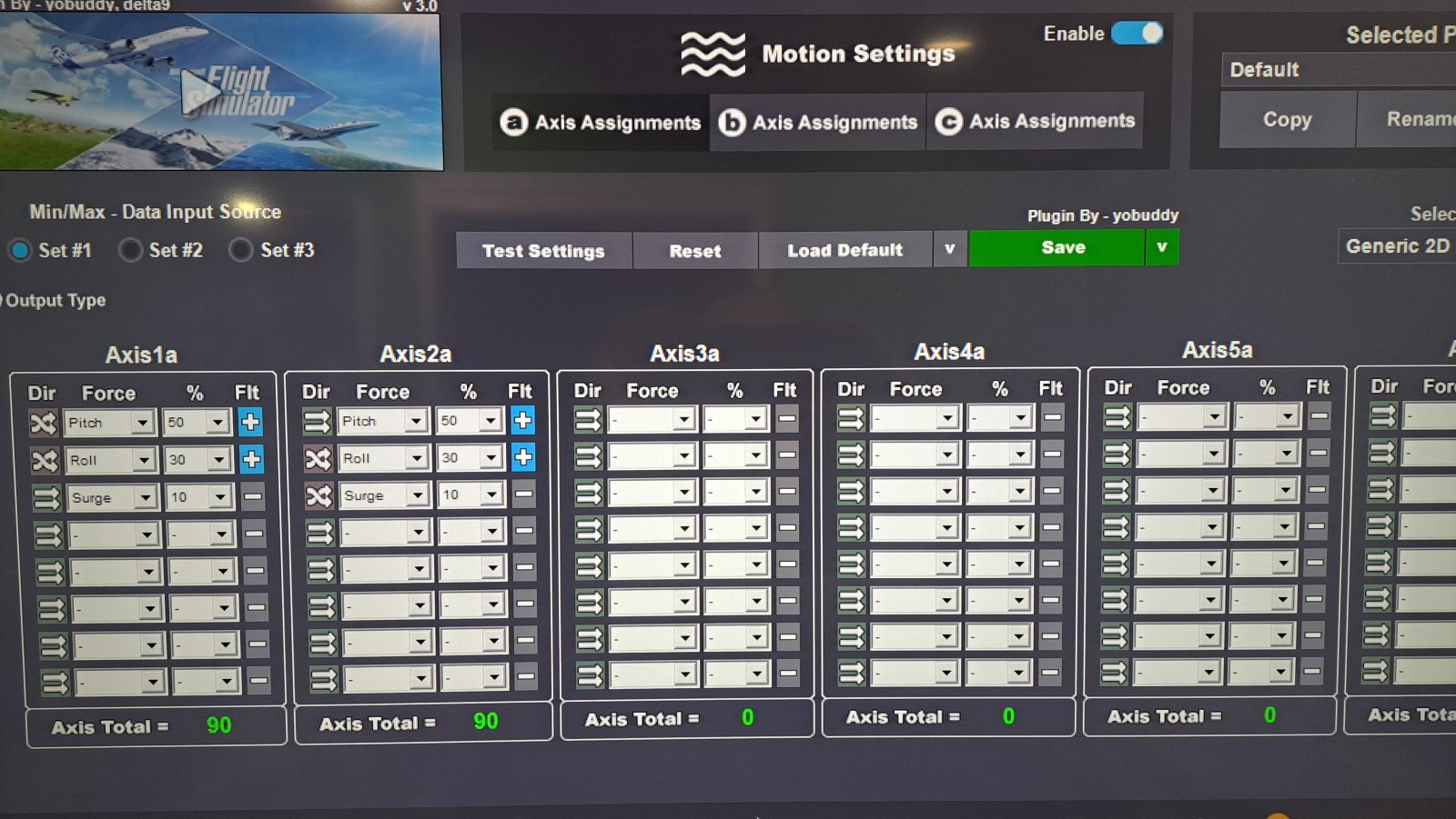

    When I started doing this project, I had this problem, but besides it there were many others that were successfully solved. The problem is that when testing the axes, my position changes by 20 degrees, 104817-fd40e71ca5b3e1f0e5b4e6dec1499ebe.jpg and if I change the position by even 1%, it suddenly becomes centered, which I set using SMC3. photo_2024-03-17_21-36-11.jpg I saw a post from a person who had a similar problem, but changing the system language to English did not help. The settings in simtools are standard; when you change the drive type in the settings from linear to rotary, nothing changes in simtools v3, the same thing. The settings were selected in SMC3, which I think are ideal and the problem needs to be looked for elsewhere.
    Motor Driver: Citron MD20A
    Platform: Arduino Uno
    Position sensor: 10K potentiometers
    (there is an idea that Arduino does not understand what 0 is and it turns out like this)
    I ask you to help me a lot as this is the only thing that stops me from using this simulator.

    Please note that changing to rotary does not change anything

    I just noticed that the Arduino cannot understand what the simtools wants when you try to set the position below the center. The platform begins to throw and swing, but in SMC3 everything is perfect in any position and the movement is as smooth as possible.

    What version of simtools are you using? What is your profile intensity slider set to?

    I used version 2.6.1 and v3 the problem in v3 is repeated. I don't quite understand what you mean by the intensity slider.
  10. Buj818
    Buj818 Member
    Jan 15, 2024
    50
    276Coins
    +11 / 0 / -0
    Motion platform
    On bottom right of my pic, there's half of an orange dot. That's where the slider is. I had mine set at 10 for initial testing and almost got thrown out of the chair. I have it set at 1. 20240317_201253.jpg

    as soon as I initially set the position to 51 it falls into place as in SMC3

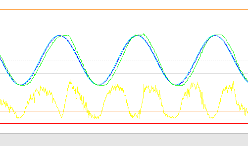

    this is what the curve looks like in SMC3, for me this is an ideal result, but in simtools something is going wrong and I don’t know what Screenshot 2024-03-18 185744.png

    Is that sine curve with you in the seat and under load? I'm not familiar with the motor drivers you're using, so I cannot comment any further on settings. You have mentioned the Arduino several times though, so if it were me in the same situation, id reset/clear all settings, download/reload SMC3.ino, double check the correct mode, and start from scratch. I have done that, and it only takes a few minutes. Couldn't hurt.

    Were you sitting in the seat for testing in SMC3? You haven't made it clear if this happens under load or just an empty chair. That can make a large difference.
  18. Valerii
    Valerii New Member Gold Contributor
    Jan 23, 2024
    25
    74Coins
    when I sit, electricity consumption simply increases (here is a graph with a load of 100 kg)
