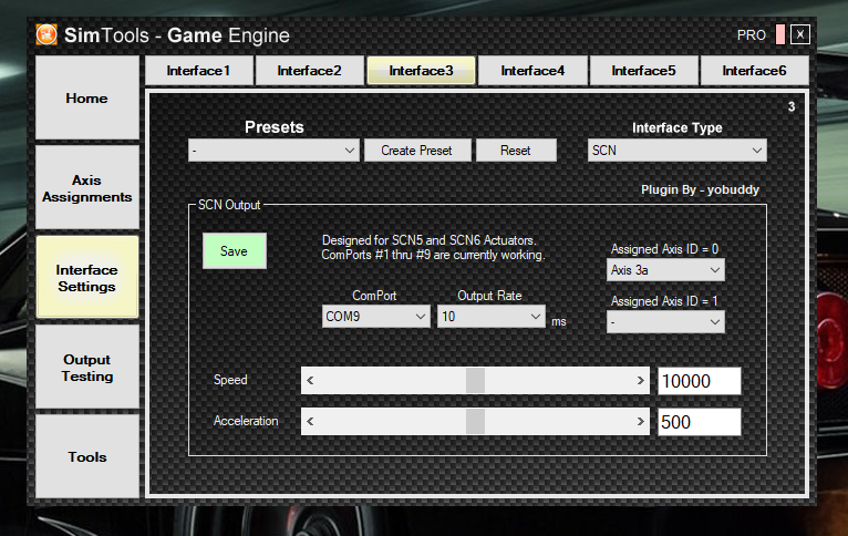

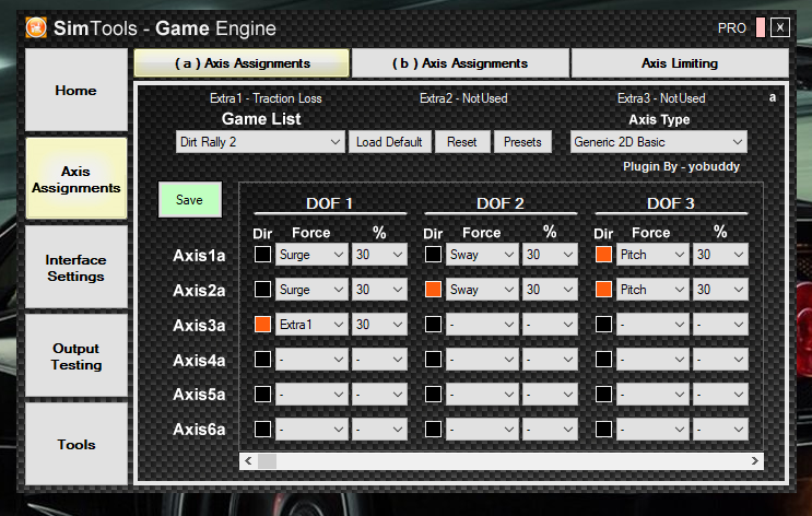

    ben geleit Hi ,iam having a nightmare with left front on primu t1000 3dof,had the rig few years not many hours on it,been out the seat for about a year,not changed anything and I just can't get it to move,actuator is fine,connections are fine,tried the arduno on the others and getting nothing,it's powerd and has Green light,gone through everything I can think of.givin me a nose bleed ,always comes back as,,,one of your interfaces is missing please restart engine any ideas fella's? scn1.PNG snc 2.PNG ...cheers Ben
    21,031
    147,884Coins
    +10,880 / 54 / -2
    Is the assigned Axis ID for that actuator correct?
    Have you double checked the ports are correct?
    What happens in Output Testing with a Default profile?

    hi mate,i have checked the axis id and the ports are correct as they show up in windows.i cant test as it ask me to reload interface and game engine,iam stumped

    if i reset the the axis assignment, port 7 axis 1a then i can use the test on port 8,9,maybe a port issue?

    i meant interface settings not axis assignments

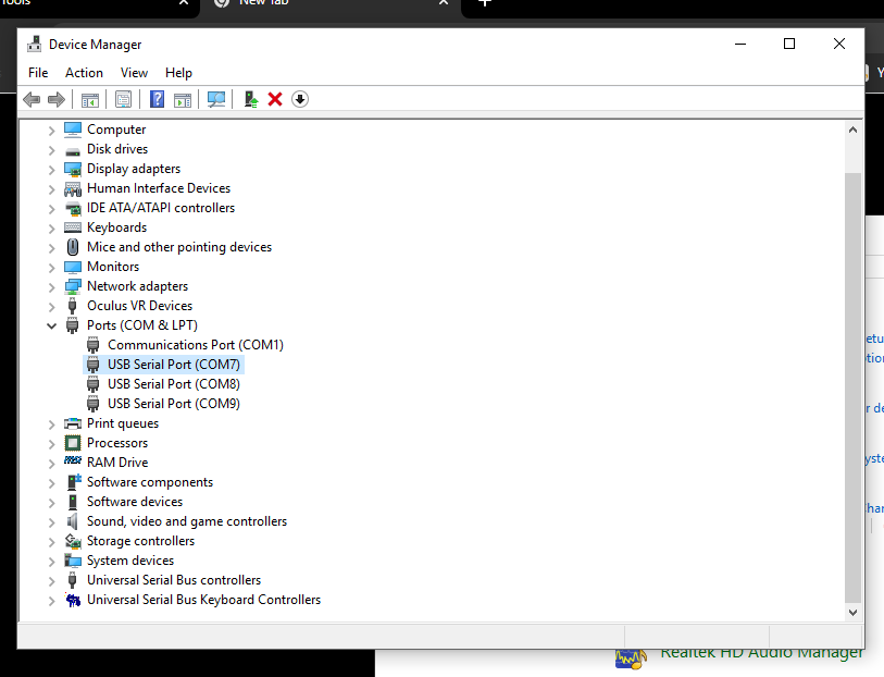

    these are the ports i have and they are all say working properly

    no i dont have them anymore,ive emaild prosimu just waiting on reply.i havnt tried the diadic tool.can i test the control box with that then?
