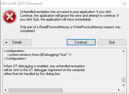

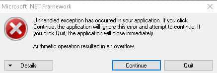

    You have a .net error.
    Please expand the error message and post the full error message.
    It could be that .NET itself is corrupted or a version is not installed.

    First image is from the moment I start Simtools and the game I only got this one time and did not get the details. (error) error simtools.PNG
    Second Image is when Simtools gets an overflow as is the second code. (crash) crash simtools.PNG
    I hope you have everything you need to help me! By the way the language is changed to English (US).

    Can you please hit the Details button on the error and take a picture of the full message.

    Yes the attached .txt file is the whole text that hides under details... I hoped that was clear sorry for the confusion

    If you have a .net error then follow the advice and do a .net repair:

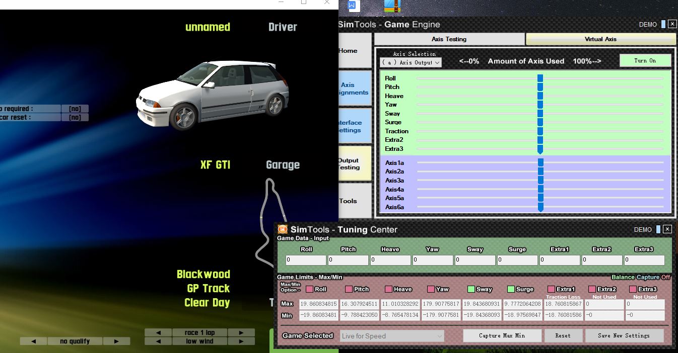

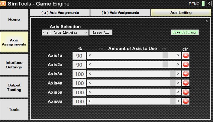

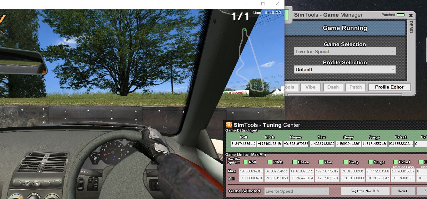

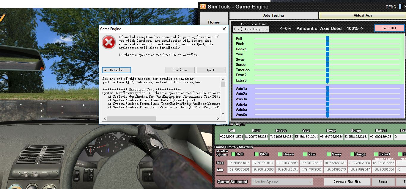

    Dear noorbeast, yesterday i thought i have solved the .NET problem with Restoro, but in the game still have one error , it seems relate to the game engine, i use 3 picture to explain:
    Picture 1 : when open the LFS, game manager connect good and the Tuning Center also can get the data ,but the seat can't move, the SCN5 can't work, although they passed the commissioning in Game Engine before the game run.[​IMG]

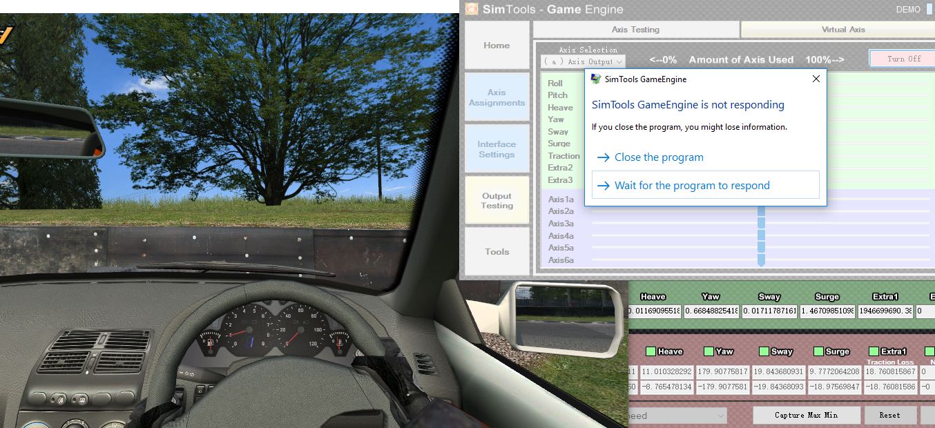

    Picture photo 2: After clicking the button"Turn on" of the Virtual Axis, the error come out as the shown on the photo. the Tuning Center can get the data , but the seat don't move . and the game engine no respond [​IMG]
    Picture 3: After clicking the button "Quit" , the game engine will be crash , as the picture shown [​IMG]

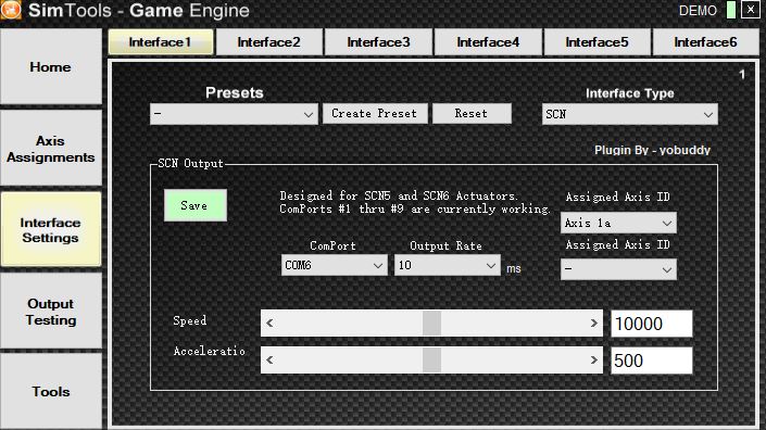

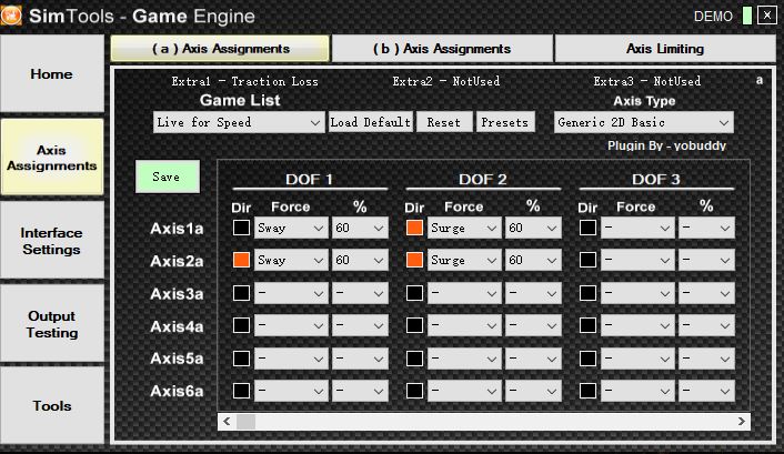

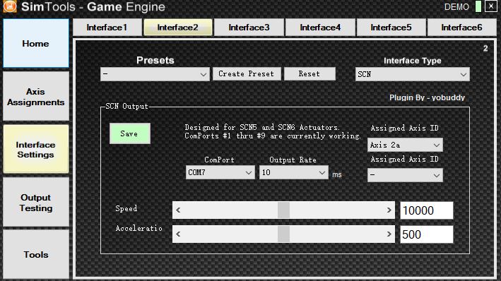

    @noorbeast there is my simtools configuration , my seat is 2 DOF SCN5 , i don't know where is the mistake to make the PC occur this error : "arithmetic operation resulted in an overflow"

    After Reboot the Pc and change the language, it works, thanks a lot
