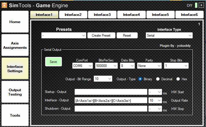

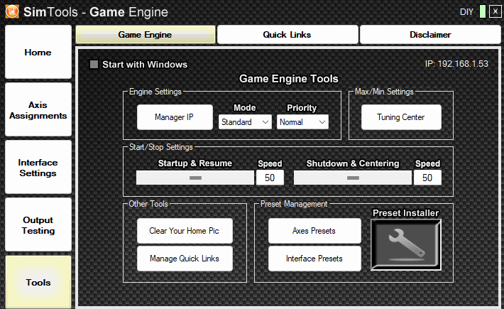

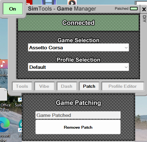

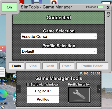

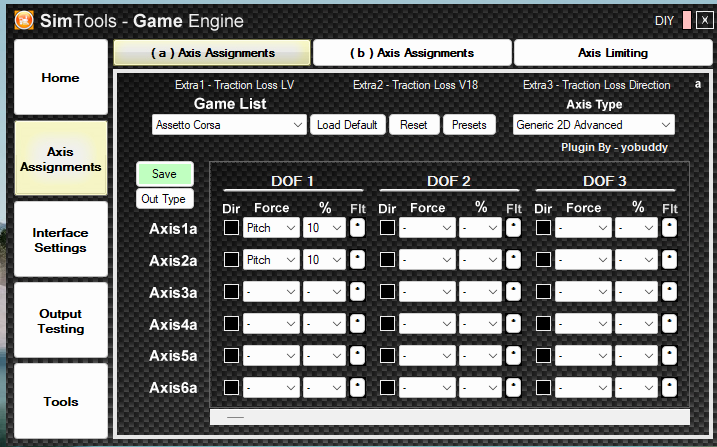

    Hello everyone, I've been building my 3DOF system for several months with 24V 20A motors mounted on the front of the SIM cards, and I'm having issues with the socket. After fixing some grounding issues with the motors and the control box, I finally got everything sorted and am able to achieve good results with the SMC3. Everything is working fine here.
    When I run Simtool with the settings recommended in the manual, the motors are unresponsive, they don't move, and I don't know what else to do. Please help.

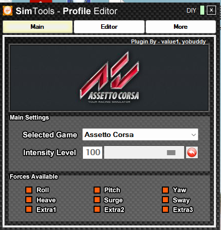

    There is no picture of Axis Assignments.
    You should ensure there is a Default Axis Assignment setting the test that in Output Testing before messing with AC.
