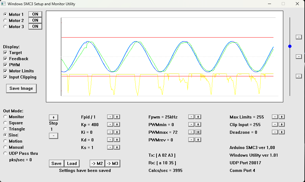

    Can you please post pictures of the SMC3 settings for the problem motor running the Sine test.

    Here is a screenshot, the settings are the same in the second motor, but such things do not occur there

    Thanks for the reply, actually when I went to SimTools I forgot there was anything else in the manual. Tomorrow I will set these parameters and test further. I hope this helps

    I analyzed these parameters. The Clip Input and Max Limits values match the design limits of my platform. I would even say that the value of 255 is not enough. I need something to slow down the movement when the values are approaching the max. Is this what the PWMrev parameter is for? Maybe I could use it to ensure that it does not exceed the limit values

    Yes, PWMrev is used to drive the motors in reverse (hard brake) if they enter the limit zone.
