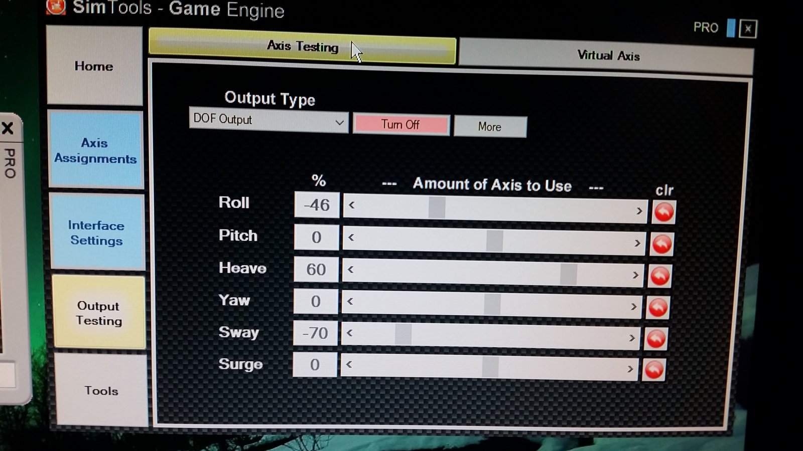

    Hi, I'm new here. Trying to get my simulator to work with Wartunder. It works perfectly with live for speed. Everything looks normal, but when I start the game, it is moving. When I start flying there is nothing that moves?
    I'm out of ideas.

    Please post pictures of all of your settings, including Axis Assignment and also of the Tuning Center with WT running..
    Can you also please confirm that WT patched correctly for motion.

    Here are my settings. By testing everything looks ok. When the game is active, nothing happens in the tuning center. 20181014_161606.jpg 20181014_161617.jpg 20181014_161634.jpg 20181014_161654.jpg 20181014_161749.jpg 20181014_161801.jpg 20181014_161816.jpg 20181014_162039.jpg

    As you look at the last picture, nothing happens in the tuning center. When the game is active.

    WT is sending data just fine, but your setup is odd for Axis Assignments, unless you have dedicated actuators for each DOF, even then your allocation should be refined.
    Your Tuning Center values are also way too high. You need to capture and save the values then refine from there.
    See here on how to refine a motion profile: https://www.xsimulator.net/community/faq/steps-to-create-a-motion-profile.228/

    I have talked with the supplier of the simulator.
    It's Gforcefactory.
    He gives me the following feedback:
    The reason why the SimTools crew is confused, is because SimTools assumes that you assign the axes to all six actuators. We use SimTools differently: we just feed the raw axes data directly to the motion platform, such that the motion platform can decide how to move, instead of SimTools. This principle works fine.
    For optimizing the tuning center, you need to contact SimTools, as I am not the expert here...
    He also says that he uses Simtools in the same way as I do.
    And it works in the WT?
    Have wondered if the network seems as it should.
    Today, I removed a wireless router switched all IP addresses, and tested everything again.
    Same result as before.
