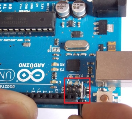

    Reconnect the Arduino on your PC and give a short pins that are shown in the image below:
    Take the jumper near the Arduino to avoid short circuit (but keep it connected to the PC).
    This is to be able to be reprogrammed USB / Serial communication chip (ATmega8u2 or ATmega16u2) and leaves it in DFU mode (Device Firmware Update).

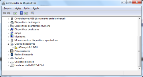

    Arduino will be recognized in the Device Manager as shown below:

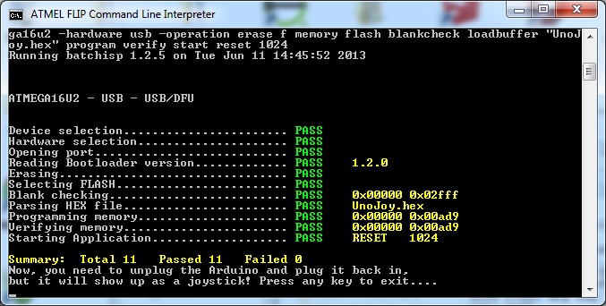

    Then make sure that you have installed the FLIP and run the file:
    UnoJoyWin> TurnIntoAnArduinobat
    A screen will appear like this:
    Disconnect the Arduino USB and reconnect.

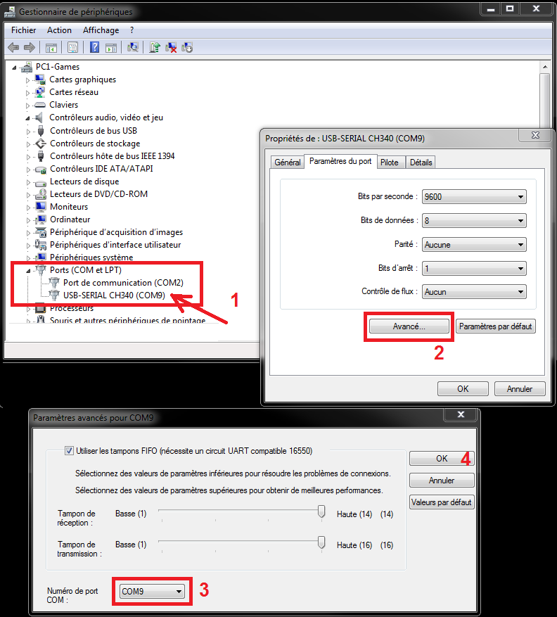

    It looks complicated and hazardous...
    Why don't you use the windows Device Manager? it allows you to change the port
