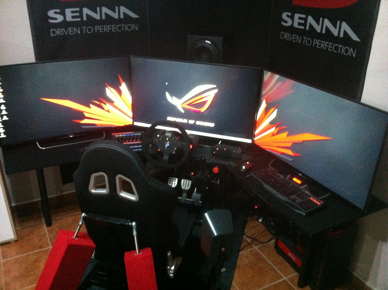

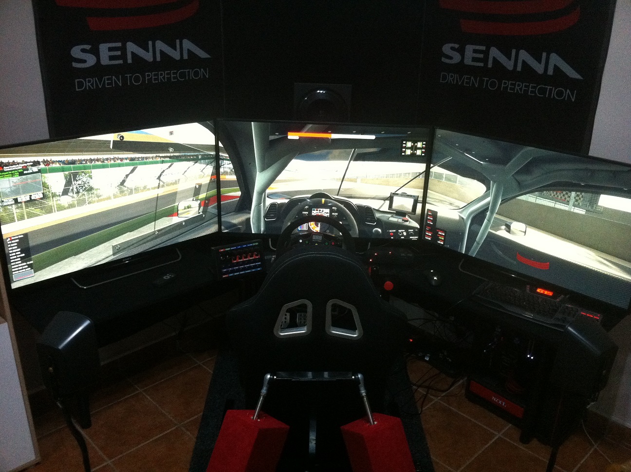

    My rig is placed in basement, I have a black wooden desk as base for TV's, wheel, displays and stuff, while SCN seat mover base is made from steel. The equipment is following:
    • Fanatec CSW V1 Wheel with BMW GT rim and F1 Rim
    • Fanatec CSP V2 Pedals
    • Derek Speare Sequential Short Throw Shifter - I must say, that shifter added so much to the racing feeling, I was using TH8RS shifter before, but this one is just on another level as sequential. Havent used Fantaec CSS thought, I've heard is very good too.
    • 2x Mechanix Vent Gloves for racing - Red Ones are bit stiffer, less flexible - while the Black Ones are more soft and flexible which I prefer more, but I have two pair for friends when they come, each like their owns..
    • My PC specs: ASUS Maximus Hero VII board, INTEL i7 4790K cpu, 16GB Corsair Dominator Platinum RAM, 2x Palit GTX970 gpus in SLI, Corsair HX1000i PSU, NZXT H440 case

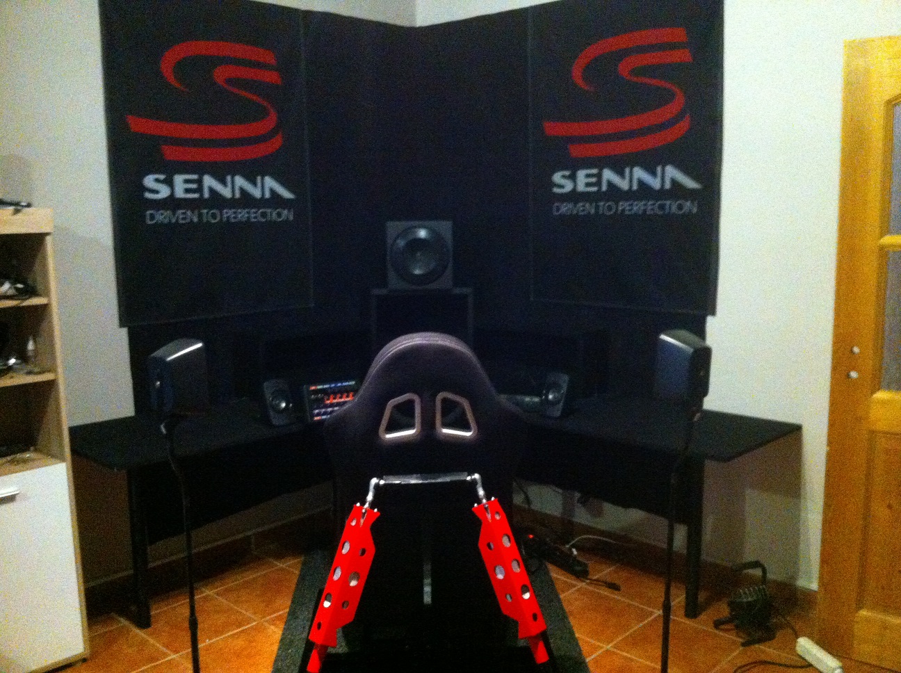

    This is my basement racing corner when SimXp actuators were mounted, without screens on table:

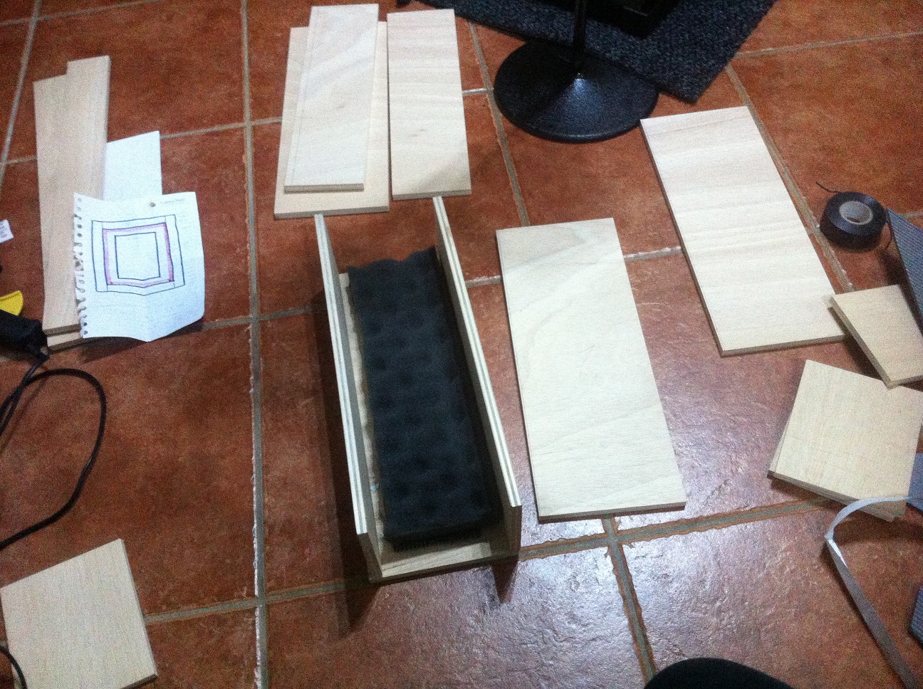

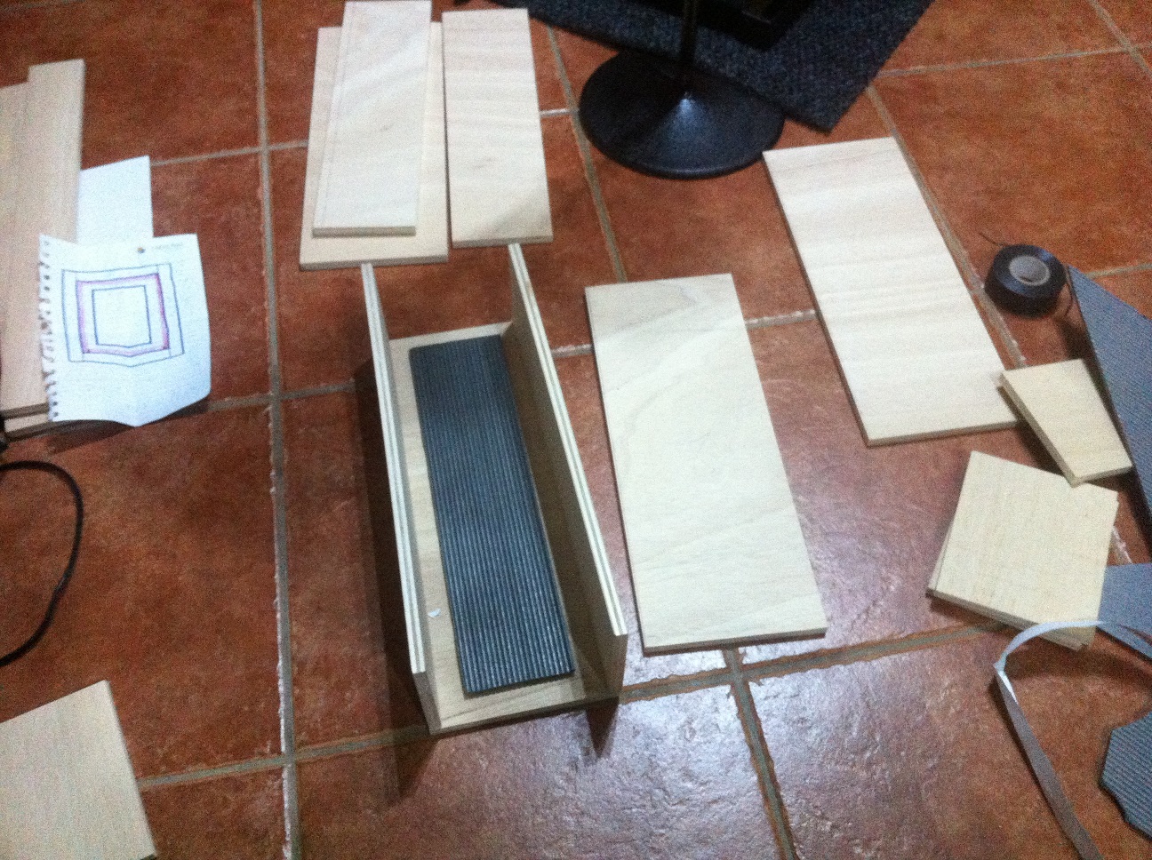

    One of the first things I've noticed on the SCN actuators of course was the sound they were producing. Watching videos before I always thought the camera is exaggerated those sound but they are really high pitched in reality too. So because "Just wear a headphones" was not an option for me, I've decide to try making soundproof boxes for them. Firstly I've tested how much those actuators are getting heated while playing, letting AI in rFactor 2 driving for about an hour and the SCN's weren't heated almost at all.
    So I start building simple boxes, because I didn't know what to expect or if they will do good job. I've used 1cm thick plywood, covered inside with two layers of 0,5 cm high density soundproofing foam and on top of that added some more lower density foam. The box was the wrapped around Simxperince's damper kit, all possible holes around the box were filled with silicone sealant to prevent sound eventually coming out.

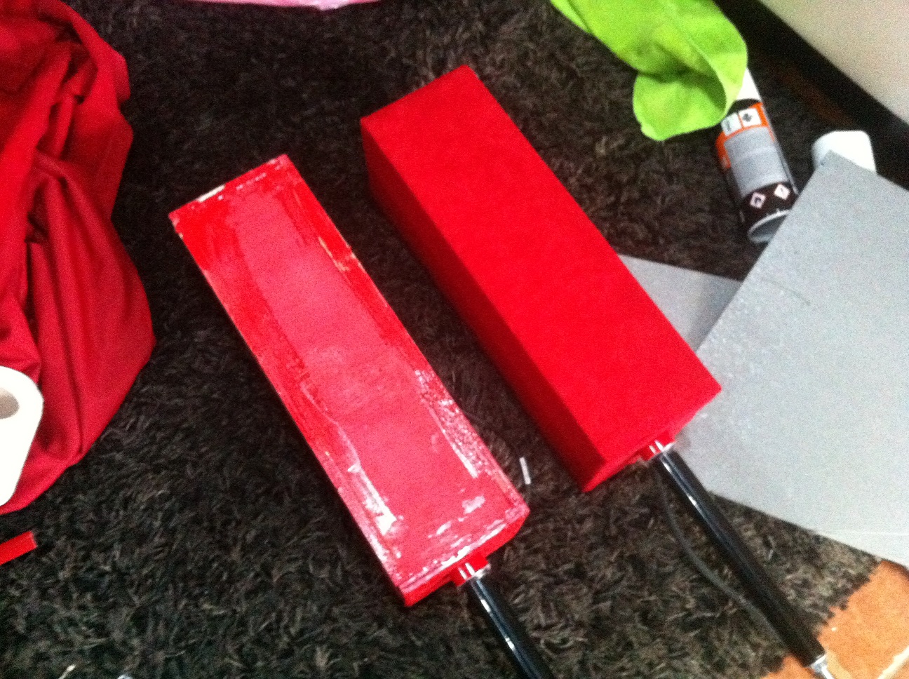

    The problem I've run into latter was when I wanted to paint the boxes. Because of plywood's absorbing the color and silicone sealant not, the outcome was not very pretty, there were color imbalances and color falling of the sealant. So In the end I just coated the boxes with red fabric coat material which made it good.
    Left actuator tried to paint - Right one with coating

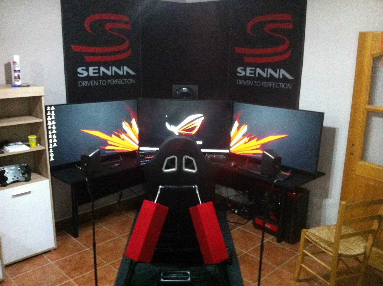

    When everything was assembled, it turned out like this:
    Here are some videos to demonstrate what did the soundproofing boxes do, first video without box, second video with them - the setup before and after was all the same, the recording position and motion profiles was not changed, nor the videos are being audio manipulated.
    Don't mind the movements in those videos, that was for testing purposes, set strong and driven of the road. The actuator sound of course was not eliminated completely but it made it much better while driving in the rig, adding a bit of more volume and they don't bother at all. Maybe one day I'll make better boxes with MDF or HDF wood, some better foam, but for now, it's good as for the first try.

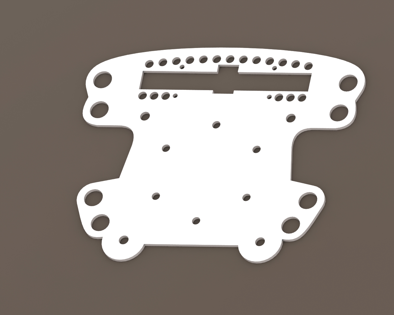

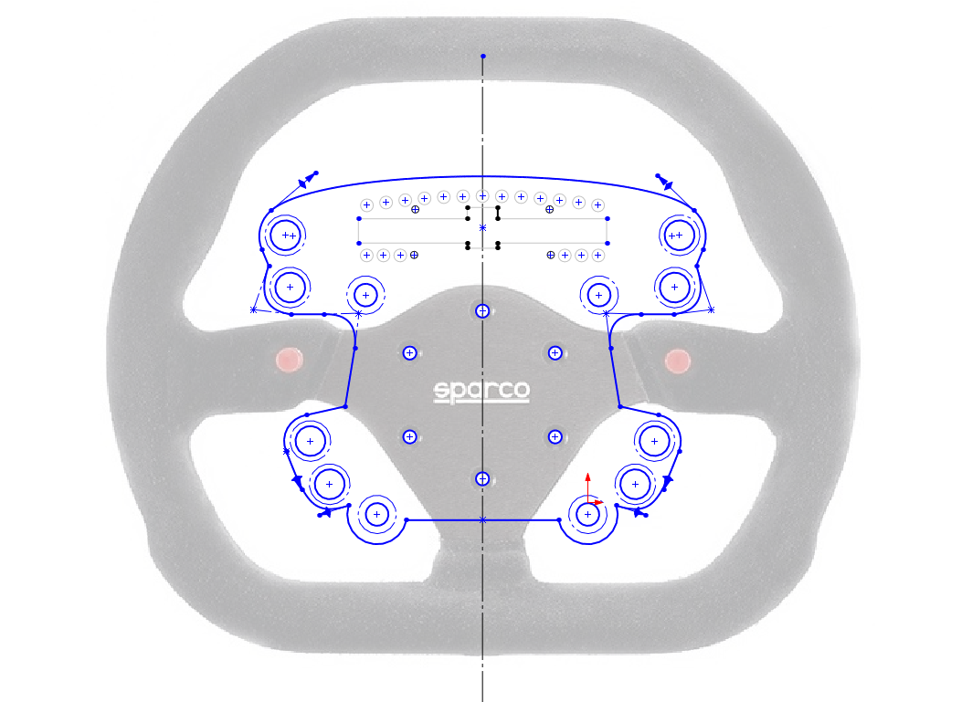

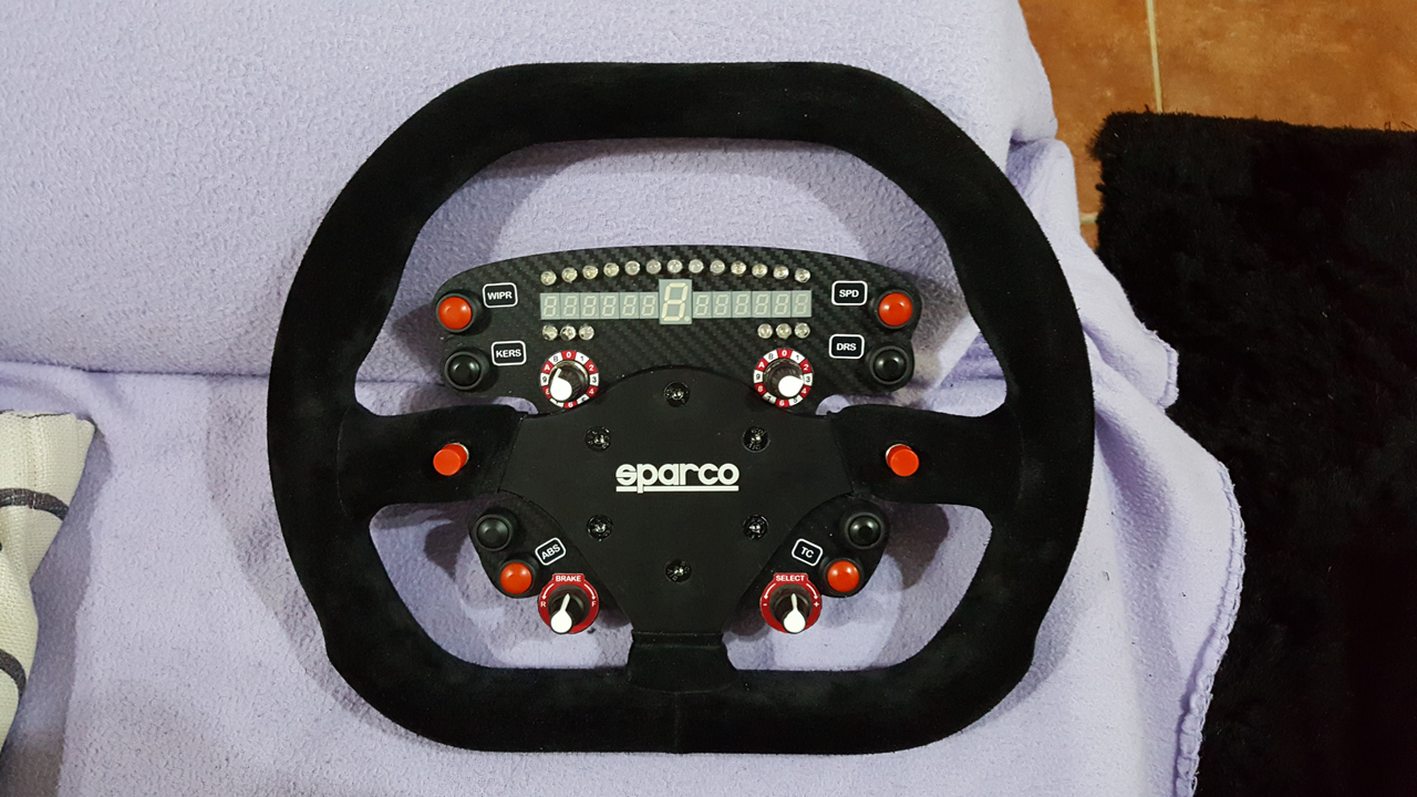

    In meantime, I have changed some stuff on my rig, there is no more Fanatec stuff there, I did some upgrades so now there is an OSW Direct drive wheel (IONIhc+Mige10), Heusinkveld Pro Pedals, Heusinkveld Handbrake and Sequential Shifter. I have done a custom button plate for my Sparco P310 rim, currently I am waiting for a 3D printer, so probably I will do more plates for my other wheel rims.
