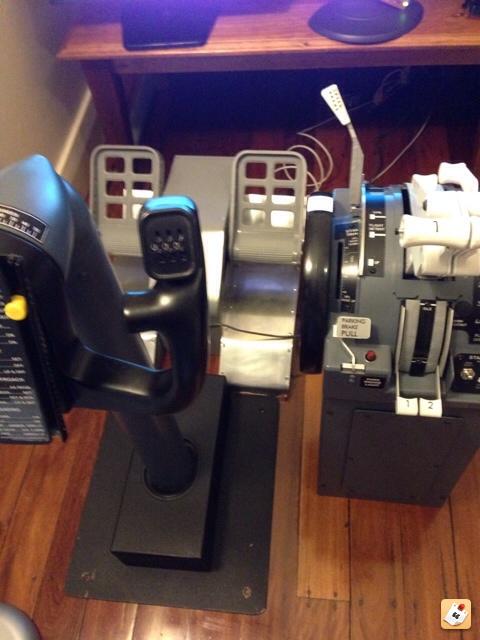

  19. omniatlas
    omniatlas New Member
    Oct 28, 2013
    15
    1Coins
    Hi Earobbie - could you please recommend what would be the best way to built a platform? I would like to minimise cost so would like to build a 2DOF but can also emulate 'heave' - would servo motors be the best choice?
    I would like to put a flight deck onto the platform so we would be talking about a 500 kg load, similar to the motionforsimulator http://motionforsimulators.com build, however they have quote me a price of 26000 euro. This is their platform in motion with a jetmax cockpit
    Whats my power bill going to be like if I build one of these babies?
  20. omniatlas
    Oct 28, 2013
    15
    1Coins
    Can this setup be adapted for a platform? I'm i. The progress of building a flightdeck.
