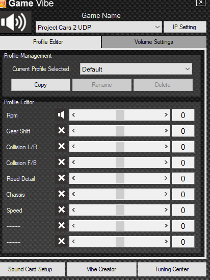

    Hi @vthinsel
    thanx for the plugn...
    the gamedash working fine but the gamevibe is not working for PC2 it shows in the profile editor that the plugin supports the game vibe but when i start the game nothing shows in the gamevibe window...can you help please ??
    BTW LFS working fine
    cheers

    I think it's a bug, hope to knock it out this weekend.

    @fuad,
    I could not find any bugs.
    I used Value1's PC version and it worked just fine.
    So I expect this one would also.
    Take care,
  13. fuad
    fuad New Member
    Sep 9, 2017
    25
    kuwait
    23Coins
    +11 / 0 / -0
    thank you dear it is working fine now i just needed to set the H/L values in the tuner.
