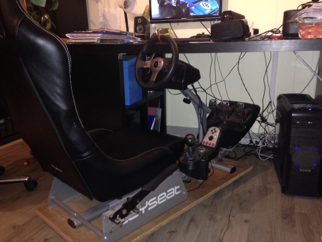

    hi everybody, it's me Nickrift and am currently building my first dynamic simulator
    the aim will be to modify my existing Playseat
    I registered on the forum or PCSHM I found all the necessary bases for the construction
    I also own a G25 steering wheel + a parking brake 205 + an Oculus Rift DK2

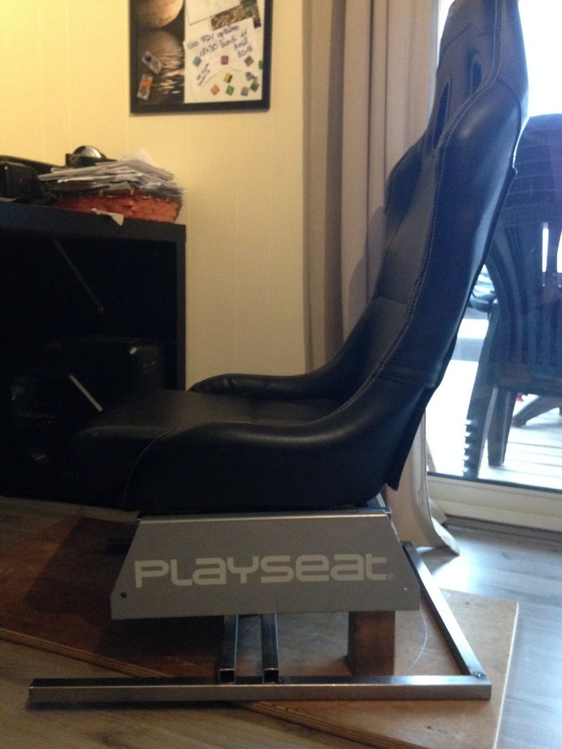

    here is a picture of my simulator before the amendments

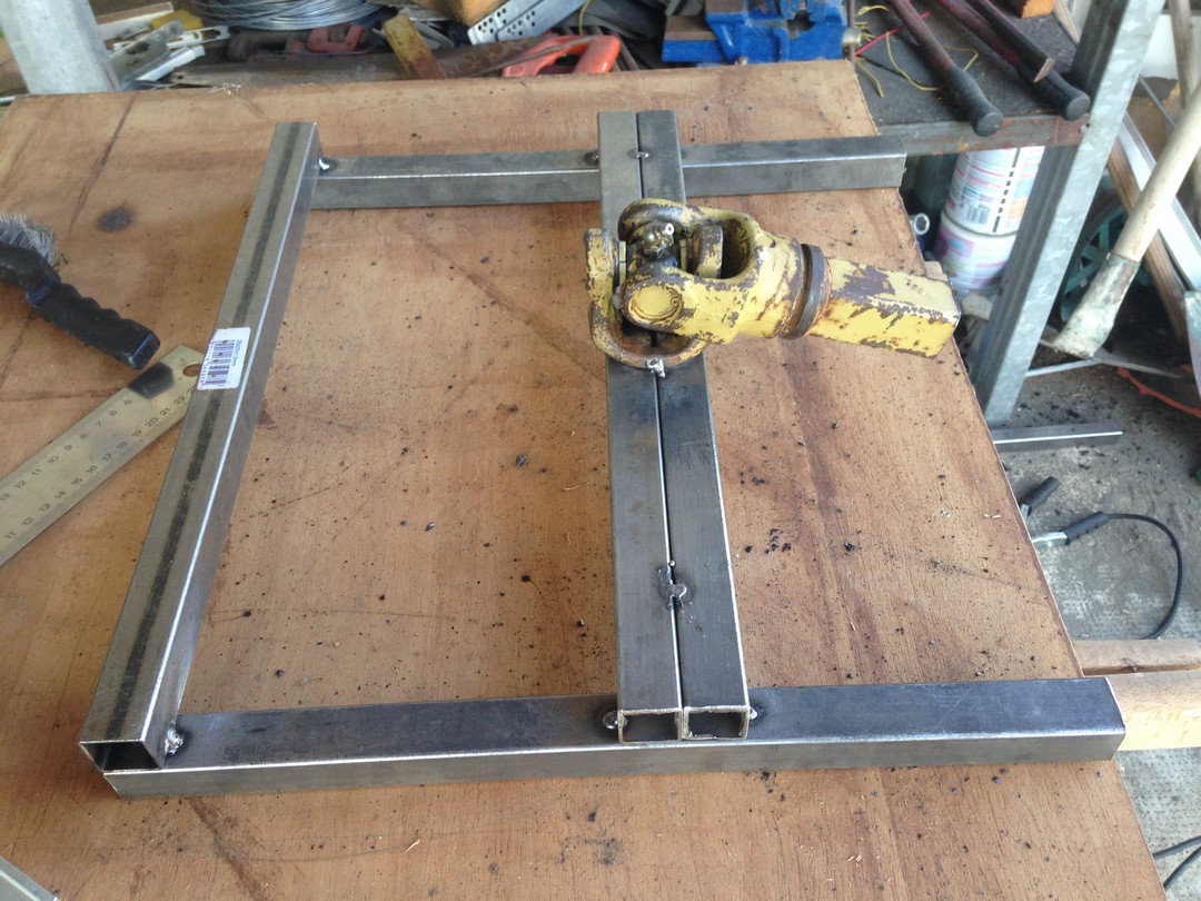

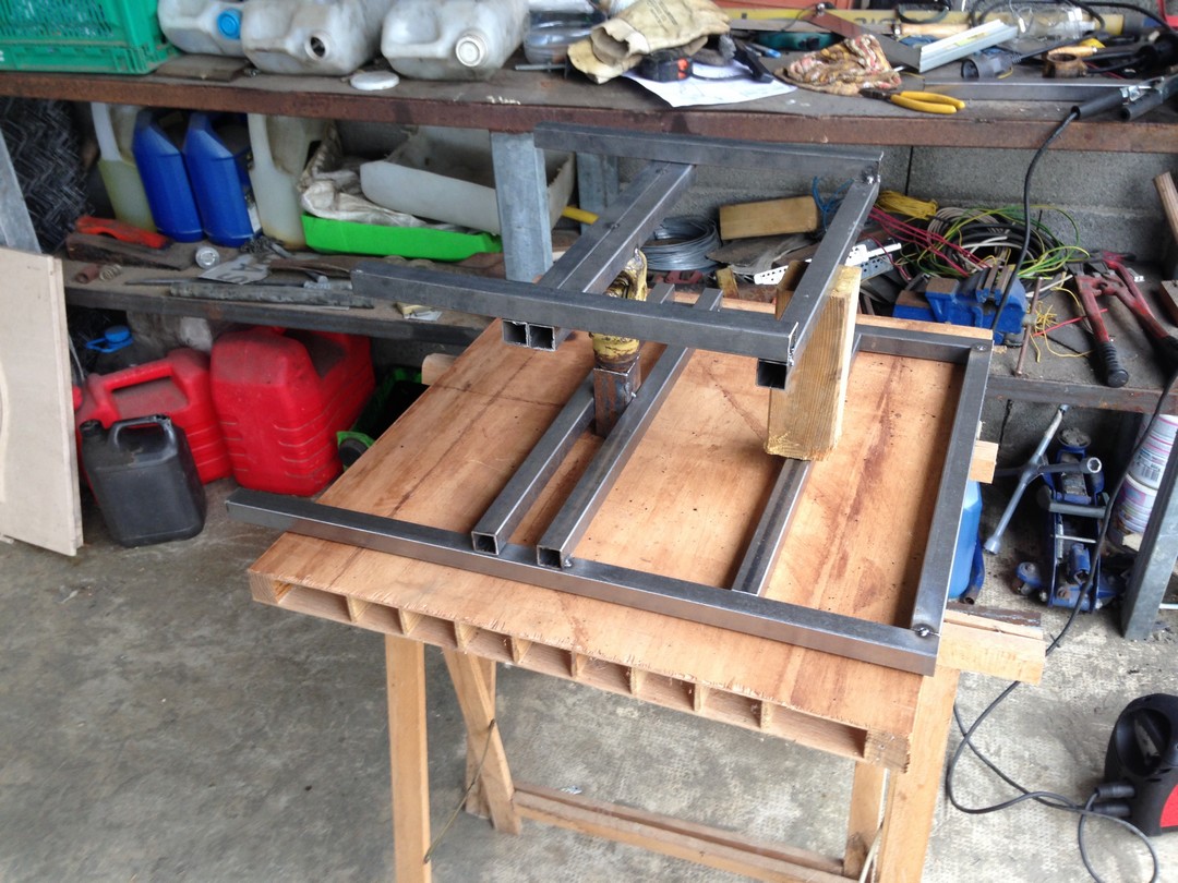

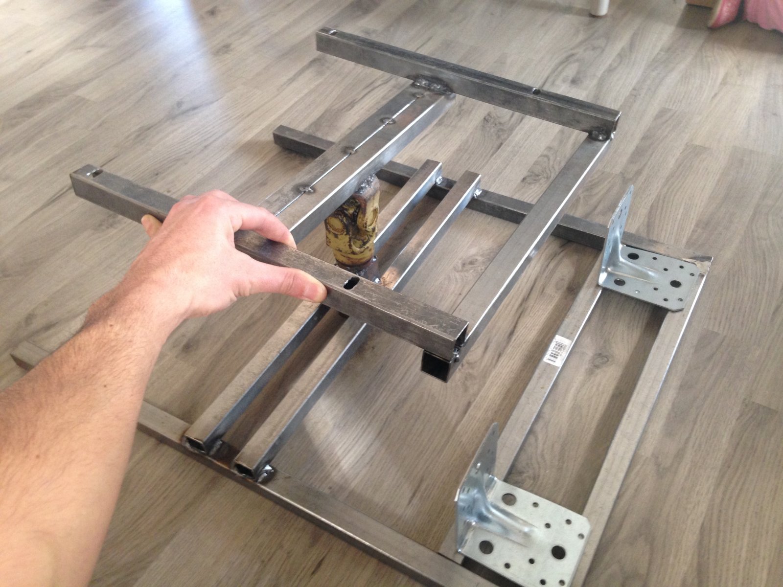

    I have welded Start, HERE Photos:

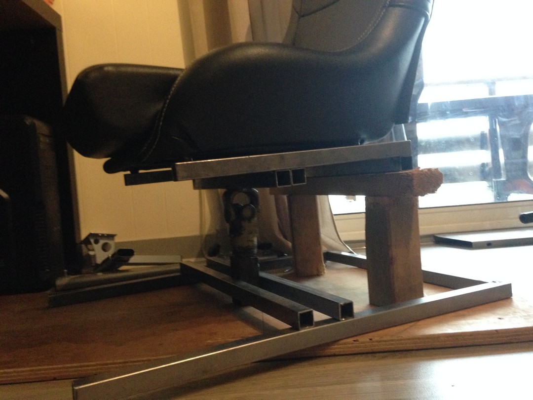

    Here are more photos

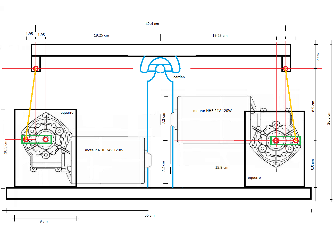

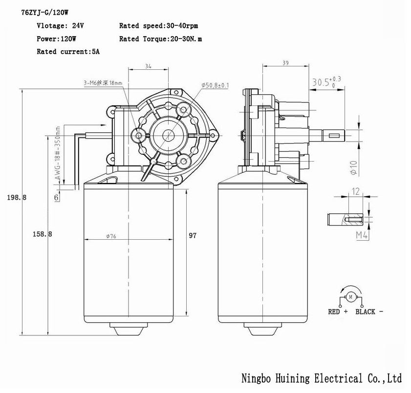

    here is some info about motors and the electronics:
    2 engines 120W 24V 40rpm
    1 Arduino UNO
    1 Sabertooth 2x32
    1 power supply 24V 20A
    in fact I plan to buy a kit wanegain and his team on the site PCSHM

    Here is a map of the new kit motors

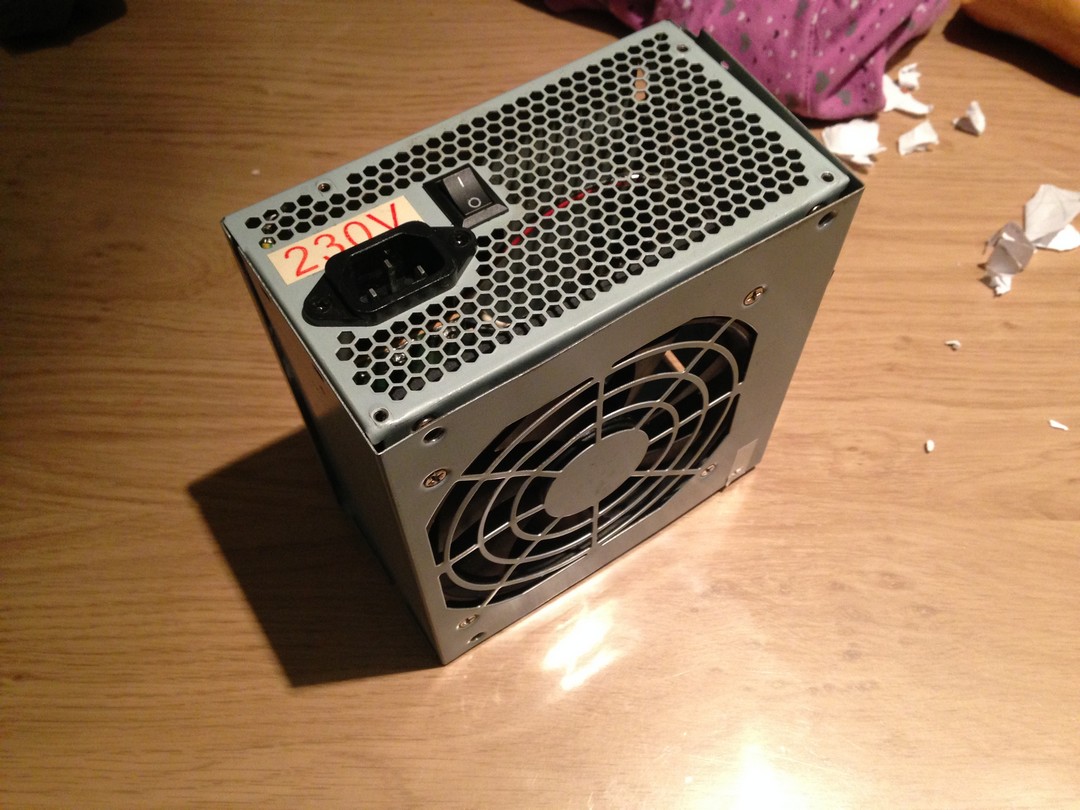

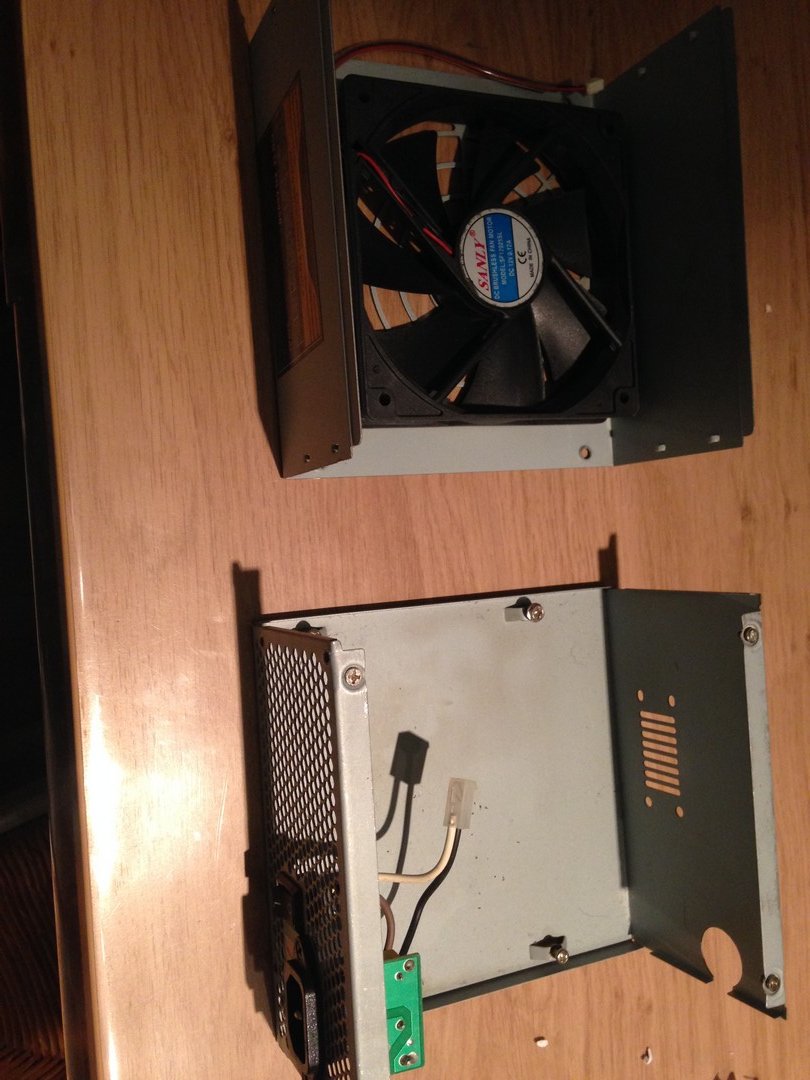

    I also recovered an empty box of pc power supply to put the Arduino and Sabertooth

    here is a "scheme" provisional disposition with new engines made with paint (I have not Sketchup)
    the scales are not well respected, but it gives an idea of the result

    I have finished welding the structure, it remains the welded corner braces
    21,190
    148,820Coins
    +10,919 / 54 / -2
    Nice compact job so far.
    You will likely need more robust bracket for engine mounts, as the motors generate quite a bit of force.
    • Agree Agree x 3
  12. Nickrift
    Nickrift seat-mover 2DOF
    Dec 5, 2015
    50
    france
    - 33Coins
    +21 / 0 / -0
    yes, I was made the remark, I must strengthen engine mounts

    +298 / 2 / -0
    As you know weld, a strengthening of the support should not be too complicated for you. Or you can use 2 brackets by motor.
  14. Nickrift
    Dec 5, 2015
    50
    france
    - 33Coins
    +21 / 0 / -0
    oui wanegain, je pense souder des renforts sur le coté de mes fixations moteur
    je pense faire ca le weekend prochain
    wanegain yes, I think welded reinforcements on the side of my motor mounts
    I think next weekend to ca

    Its looking good, why you didnt used the 150 rpm motors?
  16. Wanegain
    Wanegain Active Member
    Nov 6, 2013
    564
    Bruxelles
    1,982Coins
    +298 / 2 / -0
    Because it's much more expensive :D
    These motors are used on 120° instead of 180° to gain enough speed :thumbs

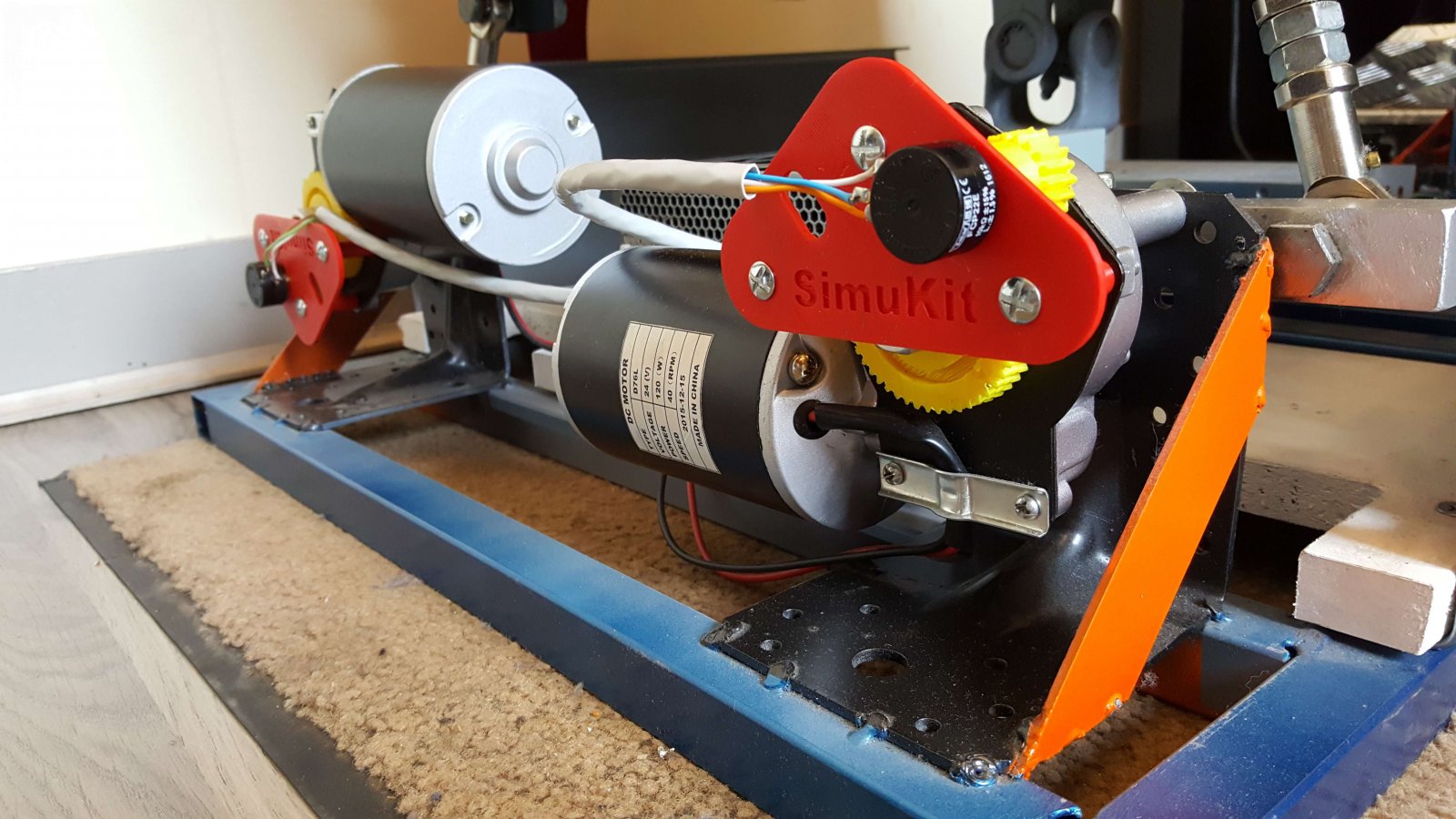

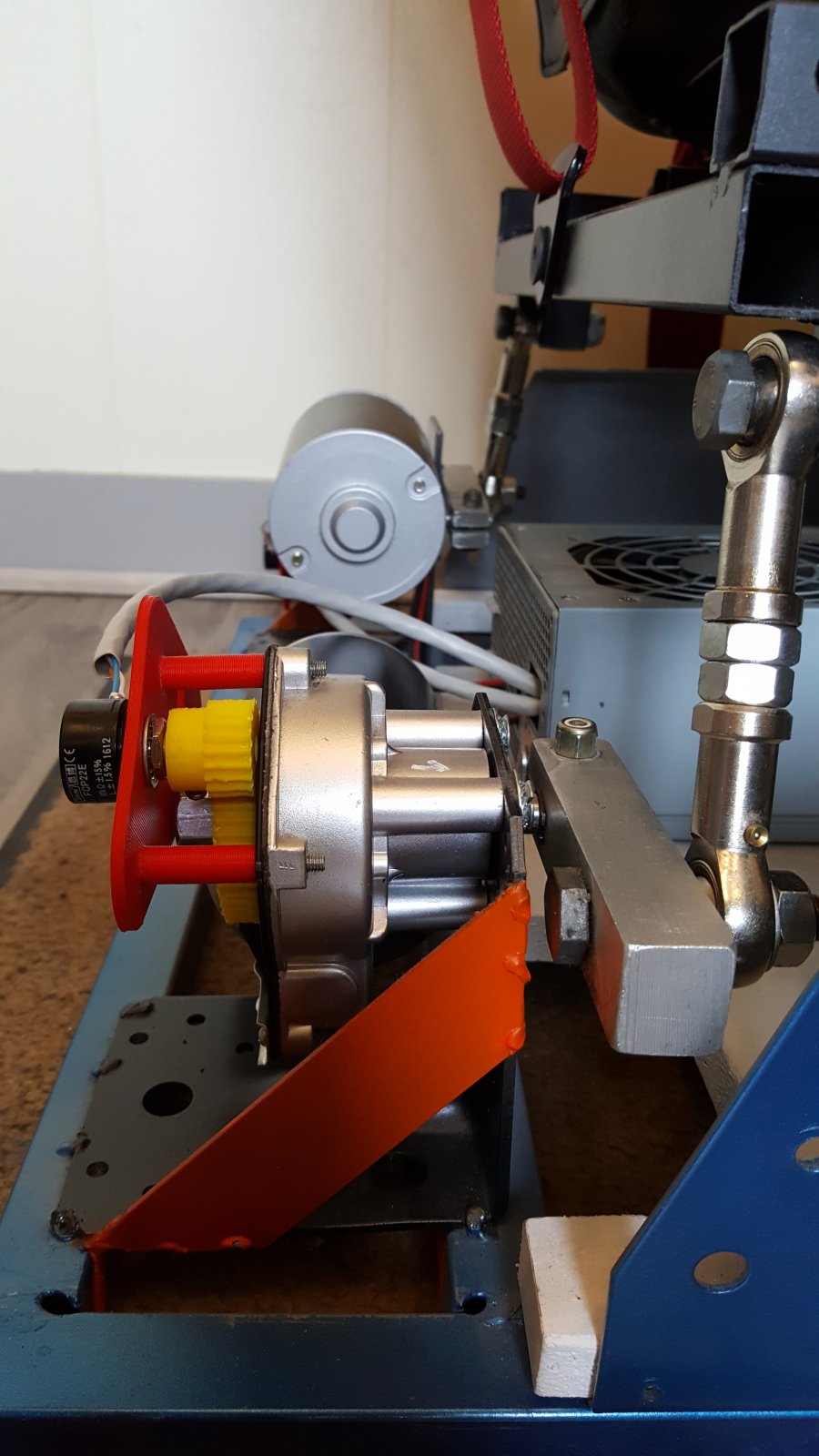

  19. Nickrift
    Dec 5, 2015
    50
    france
    - 33Coins
    +21 / 0 / -0
    these are the new simukit potentiometer mounts
  20. Nickrift
    Dec 5, 2015
    50
    france
    - 33Coins
    +21 / 0 / -0
    ils s' adaptent sur les moteurs 120w , tres facile a monter, une petite clef est fournie pour le serrage des potentiometres
    they fit on the 120w motors, very easy to assemble, a small key is provided for tightening the potentiometers
