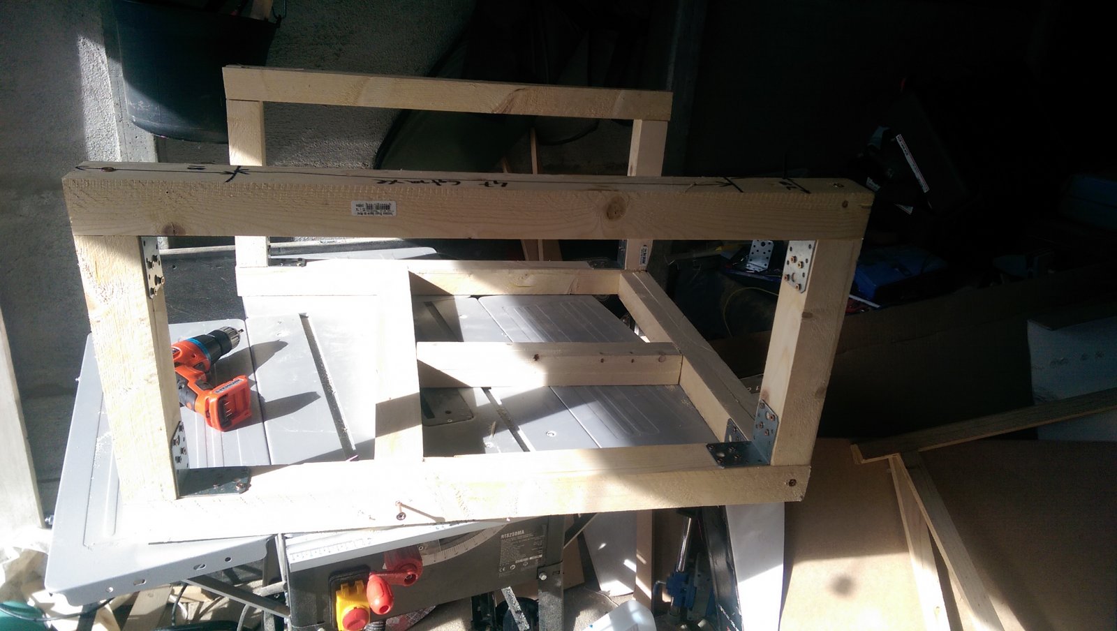

    Salut je voudrai partager mon projet 3dof selon willaupis
  2. hellpanzer
    hellpanzer Member
    Mar 14, 2015
    48
    93Coins
    +10 / 0 / -0

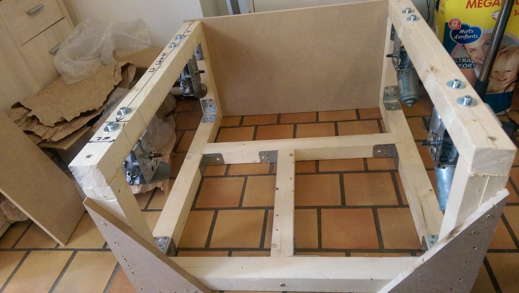

    3DOF, DC motor
    voici ma structure

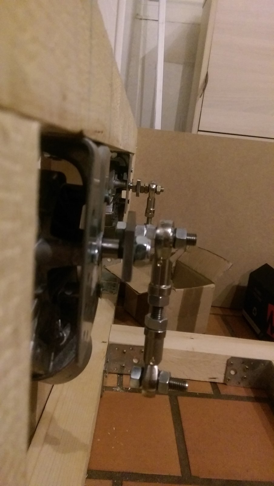

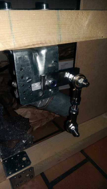

    +10 / 0 / -0
    3DOF, DC motor
    Les bielle qui seront utiliser

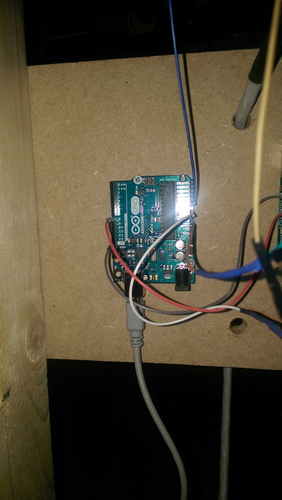

  5. hellpanzer
    hellpanzer Member
    Mar 14, 2015
    48
    93Coins
    +10 / 0 / -0

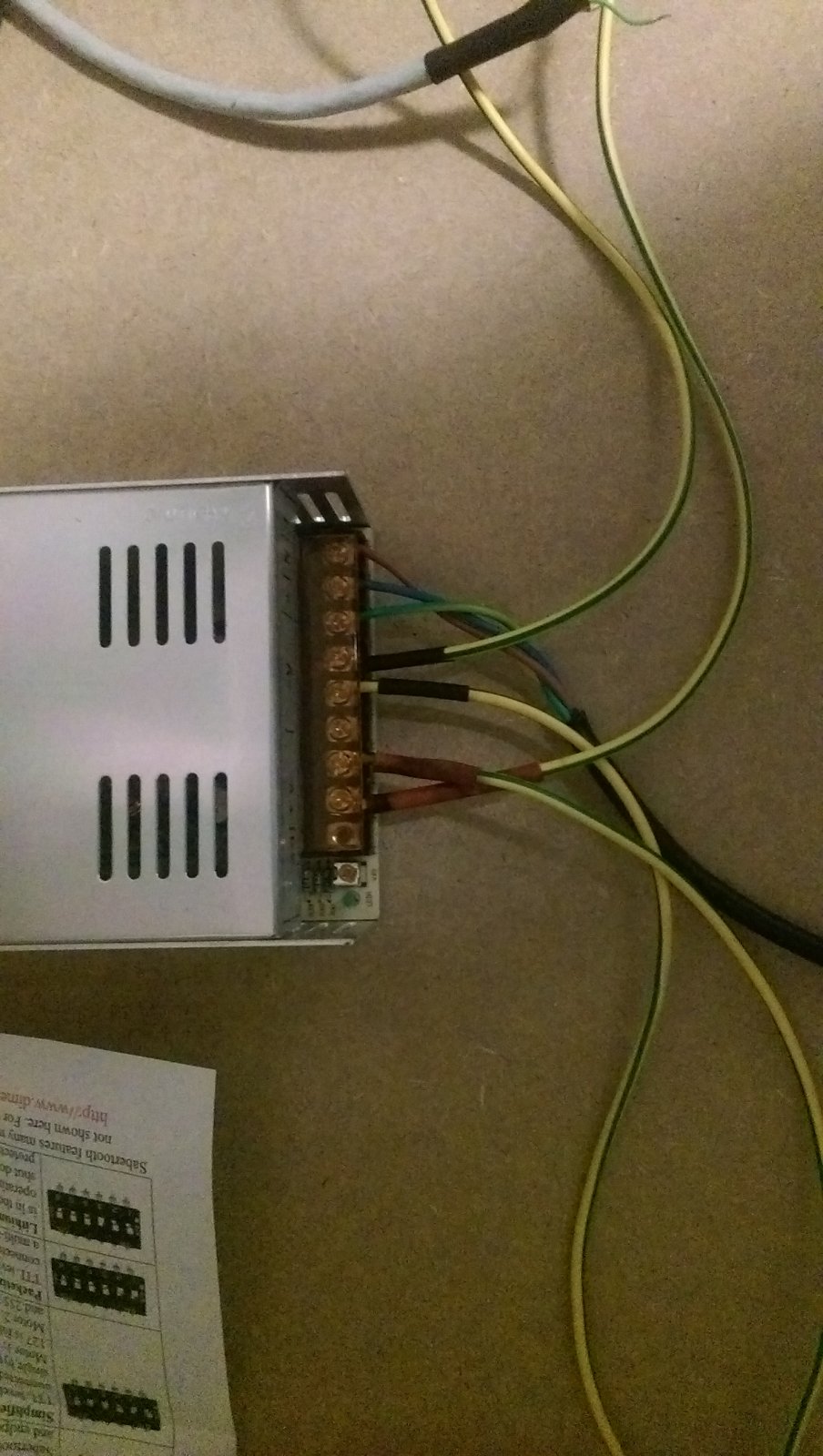

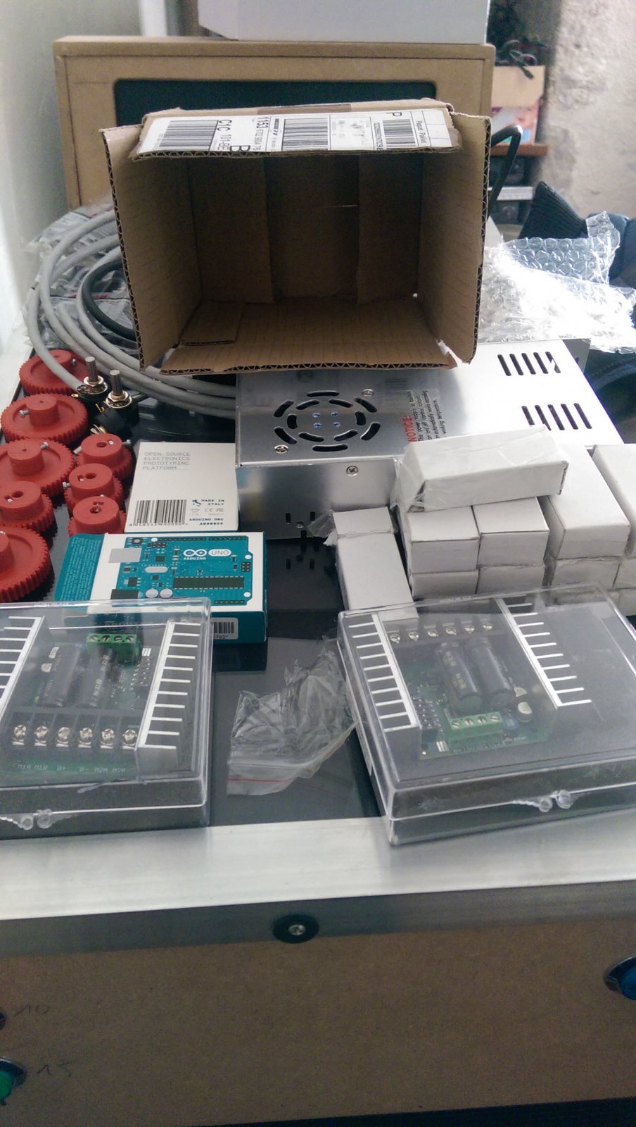

    3DOF, DC motor

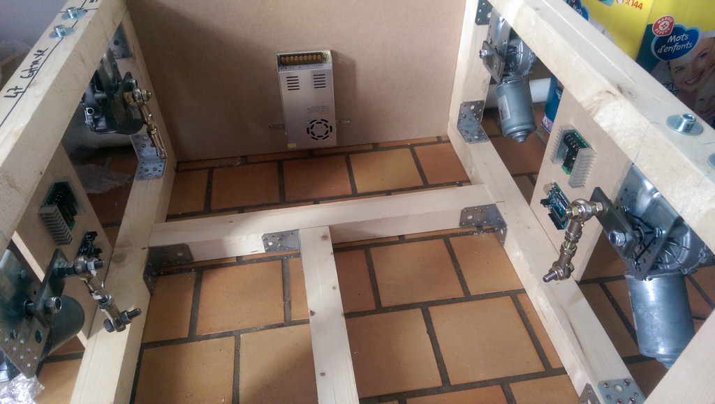

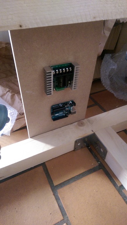

    Mise en place de l arudino et sabertooth et alim 24v

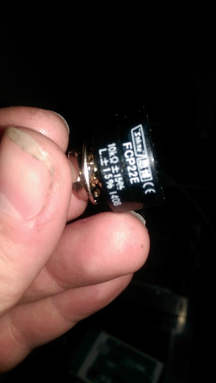

  6. hellpanzer
    hellpanzer Member
    Mar 14, 2015
    48
    93Coins
    +10 / 0 / -0
    3DOF, DC motor
    Potard utiliser

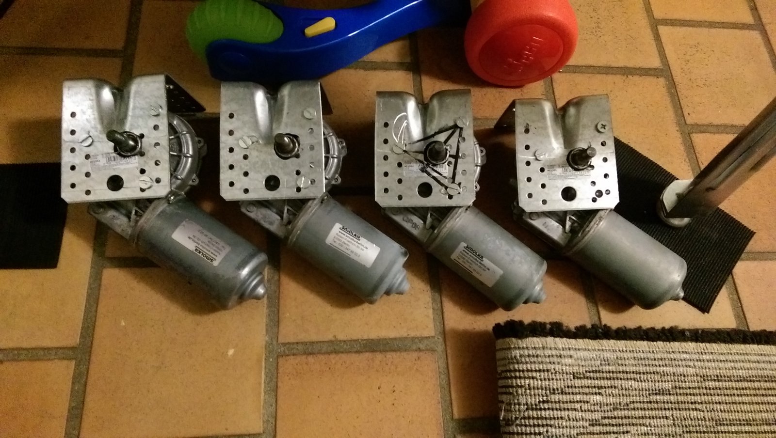

  7. hellpanzer
    hellpanzer Member
    Mar 14, 2015
    48
    93Coins

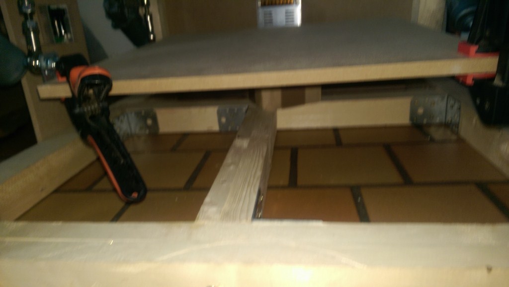

    +10 / 0 / -0
    3DOF, DC motor
    Test de position du support mobile

  8. pipis2015
    pipis2015 over-boost
    Feb 18, 2015
    222
    Athens, GREECE
    10,248Coins
    +272 / 1 / -0
    Nice concept.
    Nice thought to keep your wooden support suspended.
    It woud not be stable at all if you had placed your wooden support over the motors.
    You still have to expect some unwanted twist though.
    To be more clear ... when you conect all four rods ... just try to move the wooden support and you will notice some sideways movement.
    As it is not clear in your pictures ... will you use only one power suply unit for all four motors?

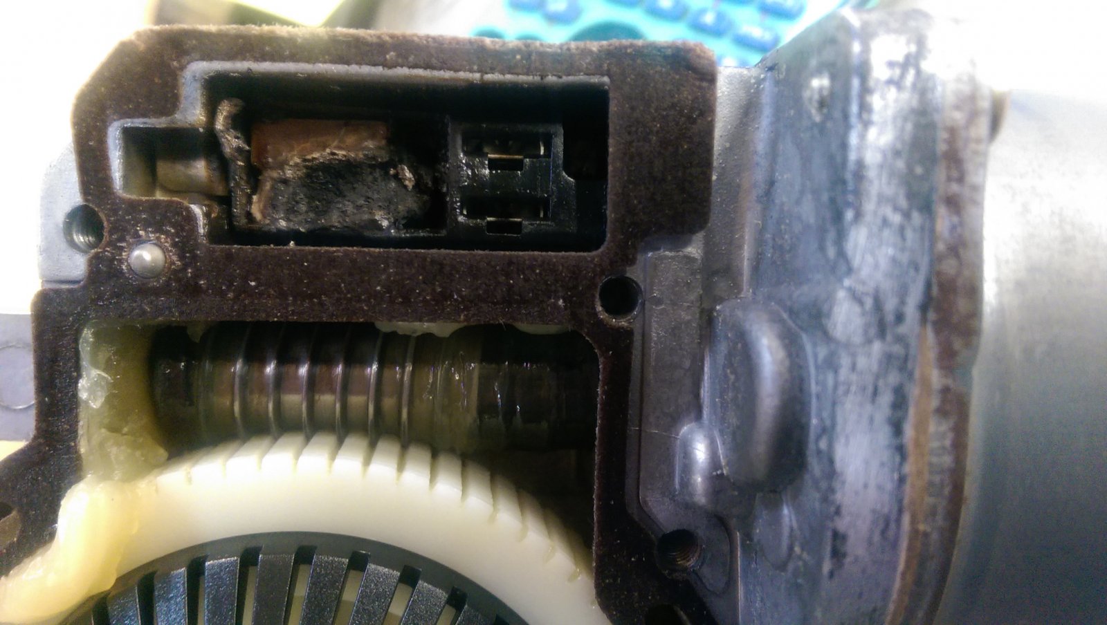

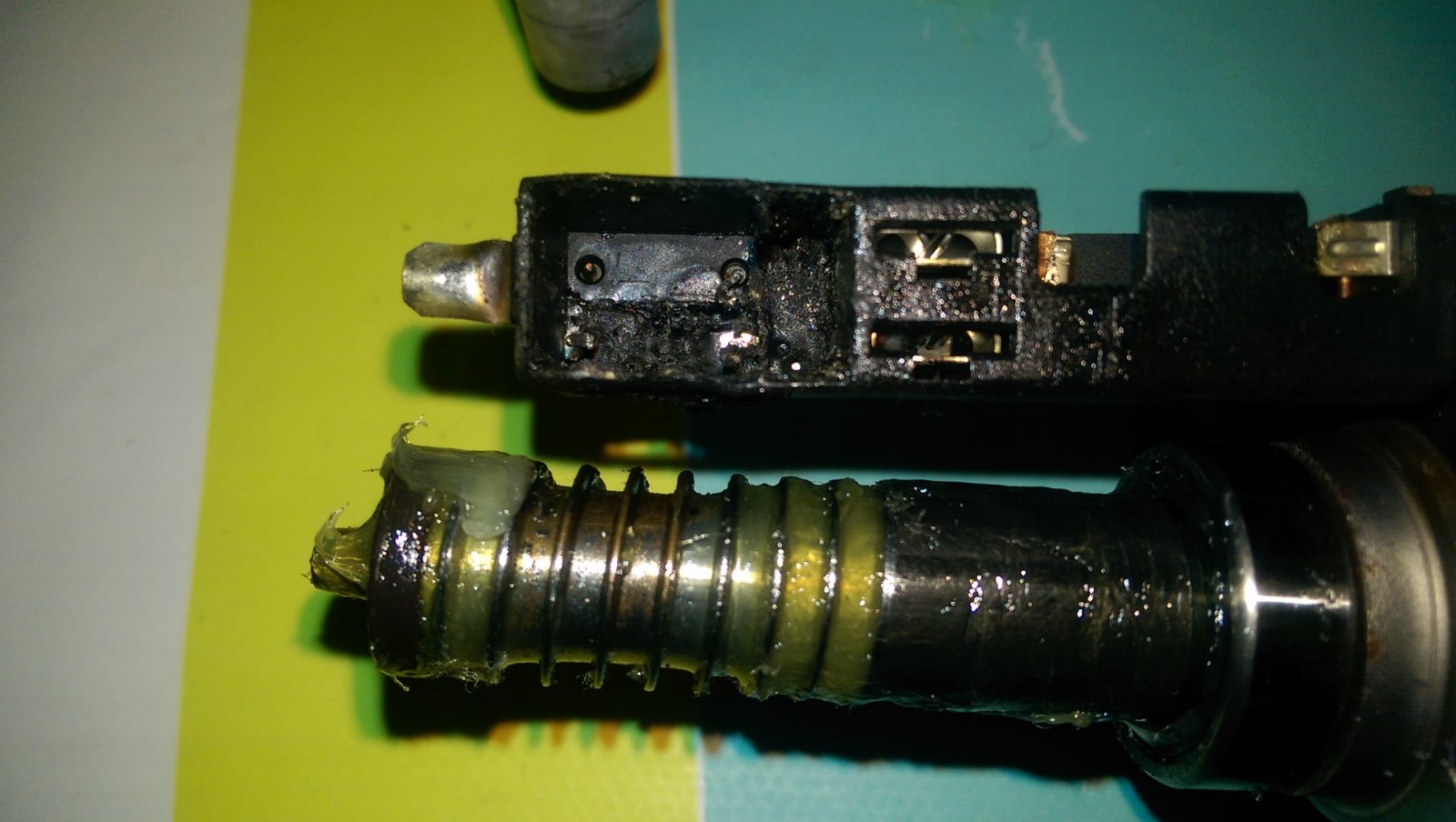

  10. hellpanzer
    hellpanzer Member
    Mar 14, 2015
    48
    93Coins
    +10 / 0 / -0
    3DOF, DC motor

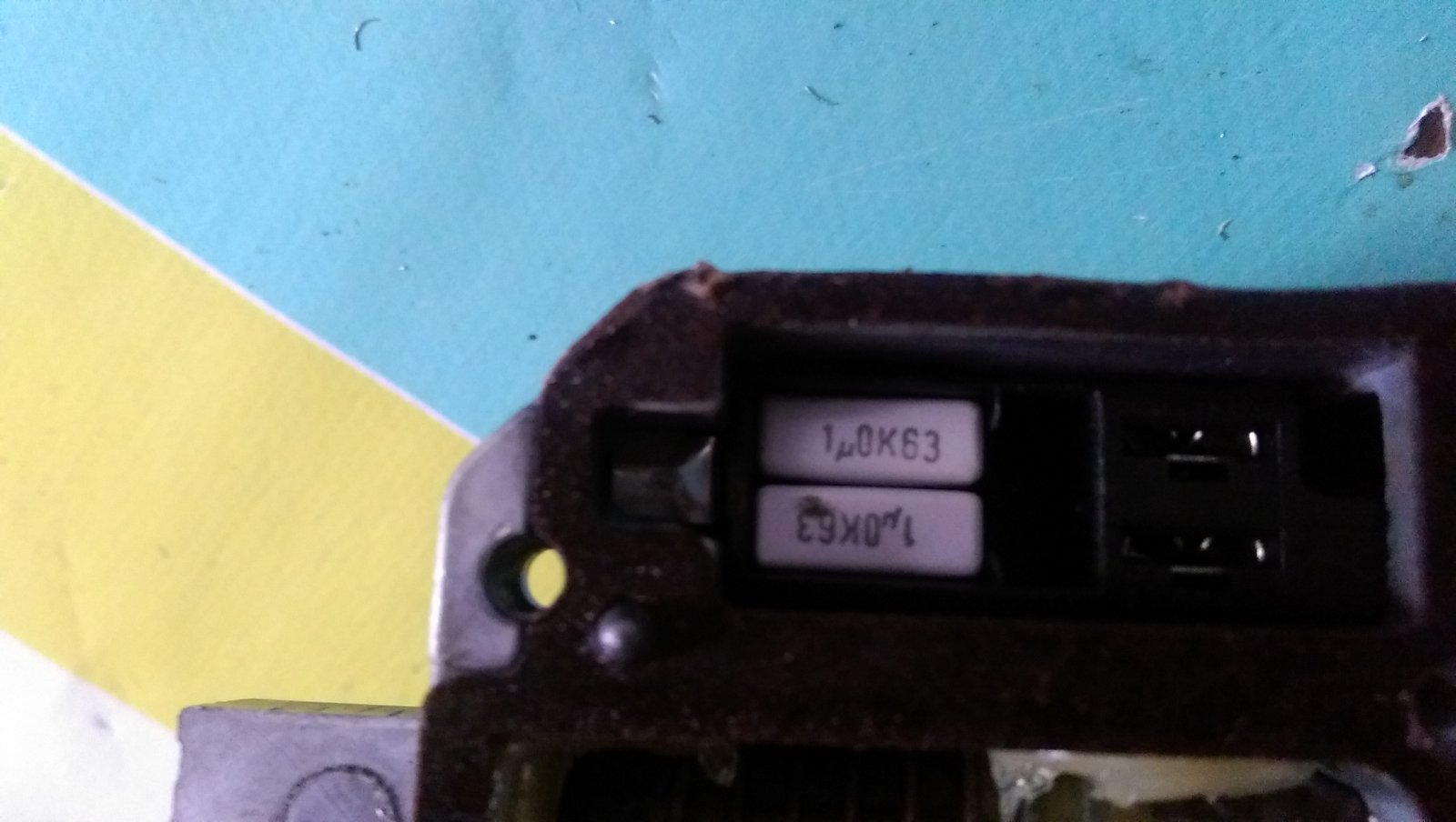

    Jai les condensateur d un moteur quo a cramer .je vais les changer par des condensateur equivalent
  11. hellpanzer
    hellpanzer Member
    Mar 14, 2015
    48
    93Coins
    +10 / 0 / -0
    3DOF, DC motor
    Voila les condensateur d un moteur neuf
    Ce sont des 1u f. 63vcc

    3DOF, DC motor
    Pour la rigiditer de l ensemble je verrai a la fin
  15. hellpanzer
    hellpanzer Member
    Mar 14, 2015
    48
    93Coins
    +10 / 0 / -0
    3DOF, DC motor

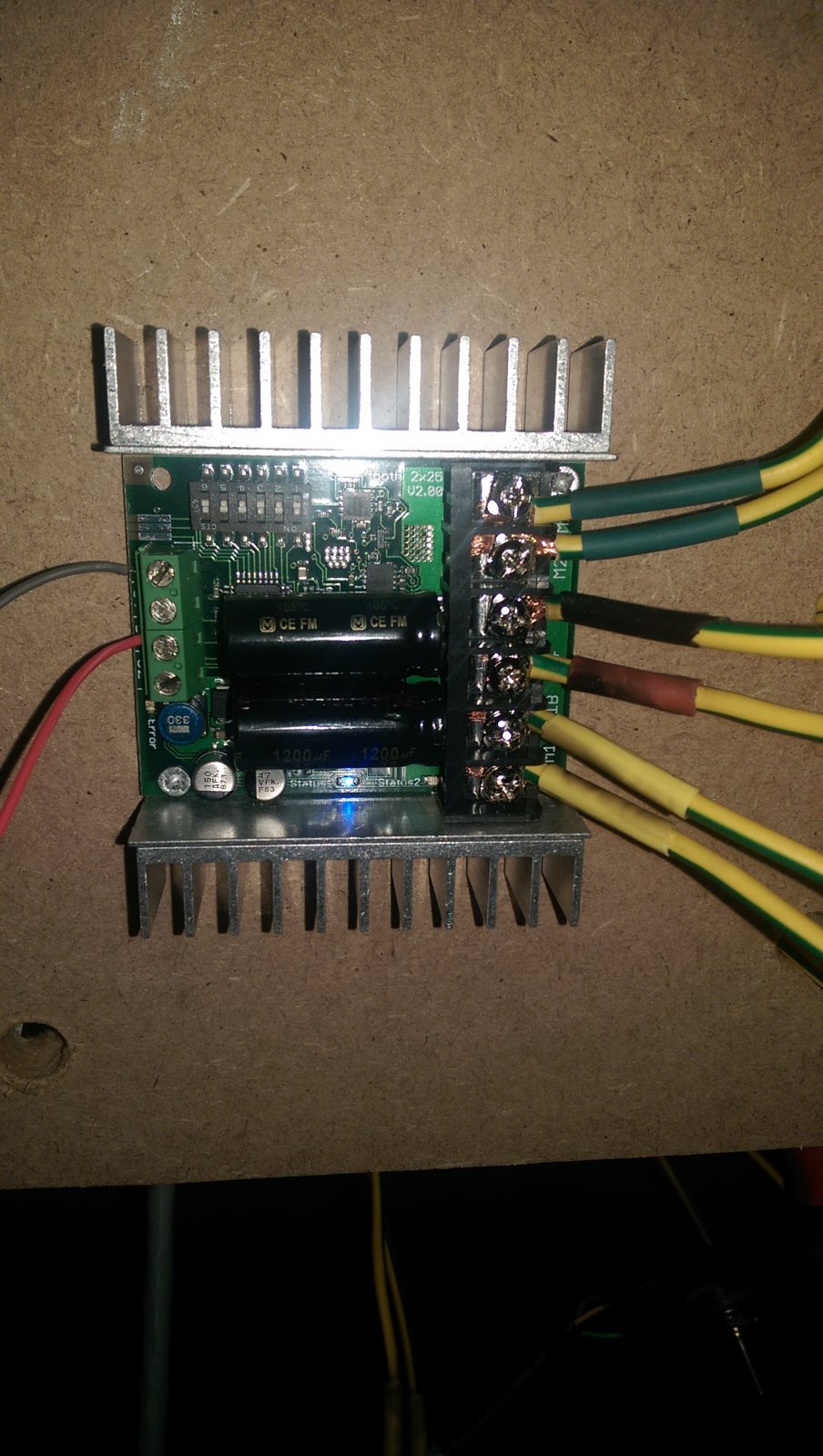

    Voici quelque photo de l alim sabertooth et arduino

    3DOF, DC motor

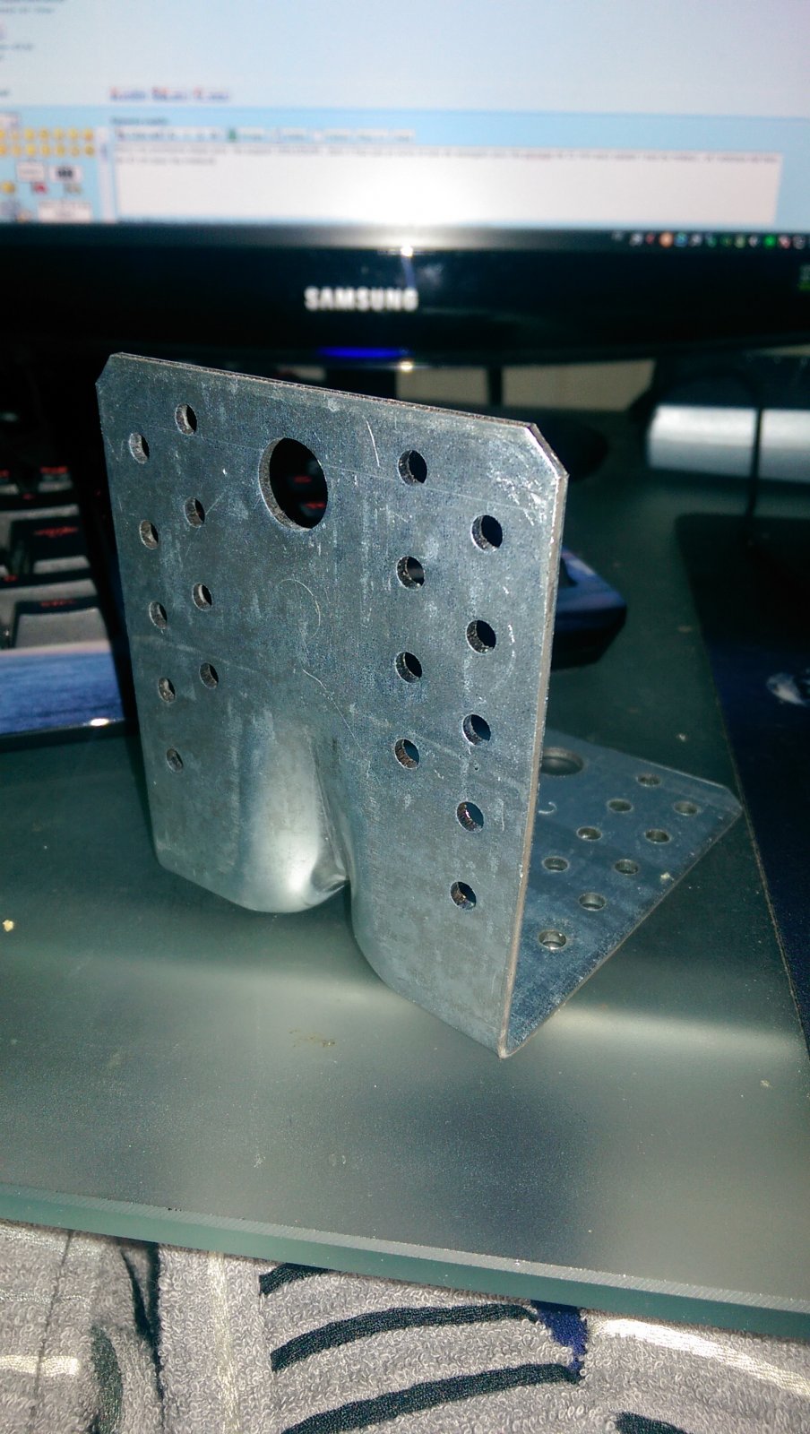

    Donc les moteurs sont des smolka 24v 16Nm 48tours\m je les aient mis sur equerre renforcer mais biensur a revoir la rigiditer en soudant des angles

    3DOF, DC motor
    J ai acheter ce kit complet grace a l idee des menbres du fofo Pcshm (wanegain ,willaupis et d autres) qui fournisse toute la partie moteur et carte a un prix interressant
