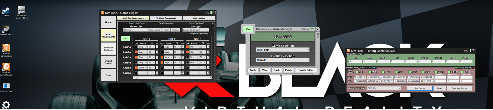

    Hello friends of the community, I am writing this post to see if someone can help me.
    I currently have the T1000 5P simulator from Prosimu, and I have tested it with different games (Project cars 2, GRID, Flight Simulator, etc.)
    But I can't give it movement with the DCS game
    I have both versions of SimTools V3 and V2
    and I have installed the plugins correctly downloaded from the Prosimu Repo
    When the game is run the movement platform is activated, but when it comes to piloting it does not make any movement.
    In the game tuning it is seen that it is sending telemetry but physically it does not make any movement. If anyone knows why this problem occurs or if there is any parameter that I need to configure, I would greatly appreciate the help.

    Can you please post pictures of all of your settings, including the tuning center while DCS is running.

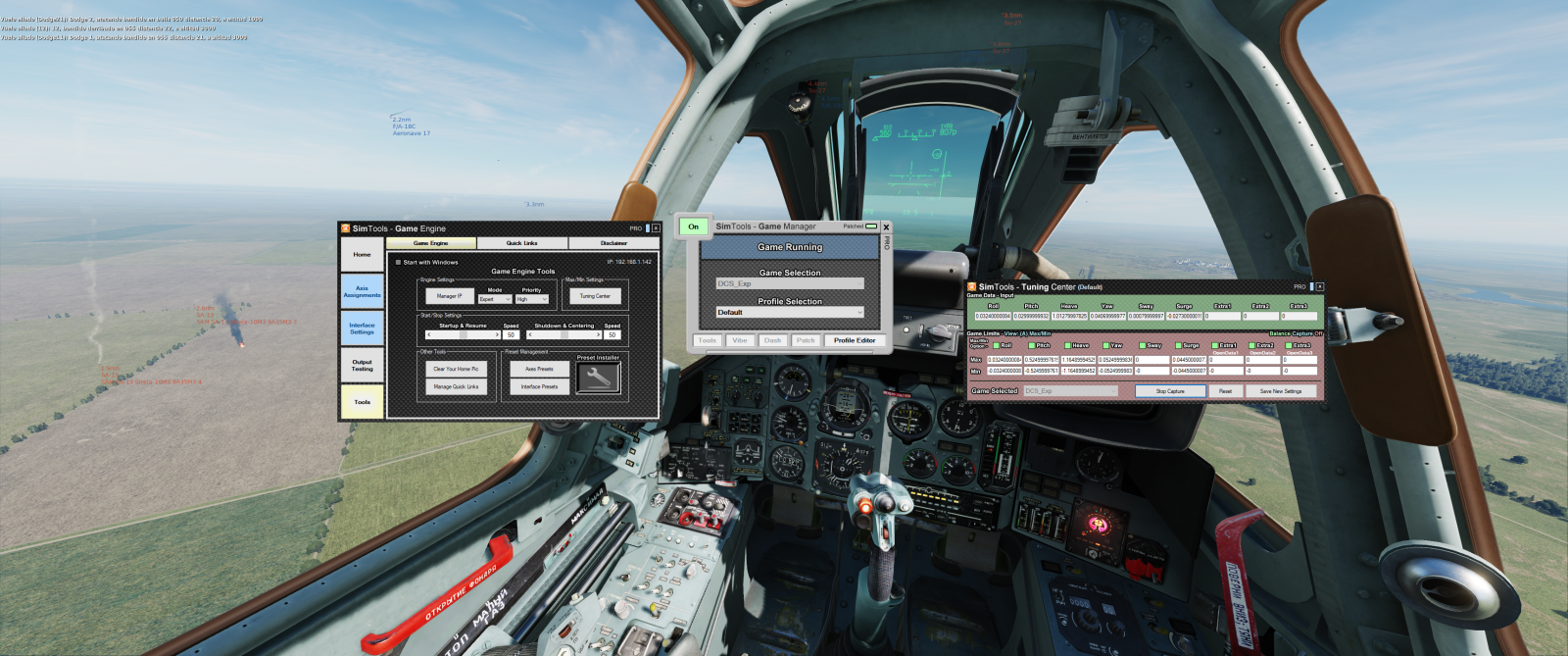

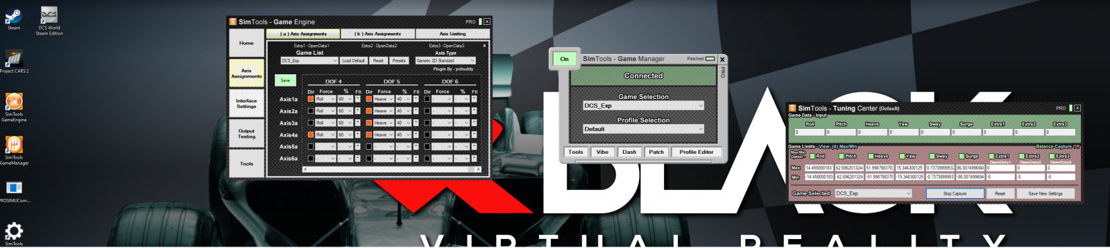

    This is my current configuration with Simtools V2
    It is seen that it is sending parameters to Simtools correctly and that when I capture the Max and Min it also receives parameters

    The Tuning Center in-game shows data in the top line, so this looks to be the need to further refine the profile.
    Please see the tuning tips in the FAQs: https://www.xsimulator.net/community/faq/steps-to-create-a-motion-profile.228/
    Do make sure you Capture the Min/Max values in the Tuning Center and refine from there, initially doing one axis at a time.
