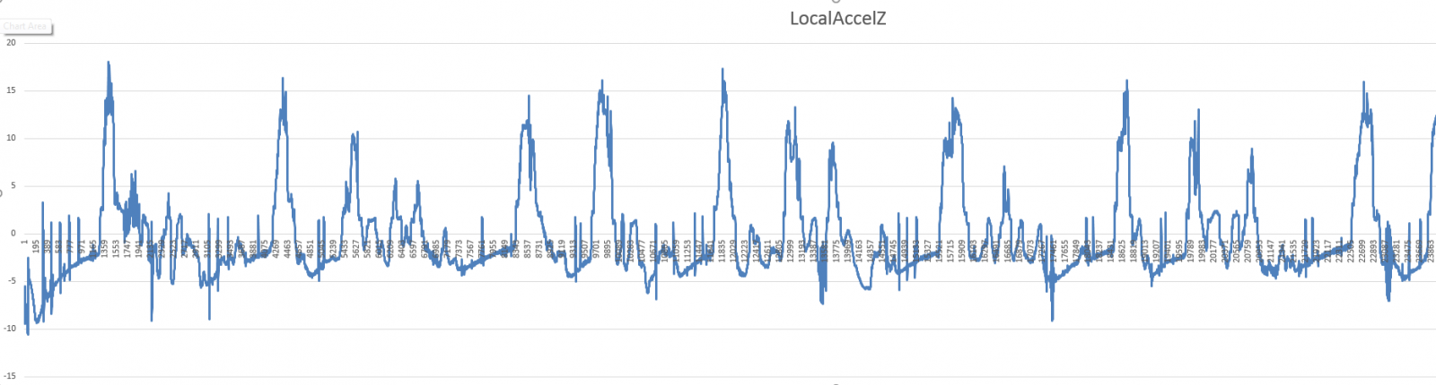

    Here is summary from last discussion with yobuddy. The SimTool simulates z-direction movement (heave) by using game vertical-g data only. Thus, it gives one a instant vertical impact feel. For flight sim this probably good enough. Question would be is this good enough for racing car sim?
    Here is vertical-g data I took from rFactor 2 while I was driving a Corvette GT2 at Silverstone for couple laps:
    SimTool use that for heave.

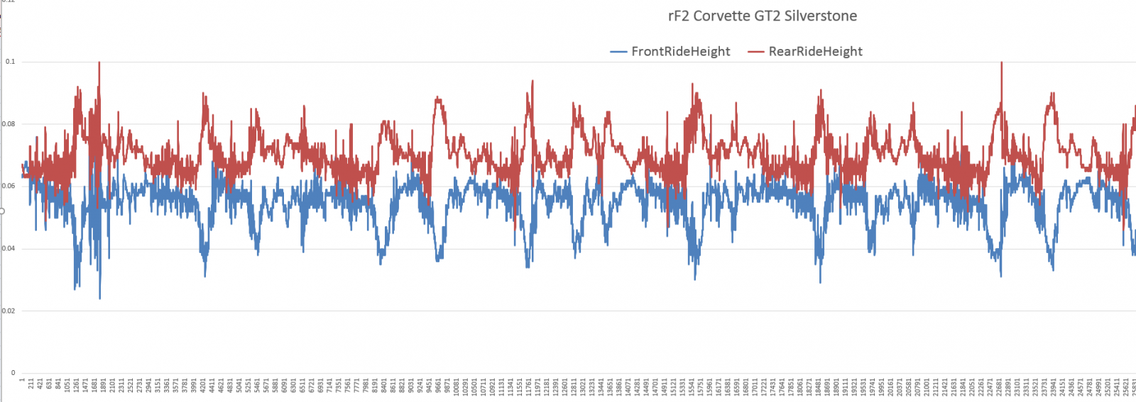

    Now, lets look at this car Chases movement data: front and rear ride heights:
    Now you can see how much bumps and details and vibrations SimTool missed?
    yobuddy suggested one may update the games' plugins to include two extra axises for these. I think it is good idea, just like one for the TL. rF2-Vertical-g-Capture.PNG rF2-RideHeightCapture.PNG
