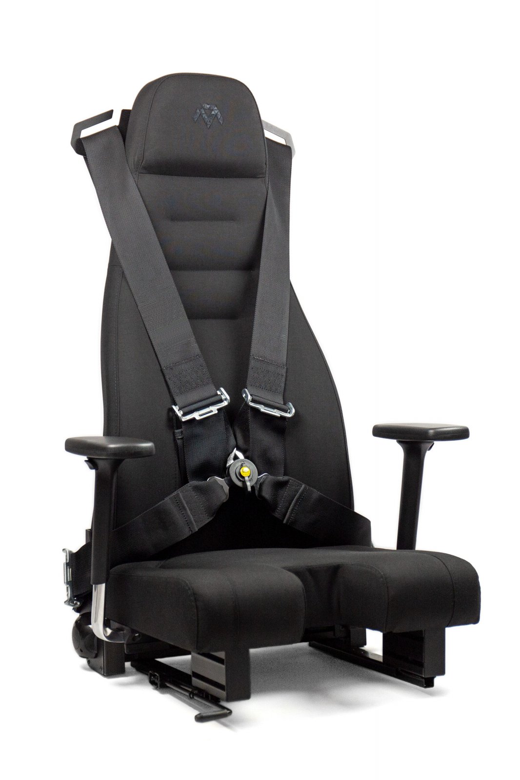

    I want to purchase the QUBIC System QS-H13 Seatmover, I've never used a seat mover or a motion rig, before.
    I want to ask you some questions about. Would it be possible to mount that way, so I can keep my wheelbase + wheel, pedals, joystick and HOTAS, as they are now ?
    I want to keep my desk, I have a lot of stuff there.It's a very heavy and great quality wooden desk.
    70 cm height, 150 cm wide and 75 cm deepth.
    What I want to ask : which kind of seat / frame would you recommend ?
    As an example, I attached here an image. I'd like to have it similar with this, but I don't care about the frame for pedals, joystick , wheel, etc.
    Only the seat, standing on the QUBIC System QS-H13 and in the front, just no frame for wheel, yoke, joystick, pedals, etc. So, as small as possible.
    Please help me with some advices. Thank you so much, in advance.

    As I understand it the QUBIC System QS-H13 Seatmover is a compact design and can be integrated into existing fixed peripheral arrangements: https://qubicsystem.com/product/qs-h13/
    An upside of doing that, as opposed to a full frame arrangements, is that a 2DOF rig will generate additional motion cues in the wrists and ankles when used that way with fixed pedals and wheel.

    The worst thing is to adjust the seat height compared to your desk. The Seat should be as low as possible on the Seatmover! But it doesn´t look like the Seatmover has adjustable Feets.
    The pedals must be securely screwed in place, otherwise you won't be happy.
    I strongly recommend to test an Seatmover beforehand and in best case compare 2DOF and 3DOF systems with each other.
