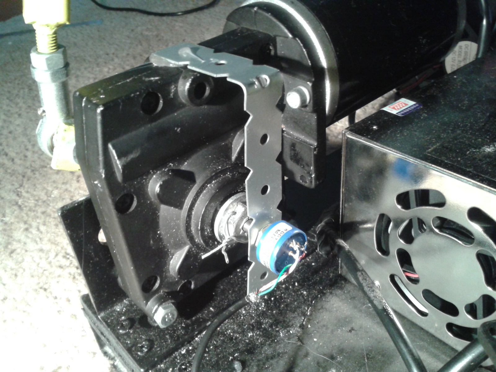

  5. bsft

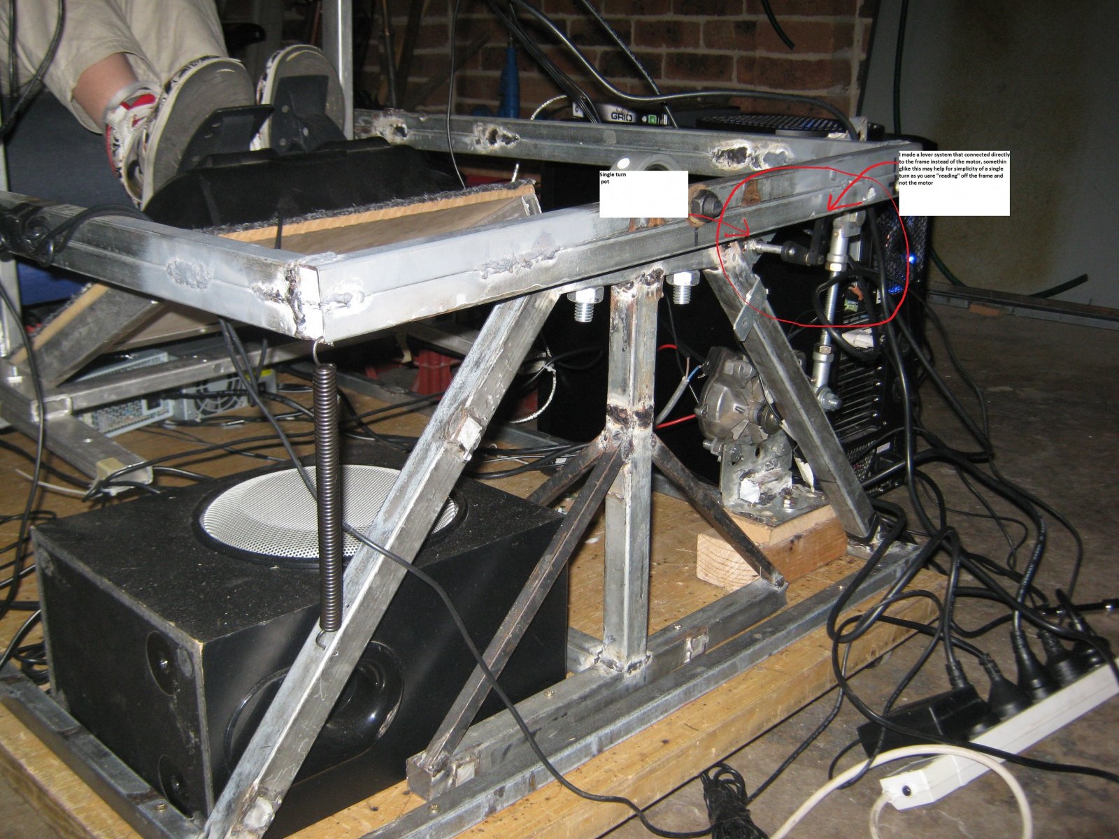

    As for pot mounting, drill a hole in the back of the motor bolt, and slip the pot shaft in, then instead of drilling right through like I did (pain in the butt) tap a 3mm hole in the top part of the hex on the bolt and screw in a 3mm grub screw or bolt to hold the shaft steady.
    As for wipers on a joyrider,
    ignore the information about how I mounted a pot, this is old and back of the motor shaft works better

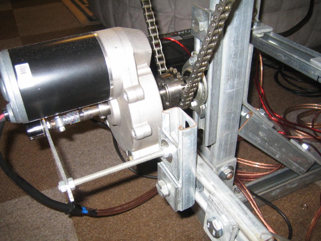

    One more question, I have searched the forums, but not finding much info on how to mount say a bike chain gear to an arbitrary motor shaft. Also, where to find these kinds of items that are fit to mount to motor shafts.... thanks in advance.
    21,194
    148,844Coins
    +10,920 / 54 / -2
  15. SeatTime
    2,573
    28,370Coins
    +2,844 / 39 / -0
    You can do something like this with standard bike parts (from my old sim)
    or purchase a motor with the cog already fitted - similar to what is shown in this link: https://www.motiondynamics.com.au/united-my6812-12v-dc-100w-2750-rpm-electric-motor-chain-en.html
