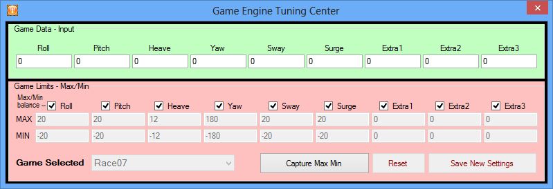

  4. Arcar
    Arcar New Member
    Nov 16, 2013
    821Coins
    Hi again!!!
    Patching seems to be ok! Game detected in GameManager, i've got data in tuning center but when i launch race injection my simulator only moves ( a bit ) when i crash!!! I'm totally noob with Sim Tools but i tried it with Formula Truck 2013 and everything was good.
    Thank you for your fast answer!!!!
    Cedric
  5. value1
    Jan 9, 2011
    2,184
    Zug, Switzerland
    14,751Coins
    +3,322 / 11 / -1
    Right-click on the GameEngine Tray Icon GameEnginTrayIcon.jpg and select Tuning Centre Open TuningCentre.jpg
    A window opens with lots of data:
    Click on Capture Max Min and then on Reset
    Run your game and drive an average round without crashing.
    Save New Settings and Stop Capture
    Now you should have greater movements of your sim.
    NB: The lower the MaxMin values in Tuning Centre Game Limits, the stronger the movements.
    Have a try.
    Thomas
  6. Arcar
    Arcar New Member
    Nov 16, 2013
    821Coins
    GREAT!!!!
    Now that works^^
    Thanks a lot ;)
    So happy to play with SimTools!!!
    Cedric
