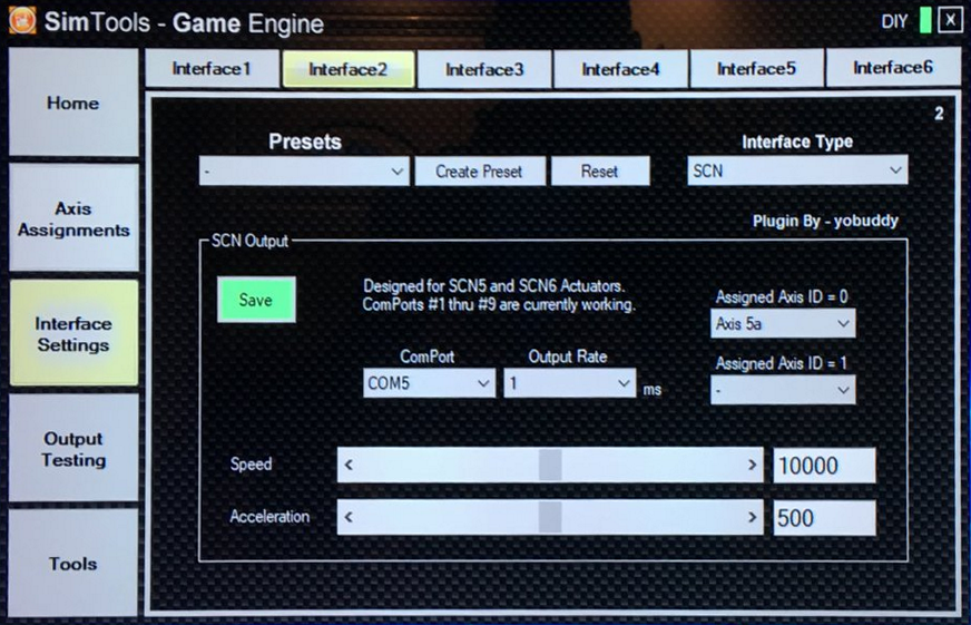

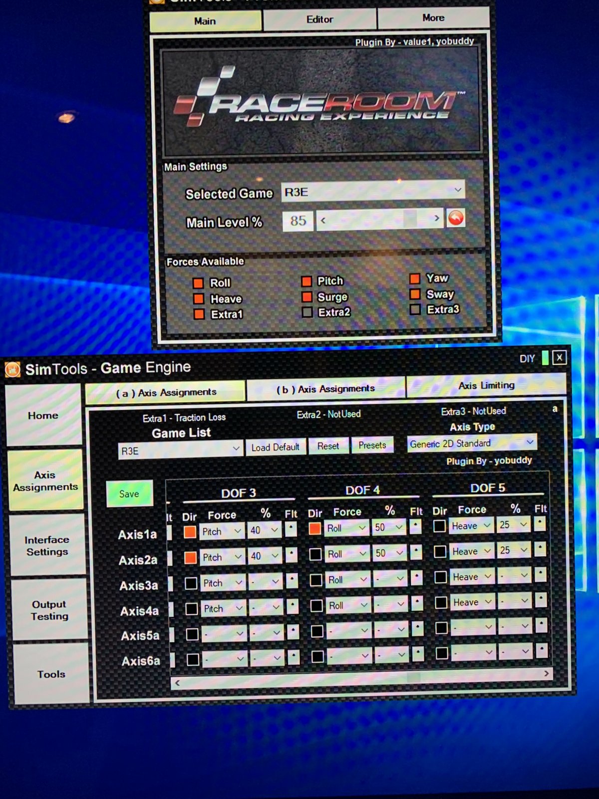

    Hello guys hope someone can help, downloaded plugin for race room when you click the drive button the rig starts going crazy , when you try to drive the car it seems like everything is connected to traction loss ie steering, accelerator, brake , I will try to upload video, it shows the rig moving left to right really fast

    Hello this might sound mad but I’ve never touched tuning center before I’ve only downloaded plugins for ac, ac2,pc2,rf2 and they have all worked straight away. The axis assignment are what was default is and all outher games are the same and work really well,race room is the first game that has done this , I am complete novice at this so any help would be great. DAVE

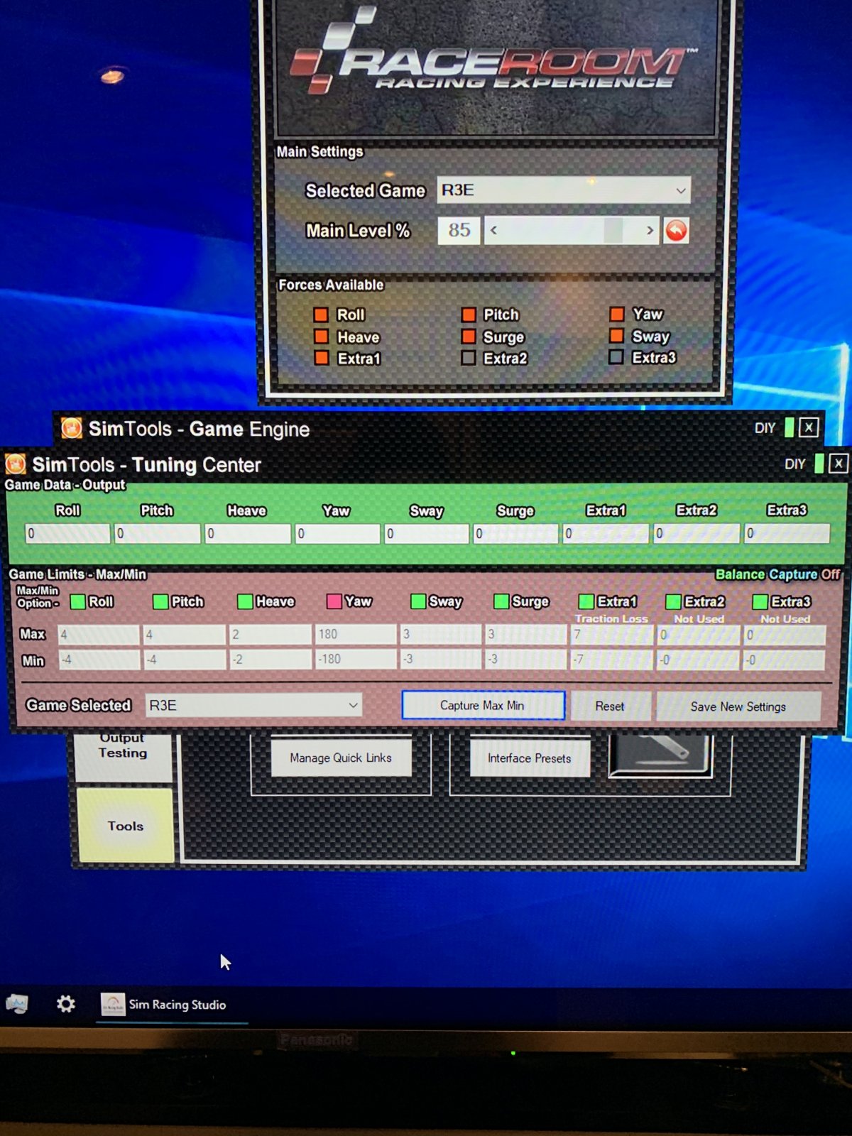

    Raceroom issue, worked out how to use tuning center did a capture in min and max saved it and yes when I turned traction loss on the rig stopped shaking and was useable, I am changing settings in axis assignment but with low settings there is only small movement it’s made better with the main power turned up to 100%. With the outher games the axis assignment is a lot higher but I run main power at 80% that gives a good feeling of movement.i dont understand why my outher games I never needed to touch tuning center they just worked immediately. Thank you for all your great advice

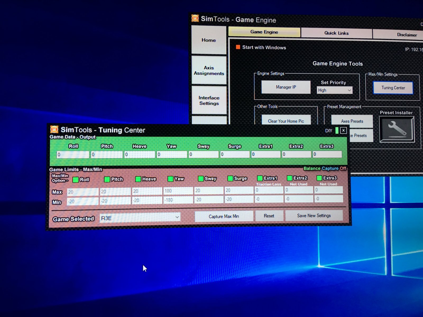

    It is far more likely that your motion profile is the issue, here are the steps to create and refine a motion profile: https://www.xsimulator.net/community/faq/steps-to-create-a-motion-profile.228/

    Instead under Axis Assignments temporarily turn Axis Limiting right down, the as per the earlier link do a capture of Max/Min values in the Tuning Center for RRE. If you have sensible Axis Allocations that should settle things down enough to be able to raise Axis Limiting again and then tweak the profile from there, doing one axis at a time.

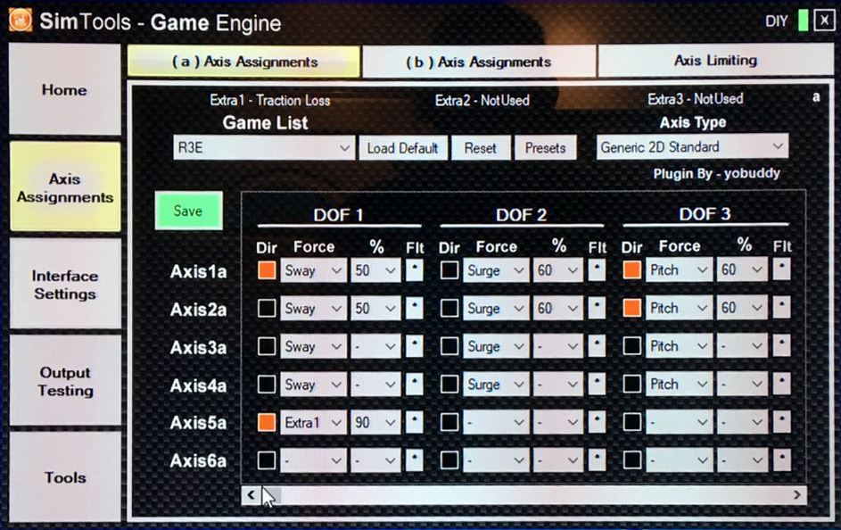

    Traction loss on mine is on 90. So I realy dont understand why it is moving left to right to left .... imidently when past the menu. A step by step for dummys would be great.:grinhug:

    90 in axis assignment sounds ok, but in tunning center I think it should be 7 to -7 . I’m not near mr rig at the moment but I will post some pictures of my settings for raceroom

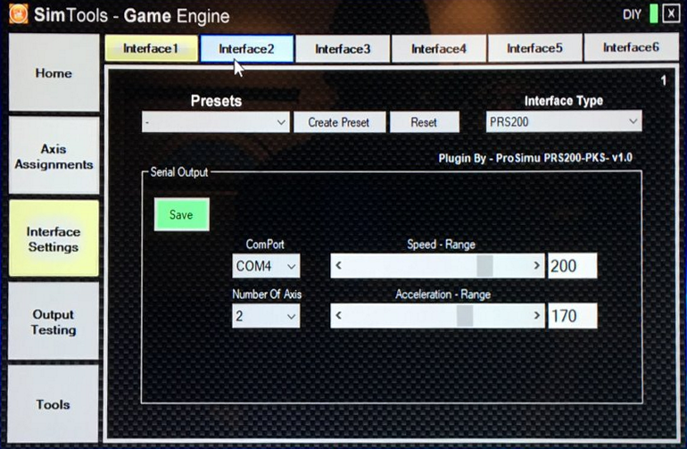

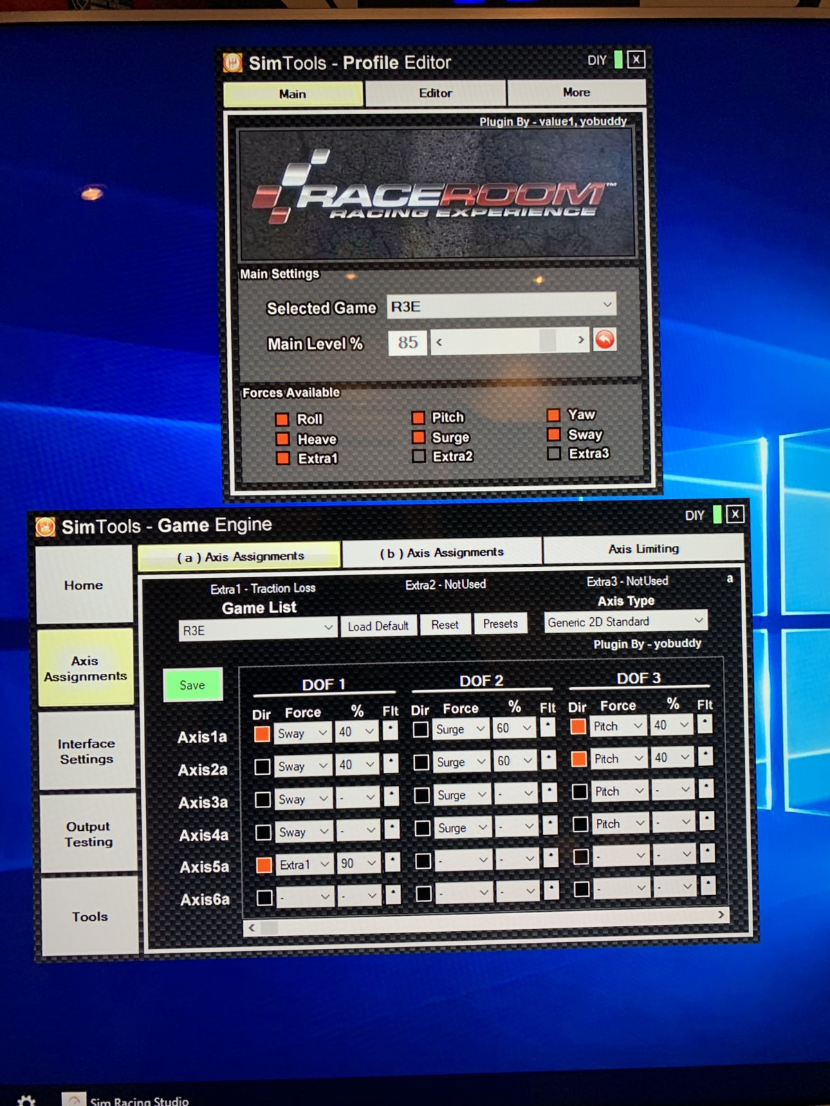

  19. MADERN
    MADERN Member Gold Contributor
    Jul 19, 2018
    65
    Decorater
    538Coins
    +18 / 0 / -0
    SCN5, SCN6, Motion platform, 4DOF

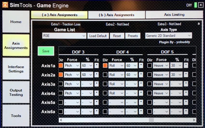

    Ok here are my settings for raceroom, I am only a beginner myself and are regularly tweaking my settings, hope these pictures help.Dave
  20. Einar
    Einar New Member
    Dec 29, 2018
    7
    182Coins
    Motion platform
    Thank you, now I was able to run Raceroom.hug:
