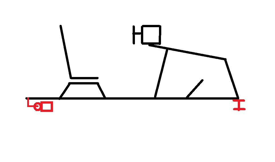

    Would this setup work if I only wanted a 100mm of platform travel from the rear ?
    AOOMTFOI.jpg There are a few reasons for wanting this setup - cost is one of them, hence the DC motor drawn, but with just 2 motors it might be feasible (cost wise) to use linear actuators (something like this : https://www.simxperience.com/shop/sx-4000-150-3ft-150mm-scn6-motion-starter-kit-37?category=9#attr= ?) if that would be a way better option.

    I presume you mean a design with the pivot at the very front and motors at the rear.
    If so that is not likely to be cost effective, compared to a traditional pivot under the user, as your design would require far more powerful motors.
    Have a play with SimCalc to help get your head around the tradeoffs between design Vs physics between those two design options: https://www.xsimulator.net/communit...e-linear-speed-and-forces-of-your-design.270/

    Yes
    Yes I realise that but it has other benefits for my situation.
    I was also hoping that not requiring much movement would help ??
    Will use that to see how much power I need - I do understand the differences but have my reasons for not wanting the usual pivoting setup

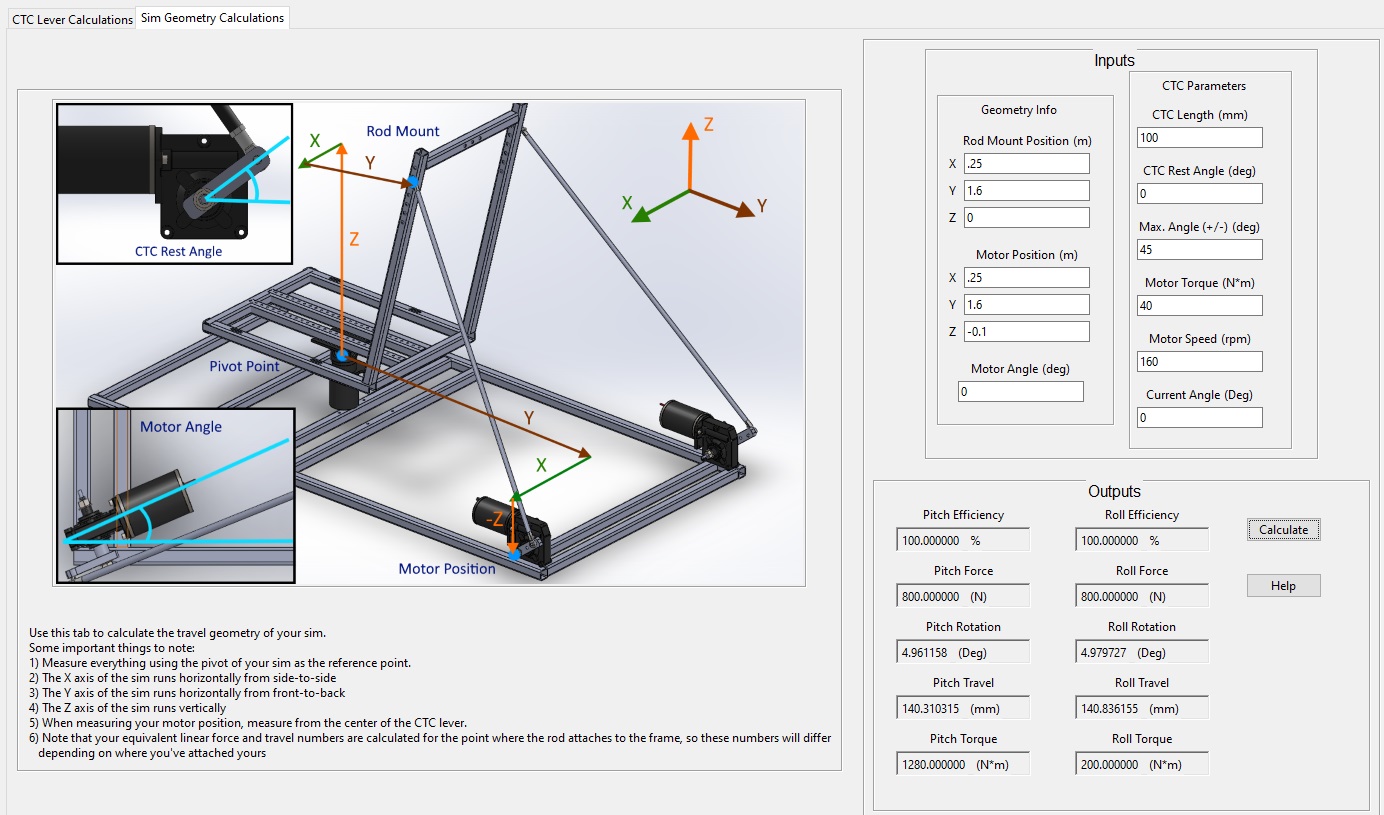

    First simcalc attempt :
    Does that look right for my inputs ?
    The pivot will be right at the front and at the same level as the motors.
    The rods will be little short ones basically ending where the X and -Z lines are in the drawing.
    And how do I read the outputs ?
    I read the Help box and it would seem to me that it is indeed feasible ??
    20,862
    147,009Coins
    +10,845 / 53 / -2
    Marginally, as torque efficiency of levers is most effective at right angles and drops off rapidly after about 38 degrees, so the less movement from zero the more efficient torque utilisation.
    Apologies but SimCalc will give a false indication here, as it presumes the mass is evenly located over the pivot, like a seesaw, where in your case all the mass is behind the pivot, like a wheelbarrow:

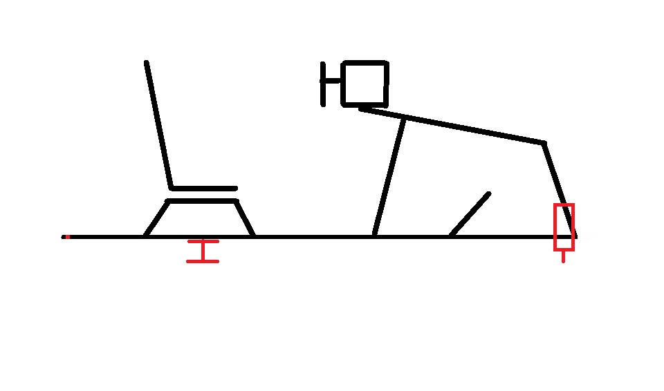

    How about this with either DC Motors or SCN5 or 6 actuators at the foot. Given that I only want 100mm of travel at the motor end I assume this would be a better solution ?
    If so DC motors or linear actuators ? Personally would prefer linear if they will work, but scared off by the cost :(

    Yes, that design would allow you to properly balance the rig.
