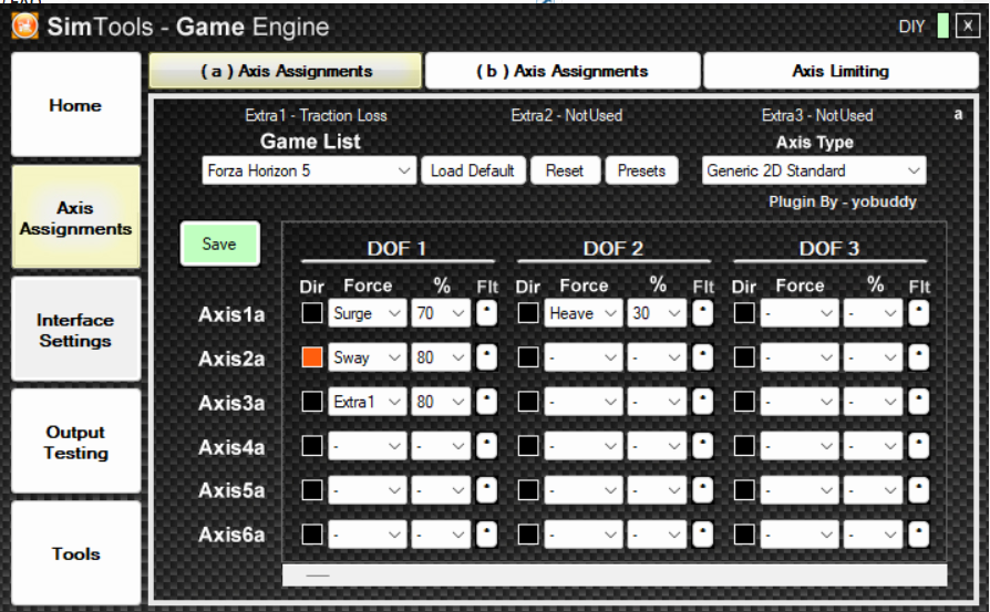

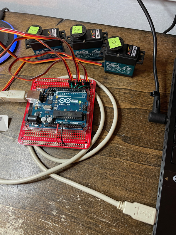

    Hi All, I tried to recreate this youtube:
    Here is my test rig, using pin 3, 5 and 6. I already update the Arduino code accordingly.
    Here is the Axis Assignment:
    Here is the Interface Setting:

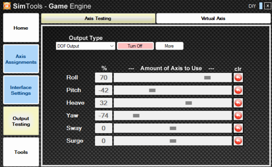

    I can get the motors move on the Output Testing for Roll, Pitch, Heave and Sway
    I use a keyboard to play for now.
    When I am driving in the Forza Horizon 5, I do not get the motor move at all.
    Would love to hear any hint what I do wrong here. I appreciate it.

    I figured out the issue: I forgot to set the Telemetry and the IP/Port number on the Forza game!
    It works now.
