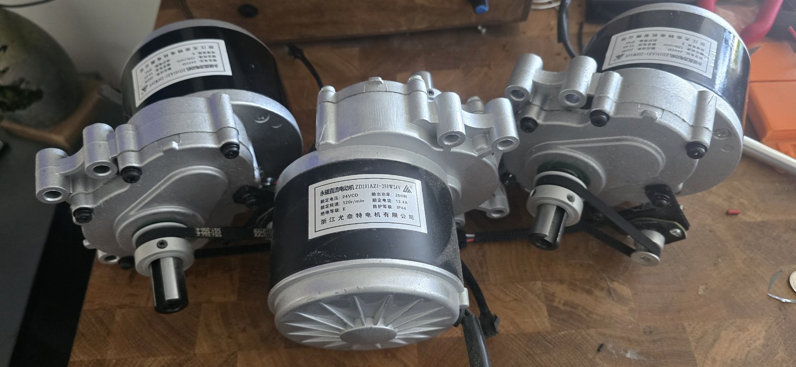

    Hello All, And thanks in Advance… I think it’s time to upgrade my Rig or build a new one.. First ideas was to start fresh and Make a whole new 3DOF so I can keep racing during the build… But I also know that my first tries are never my last try…
    Soo, I think I want to build a platform to just turn my current rig into a 1DOF for traction loss.. this will keep me amused and busy while I build my 3DOF 0ver time.. also worried the 3DO F will shake too much for my upstairs apartment living. I am hoping the traction loss won’t be as bad…. lol

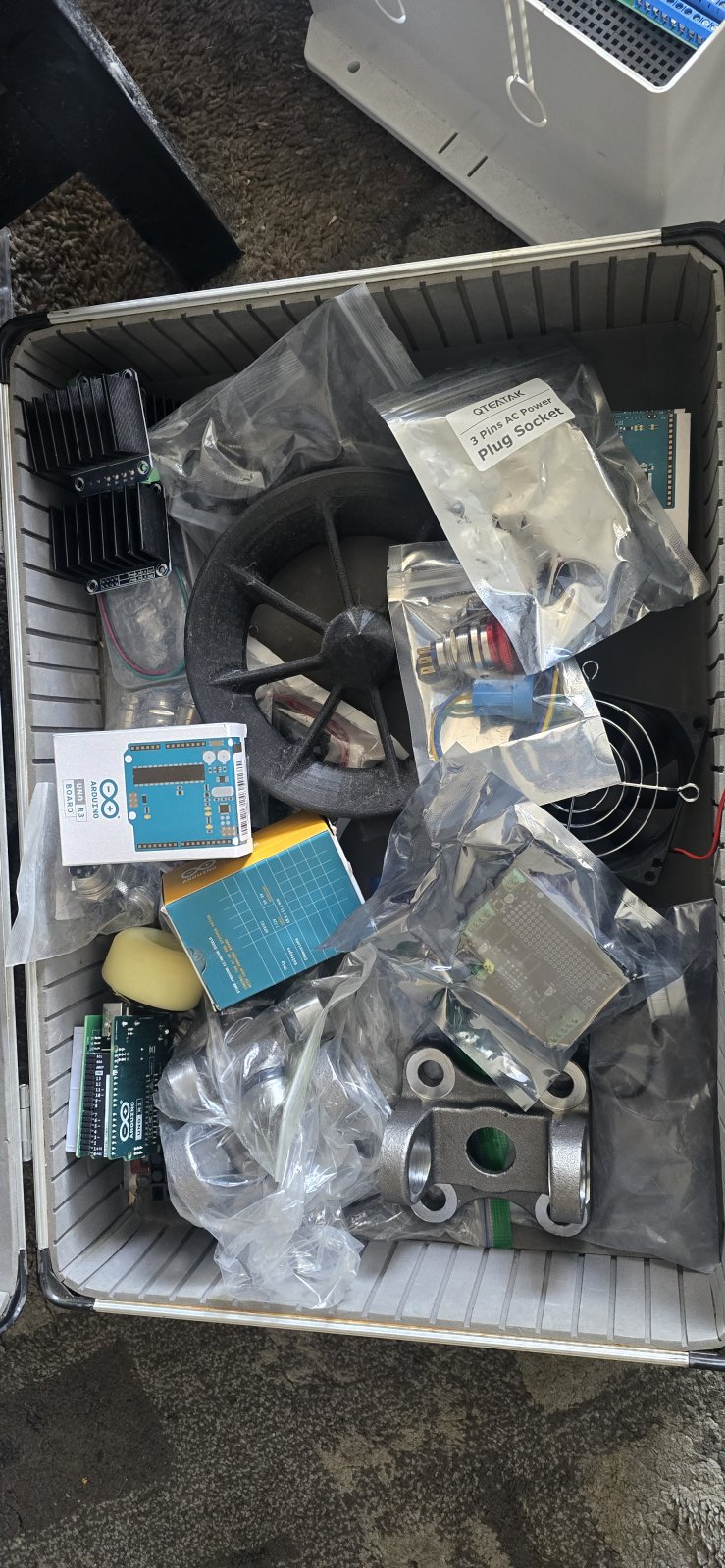

    I have been collecting parts for some time and believe I have enough to start..

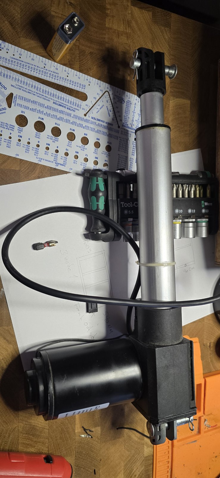

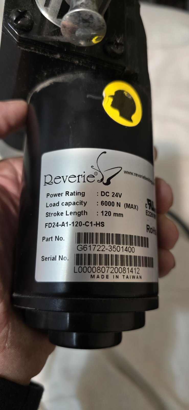

    I will be downloading SIM tools and SIM Calculator. I just recently lost my laptop, so have been hesitant to put it on the simulator.. but my first question is.. does anyone think this bed mattress actuator would be better for traction loss the the wheelchair motors..
    Actuator is 24v
    Load Capacity 6000n
    Stroke 120mm
    Wheelchair motors are the 24v
    250w
    120r/min
    They were all that were available to me when I ordered, but in hindsight, I should’ve just waited to find 75rpm because it was a while ago… I was having trouble finding good CAD files for the arms for the size motor.. Anyone know the center to center distance I should use for an arm? I think I read these motors will work. I just have to shorten the arm?!

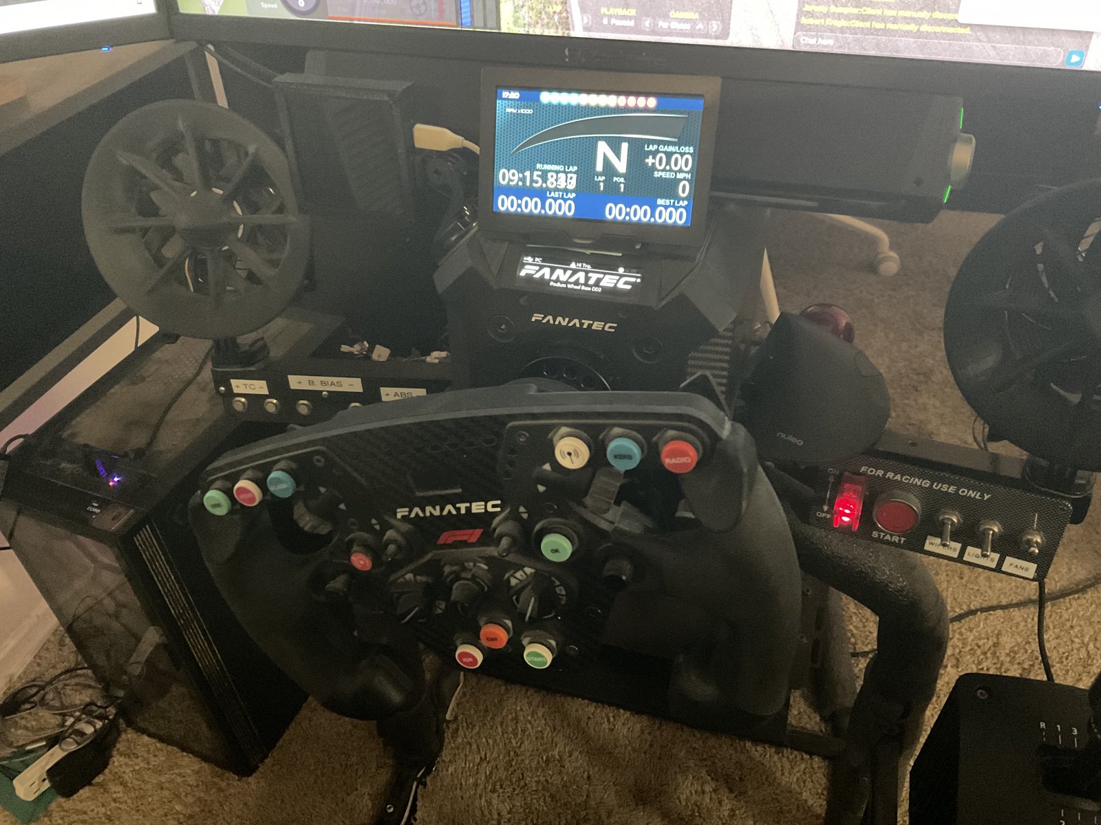

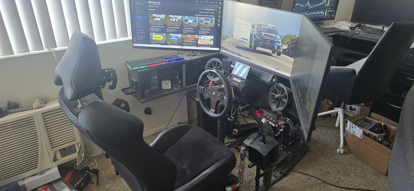

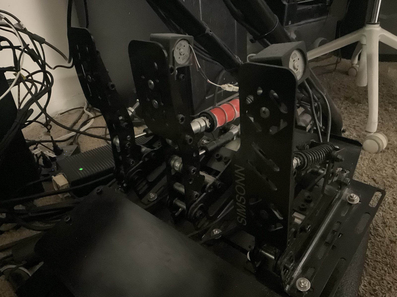

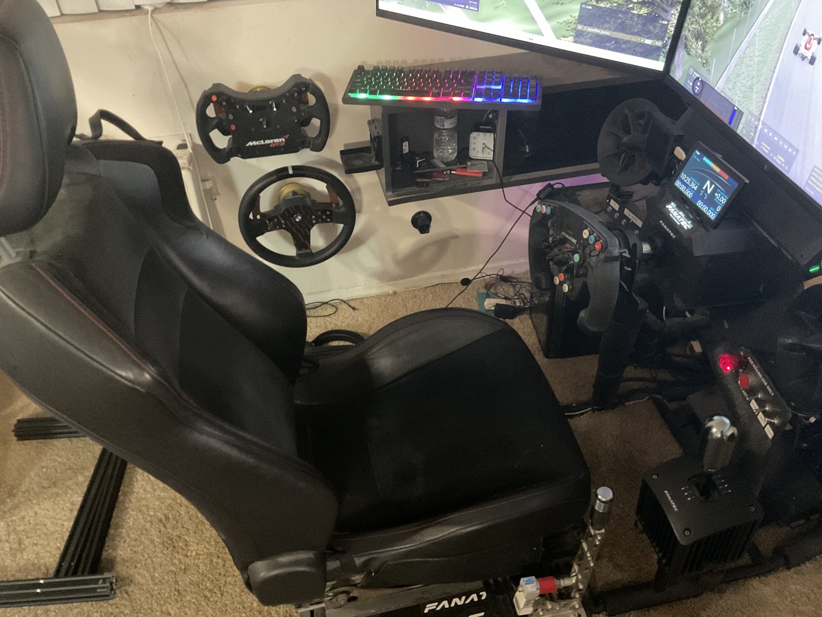

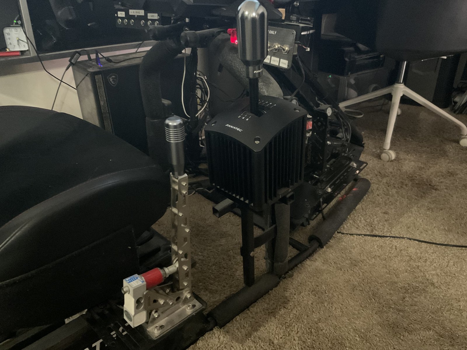

    Here is my current Rig… the ideas to make a platform out of aluminum extrusion rail, and a pivot base for this to rest on top of..

    ‘Thanks for the link! Yeah I kinda figured they wouldn’t work.. I was crossing my fingers for a free Better option than the 120 r/pm Wheelchair motors… But All good… Will research a bit more and use the 250 watt, 24v 120rpm wheelchair motors..

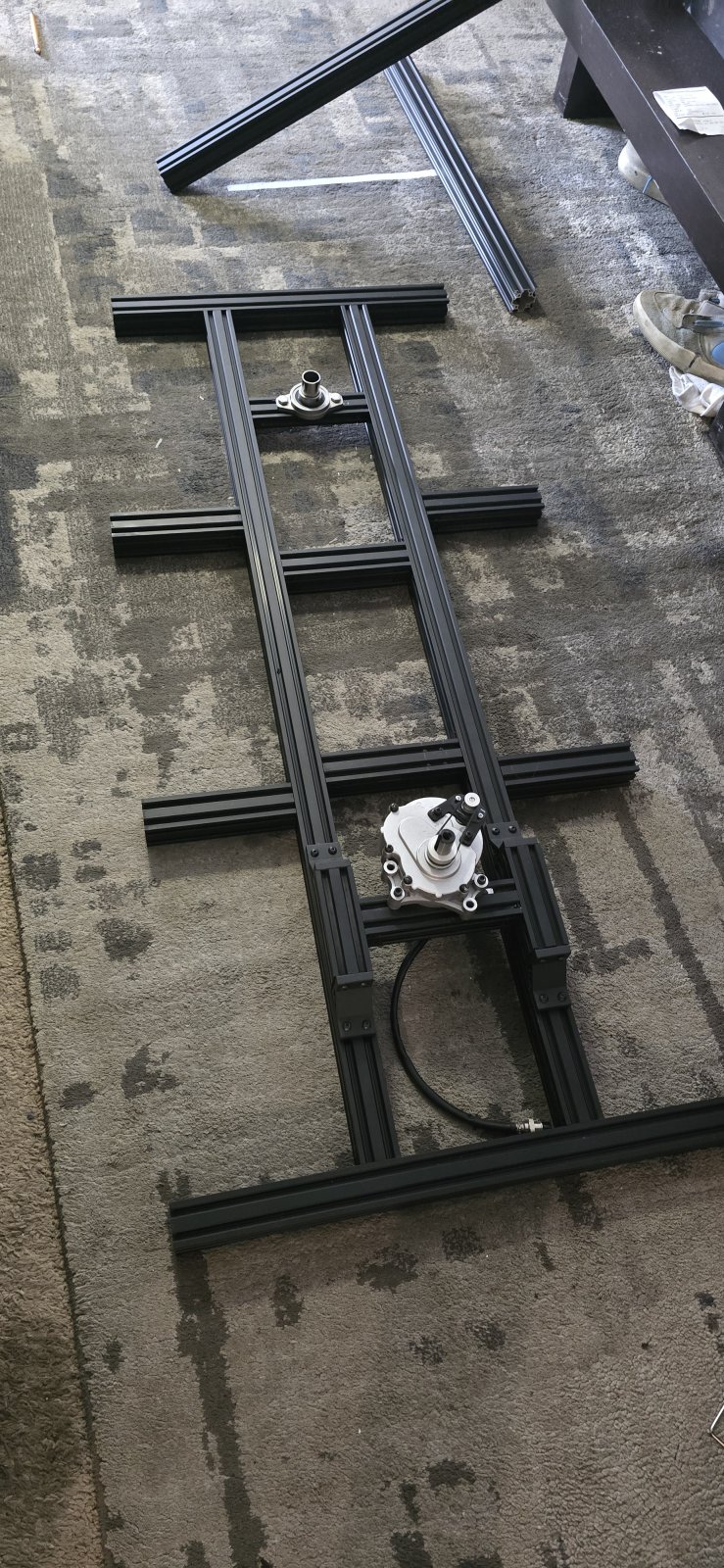

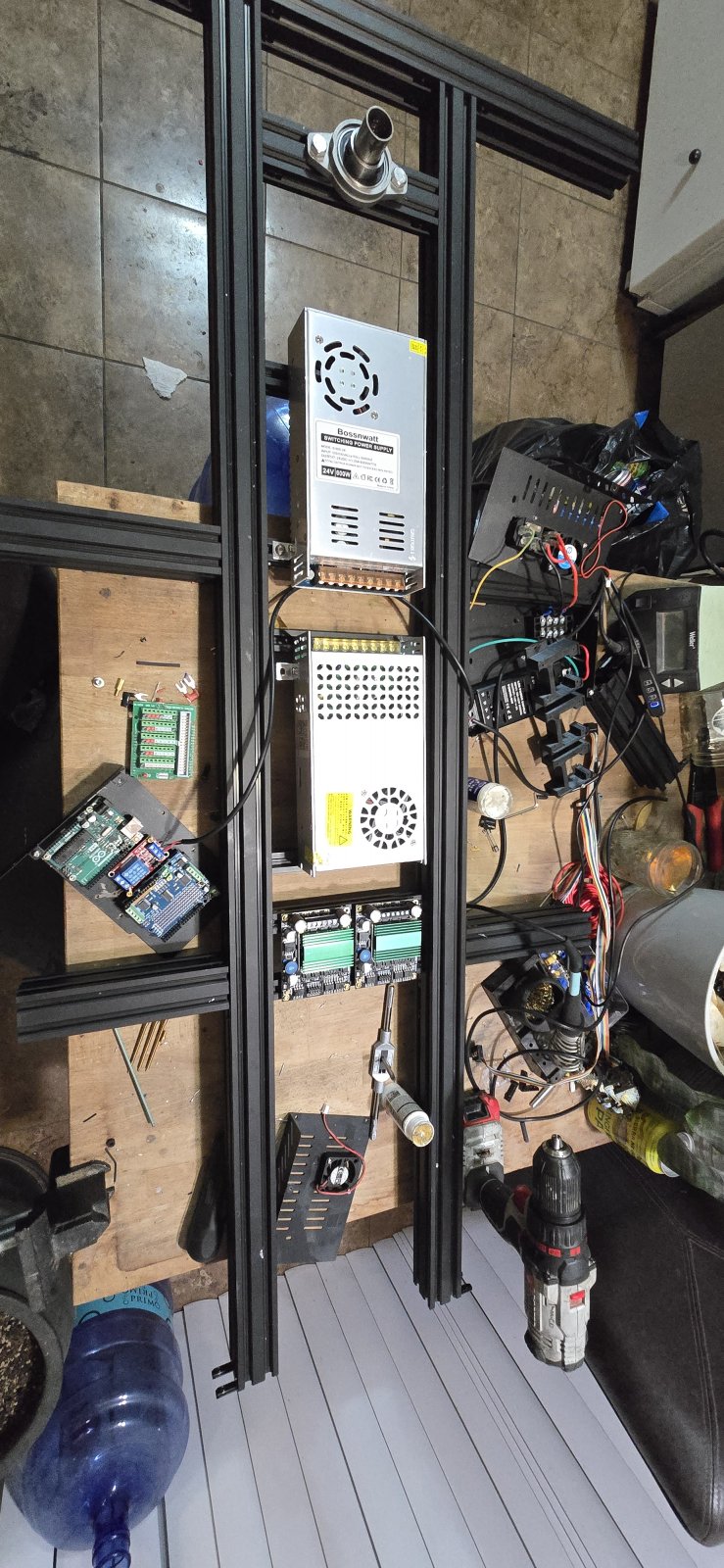

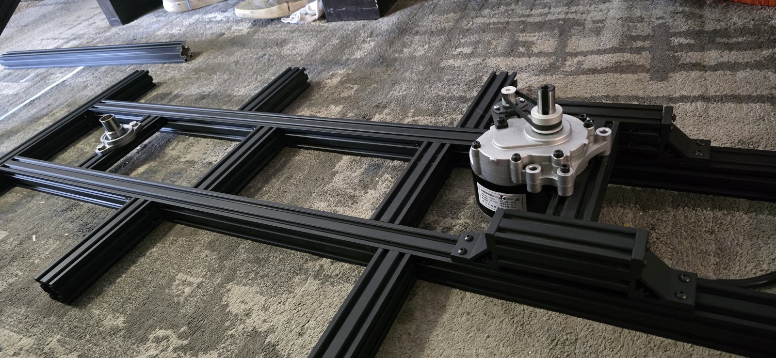

    Got a little impatient and started the extrusion rail base... I used V channel because I was using some spare parts from a 3D printer..
    But next question/Poll..
    Fixed Monitors or should the monitor move with the rig?

    Thanks, Stationary Monitor /s for Racing and but For Flight it might be useful... I do feel it will be hard on Equipment as it is a 3 screen set up im trying to modify... Thanks for the link!

    There is also a degree of personal preference.
    That said do keep in mind our rigs can generate very rapid and repeatable shocks, which screens are not really made for.

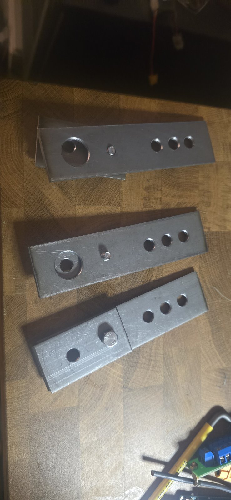

    20260114_215058.jpg 20260114_213021.jpg I ordered a stand for the monitors from Ali Expres... Having issues with my Ali Express delivery on 1 of the 100 amp motor controllers I ordered.. But getting deep now...
    In Depth Thread coming Soon!

    Sounds like a solid plan, and honestly for traction loss the wheelchair motors will be a much better fit than the mattress actuator—shorter arms with those 120 RPM motors should still work fine, and you can tune the motion in SimTools to keep things apartment-friendly while you build toward the full 3DOF.
