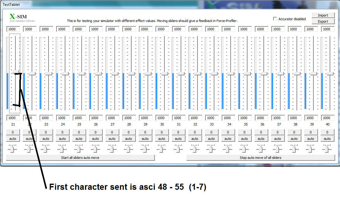

    I am receiving Serial numbers with my arduino now. ANd i have a LCD attached to print out the numbers.
    Im getting some funky Responses.. it seems to be perfect when i use the testplugin above the blue line, but when I go under it it gives me funky results (i think the results should be between 0-255) but they seem to be all over the shop..
    I decided to test the first character that was being sent and it was anything from ascii 48 - 55 (it should only be character 0,1,2 in my mind)
    are my results expected?

    ok in ya math calc have you selected to use positive values or both positive and negative.
    Another is a timing issue with xsim, i use 20ms instead of 33ms as default in uso, plus as you increase the numberof values ya need to increase the timing allowance specially when using the lcd as for the inbuilt delay in lcd itself.

    Some how fixed it.. Not sure what i did. I didnt think i had split negative and postive values, but its workign now :)

    	unsigned  char endByte = USART_Receive();
    	if (endByte == 'E')
    		//SUCESS
    		axis1.position = (firstByte << 8) | secondByte;
    		axis2.position = (thirdByte << 8) | forthByte;
    		axis3.position = (fithByte << 8) | sixthByte;
    		char axis1Printout[12];
    		char axis2Printout[12];
    		char axis3Printout[12];
    		sprintf(axis1Printout,%u , axis1.position);
    		sprintf(axis2Printout,%u , axis2.position);
    		//sprintf(axis3Printout,%u , axis3.position);
    		char output[40] = ;
    		strcat(output, axis1Printout);
    		strcat(output, axis2Printout);
    		//strcat(output, axis3Printout);
    		lcd_clrscr();     /* clear the screen*/
    		lcd_puts(axis1Printout);
  18. jyrki.j.koivisto
    jyrki.j.koivisto New Member
    Aug 30, 2010
    85
    Finland
    314Coins
    No, no, no, no....
    There is no need for delays in ISR, the interrupt routine gets called when ever there is something to be read from the UART. I'm not sure if Atmel has some sort of FIFO on UART but if not there is only one char to receive.
  19. jyrki.j.koivisto
    Aug 30, 2010
    85
    Finland
    314Coins
    I don't think there will be a need for a ring buffer with this sort of thing, it would only be needed if the transmitted data would be in more complex packet with checksums and such.
    One does not do ANYTHING else in the ISR routine than take the char out of UART (plus the logic for this simple packet system), no LCD driving while in the interrupt and no delays!
    First thing in the interrupt you should check if you have previously received the start of packet char, if not then check if the new char is the start of packet (R in your case) if it is then set a flag that a start of packet has been received and exit the interrupt. If the start of packet has been received then fill in the data, you get only one char, next time fill one char more until end of packet is received or you know that there will be no more data coming then clear the start of packet flag. The end of packet char can be disgarded and not used at all if you know exactly how much data there will be.
    Edit: While trying to sort out how I'm going to make my FD301 clone, I was wondering if there would be any interest in 2-3 axis controller board that drives external bridge board? I'm thinking to use Microchips dspic30f4012 as I have bunch of them laying around, It would most probably be smd board.
  20. stowaway
    stowaway New Member
    Mar 16, 2009
    213
    Gold Coast - Australia
    1Coins
    Thanks guys, Im learning as I go so its a huge help.
    I understand about how im using the Interrupts wrong and I have a better idea of how to proceed :)
    huge help
    ps- the LCD is just in there for debugging purposes. but I will move it out of the interrupt routine and just read from UART.
