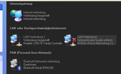

    Today I installed the new USB LAN Adapter: "normal" internet connection works again (screenshot attached as LAN2, onboard LAN is not active). I use the USB LAN adapter connection loading up this text.
    Starting registration.exe shows the window again: no internet connection
    I uninstalled/reinstalled again: .net 4.0, simtools 2.2
    I entered https://simtools.us as safe site in internet options.
    Firewall is down. Nothing helped so far.
    Best regards, Harald

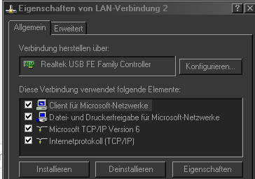

    ...also tried to install IPv6 to winxp: installation worked, but still the same problem.

    Personally I would remove ip6 all together.
    Its not needed and only causes problems I'm my experience.
    I would also disable the PAN network just to be sure.

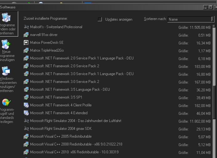

    I suspect a Windows XP compatibility problem with Microsoft.net or Network drivers, wrong internet settings or a registry issue. Other .exe files (like installing .net files) show immediate connection with the internet. Windows 7 or 8.1 works perfectly which does not help because my flightsim software (steadily grown during the last 8 years) only works under Windows XP.
    Can you identify any Microsoft.net issues on the screenshot attached?
