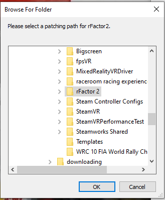

    hi everyone ,, i had everything configured and working with motion from simtools last week ..then my pc crashed had to rebuild and reinstall all my work .. i have reinstalled simtools steam all the patches ran threw all the nesseasry configuration ... but im not getting the game patched please help me i was winnig all the way software and rig was working great .;.........im not really great with posting threads
    i have created the plugins folder in my bin32 and bin64 in steam but it does noy show up in rf2 pluggins
    please Gents help me

    Can you please post the full path you have created for the RF2 bin32 folder, just so we know what it is, as many including myself don't use the default location.

    I'm still having the same issue where the path I use the D drive which is the second HDD in my pc I've made the bin 32 and bin 64 to patch the sim and it never works. It always comes up as not a valid file location to patch
    Ive been trying for months now and ive pretty much given up being able to use motion in rfactor any help woulb be great

    What is the full file path you are patching to?

    Evan don't give up ... try a reinstall of simtools and steam use the uploader and don't unzip the plugins

    Not sure if people are making this mistake.
    Once you have created the plugin folder in your Bin32 folder you must not patch the game by telling simtools to patch the bin32 or pugin folder it must be the root folder
