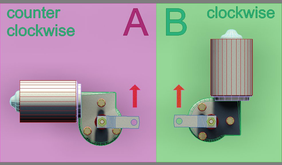

    The image here is to show why in the Universal Motion Profile Manual I say to test the inverse axis option. The motion direction depends on the position the motors are mounted.
