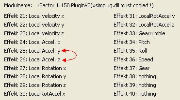

    @Sirononame
    Please swap effect description 25 and 26 in the rfactor plugin!
    Regards
  2. egoexpress
    egoexpress Active Member
    Dec 13, 2006
    3,839
    Germany - Frankfurt/M
    421Coins
    +10 / 1 / -0
    Re: Rfactor effects 25 and 26 swapped!
    The ouput values of effect 25 and 26 do not match the description. They are swapped.
    longitudal is vertical, and vertical is longitudal.
    Please switch them.
    Regards
    Christian

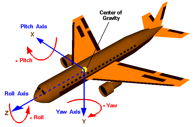

    Weiß nicht wie ich die Rotationsachsen in Rfactor prüfen soll. wie ein Flugzeug kann man die Autos nicht drehen.
    Aber analog zu oben:
    27 - pitch (Nick) - X
    28 - yaw (Gier) - Y
    29 - roll (Roll) - Z
    Gruss

    My apologies to having caused some unnecessary headache!
    The effect descriptions for 25 and 26 have been right before. There was no swapping at all. Just in my mind.
    I was used from Profiler1 to assign the throttle/brake effects to the Y-axis, but that is wrong, concerning a 3 dimensional coordinate system.
    Throttle/brake are movements on the Z-axis of course.
    After sketching the descripitons above, I noticed the error in reasoning.
    However, here is an improved list with better effect descriptions, so it should be easier to find the proper effects:
    Translational axes:
    21 - X - speed left/right
    22 - Y - speed up/down
    23 - Z - speed forward/backward
    24 - X - lateral g-forces - curves
    25 - Y - vertical g-forces - bumps, track-surface
    26 - Z - longitudal g-forces throttle/brake
    Rotational axes:
    27 - X - pitch
    28 - Y - yaw
    29 - Z - roll
    30 - X - pitch accelleration
    31 - Y - yaw accelleration
    32 - Z - roll accelleration
    Regards
    Christian

    I have verified that it would match with this list here:
    But it does NOT match with the X-Sim Plugin list order.
    I told you guys before...
    So you should use the old rfactor plugin, and not the latest, posted on the last page.
    post11588.html#p11588
    I will delete the download link for that new/wrong plugin now, and close this thread soon, as it may lead into even more trouble.
    Once again. The old plugin was OK the new one is not OK!
    Regards
    Christian
