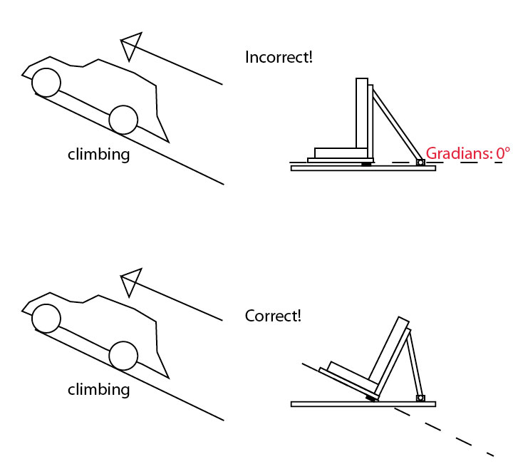

    how can I give more realism to climb?
  11. XRiccardo
    XRiccardo New Member
    Nov 14, 2008
    61
    1Coins
    I apologize if I insist.
    how do I get the correct effect? Someone can help me?
    enclosed a picture for me to understand better:
    Thanks!

    It is not recommended to use car position/angle data to feed the simforcegt.
    You rather should use the accelleration (g-force) values (like in this profile), as this gives much more sensation and immersion.
    Just imagine to make a full stop braking in your real car. You will be pressed to the steering wheel. And when accellerating, your body gets pushed away from the wheel slightly, if your car has enough hp :D
    Using angle data is just recommended for simulators with more movement range.
    For general questions like this one rather open a new thread please.
