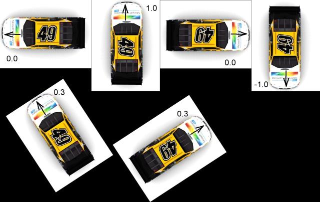

  14. Kada_CZ
    Kada_CZ New Member
    Aug 12, 2008
    Brno
    0Coins
    Position of the car (Floats): X -- offset 0xEF8, Y -- offset 0xEFC, Z -- offset 0xF00. These offsets are relative to the beginning of the car structure (found at double pointer 0x0165FC68, as described in previous posts).
    Unfortunately I didn't found (yet :) ) yaw, pitch, roll.
  15. Kada_CZ
    Kada_CZ New Member
    Aug 12, 2008
    Brno
    0Coins
    After some digging I found sinus of the yaw. Actually, I discover, that the value is the sinus of the angle by writing this post :). I painted a really really nice picture, and I was going to ask you for your help, how this value could work. But after look at the whole picture, I was enlightened. I'm posting this only because I don't want to put the image to the trash :).
    I'm sure that the cosinus of the yaw, and pitch&roll are somewhere near. Now I know, what should I look for. I'll post these offsets later.
