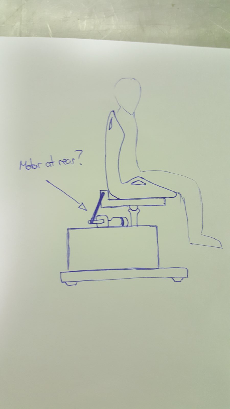

    Hi guys. New to the forums but have been lurking for awhile.
    Im now wanting to dig into a 2dof build with it being used for rollercoaster simulation only with a htc vive or oculus rift.
    Here i have a basic drawing of my idea and am wanting some advice on my design from all you experts!
    So basically looking at my design im wanting to get the most angle out of the seat as possible to really feel like your going down and up the dips of a coaster. To do that i have placed the seat quite high off the platform around 20cm. The users feet wont touch the ground and will also hang over the front for the dangling feeling. I was thinking of using the motion dynamics worm drive motors but looking at there 50:1 or 60:1 gear ratio for the extra torque needed to pull the seat back up from large angles of descent and ascent im looking at getting. To compensate with the lower rpm of the higher torque gears i would have a longer lever arm at around 15cm?
    Also i was wondering with my motor position almost close to horizontal to shoulder height will that also help with less stress pushing and pulling the seat with a person on it? Or would the typical 15 degree angle most people use do the exact same thing?
    Please let me know your thoughts and ideas. Thanks guys!

    Hi @Cale good luck with your build, I think you will lose out on sway and roll motions with the motors so high.

    +1 with @Daguru the engines will give their best performance by being lower, or even under the seat if they are sufficiently powerful.
    What motorization do you have?

    With such motors the best implantation is the motors under the seat, placed at 90 ° from each other.
    Two possible locations:
    - One motor per axis (no mixing of Picth and Roll movements, easy focusing)
    - By shifting the two axes of 90 ° collaborative engines (mixing of movements, energy saving)

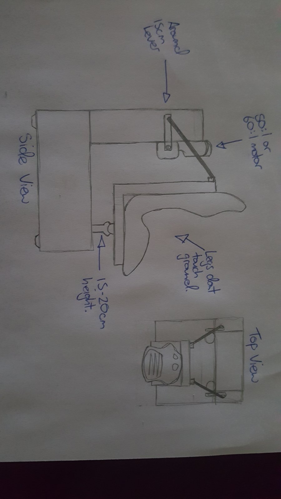

    I didnt realize you were also in Australia noorbeast. I have been reading through your compact 2dof build and am admiring the craftmanship. I think i will use it as inspiration.
    So basically your saying i should be theoretically ok with pushing and pulling 85kgs if i keep it under 40 degrees. So if i was to create a lever with a few different holes to go from 35 degrees down to around 20 degrees and test the motors capacity to drive those angles that could work?
    What motor out of the 2 i mentioned would work best for maybe 35 degrees of motion one way? If i can go the 50:1 that would be great so i can gain some extra rpm but am happy to use a 60:1 if needed.

    I follow you now noorbeast. So my lever which is connected to the motor cannot go more than 40 degrees either way or i will suffer large mounts of torque loss. So i basically have to stay within those parameters.
    I dont understand how my design affects the outcome of my seats maximum angles it can achieve?
    If i put my pivot point basically in the centre ofmy chair platform which it will basically end up being as i only have a chair with a person on it and no pedals or wheel attached wouldnt that mean my levers would then dictate how far i can tilt my seat as i would mount the levers to the back of the chair at thigh level.
    Thanks.

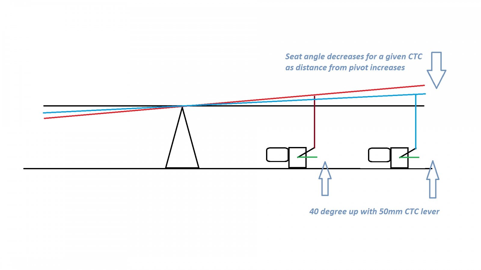

    The pivot point needs to be the balance point: https://www.xsimulator.net/communit...-of-gravity-to-balance-a-motion-simulator.55/
    The distance from the balance point to the lever for a given lever movement, say 40 degrees up and down, will affect how much the seat moves, but also what it takes to drive it.
    The shorter the distance from the balance point to the lever the more the seat moves, but it takes more power to drive it as there is less inherent leverage.
    Conversely, the longer the distance from the balance point the greater the inherent leverage, like the arms of a wheelbarrow, so less torque is needed but the seat movement would be less for a given lever length moving up or down 40 degrees.
    Hence why I say design affects everything. Here is a visual representation (not to scale):

    Very clear now noorbeast thanks.
    So im probably looking at the 60:1 gear if i decide to put the lever closer to the balance point and the 50:1 if i go further out eg the back of the seat.

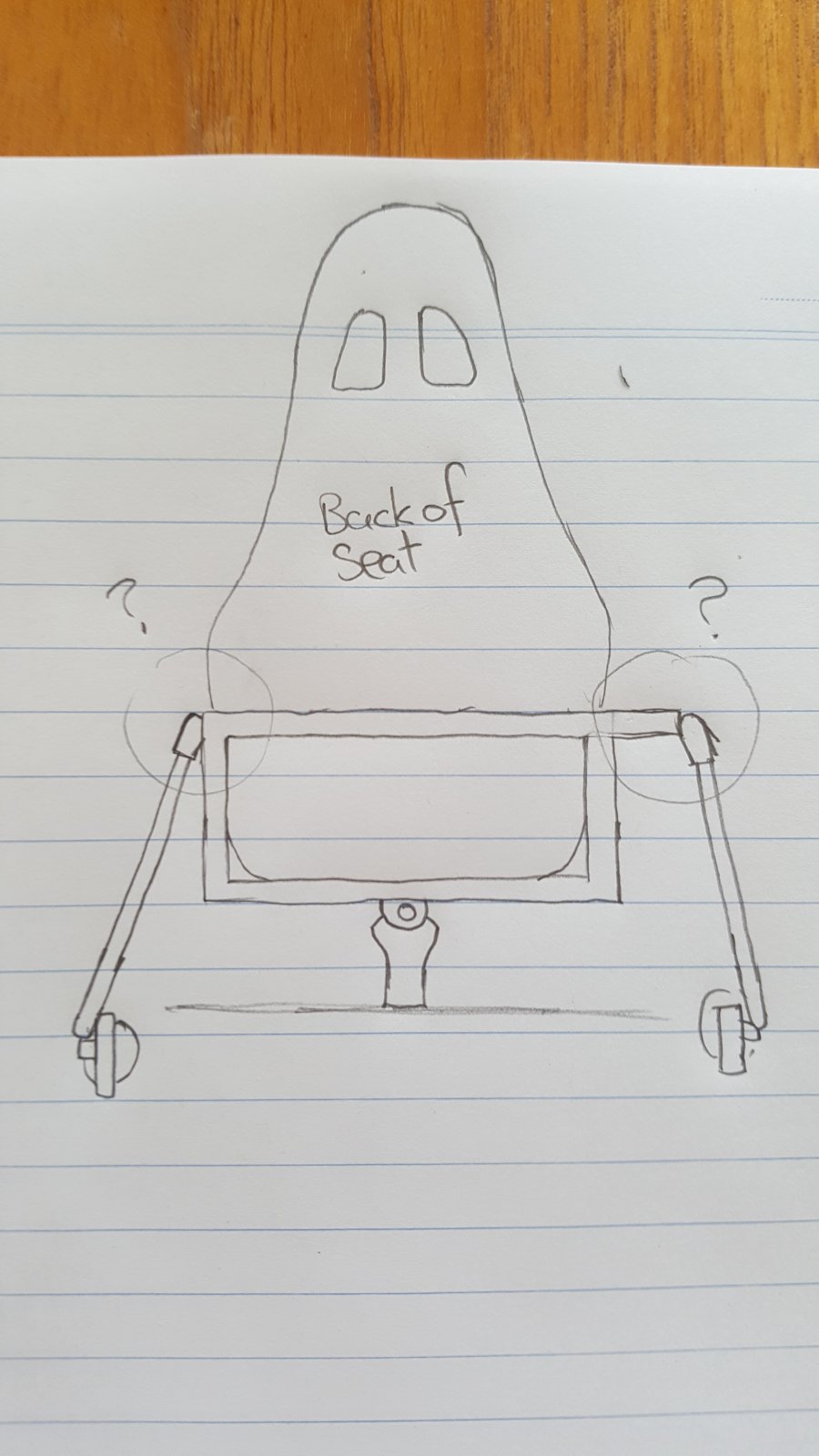

    Noorbeast as im going to be mounting the motors behind the chair and having the levers attach at thigh height is there any benefit to attaching them further out from the back of the chair or closer in?
    I have attached a picture for reference.
    Thanks.

    See @Tim McGuire's comments here regarding engine placement and effective angles, though keep in mind my subsequent comment that efficient use of torque varies depending on design: https://www.xsimulator.net/community/threads/2dof-build-log-thread.7559/page-8#post-120737
    A compact design needs more torque to drive it, but in some respects makes better use of it.
    In your sketch on the left rod it looks like the bottom tie rod angle may lead to binding, which is why I am guessing you extended the top right mount. If that is the concern then an alternative is to mount the rods on the inside rather than outside of the motors, or you could angle the motors.
    It is hard to comment further without side and top views, plus rough dimensions.
