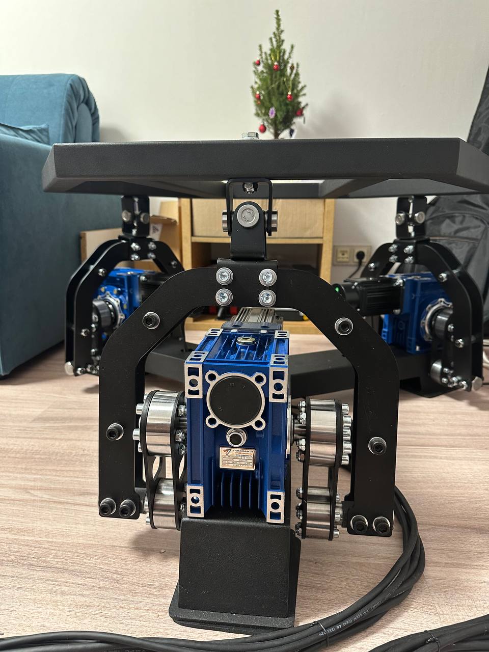

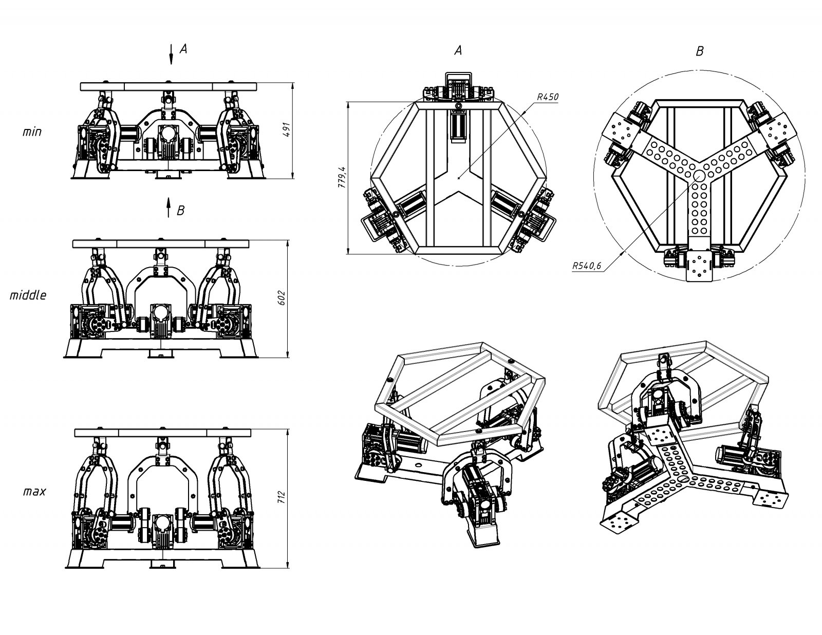

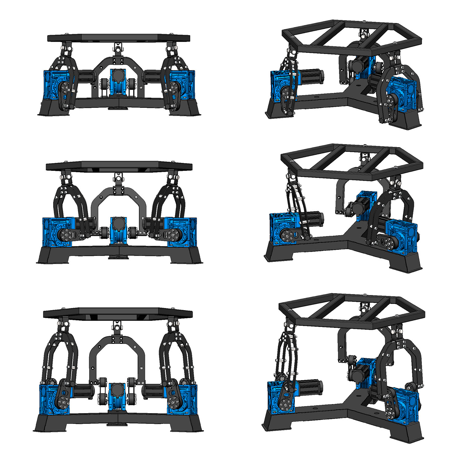

    I decided to fulfill my long-standing dream and build my first 3dof platform for motion simulation.
    To begin with, I built a 3d model in SolidWorks:

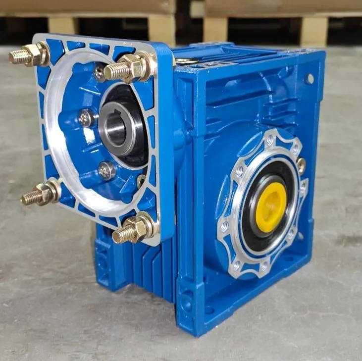

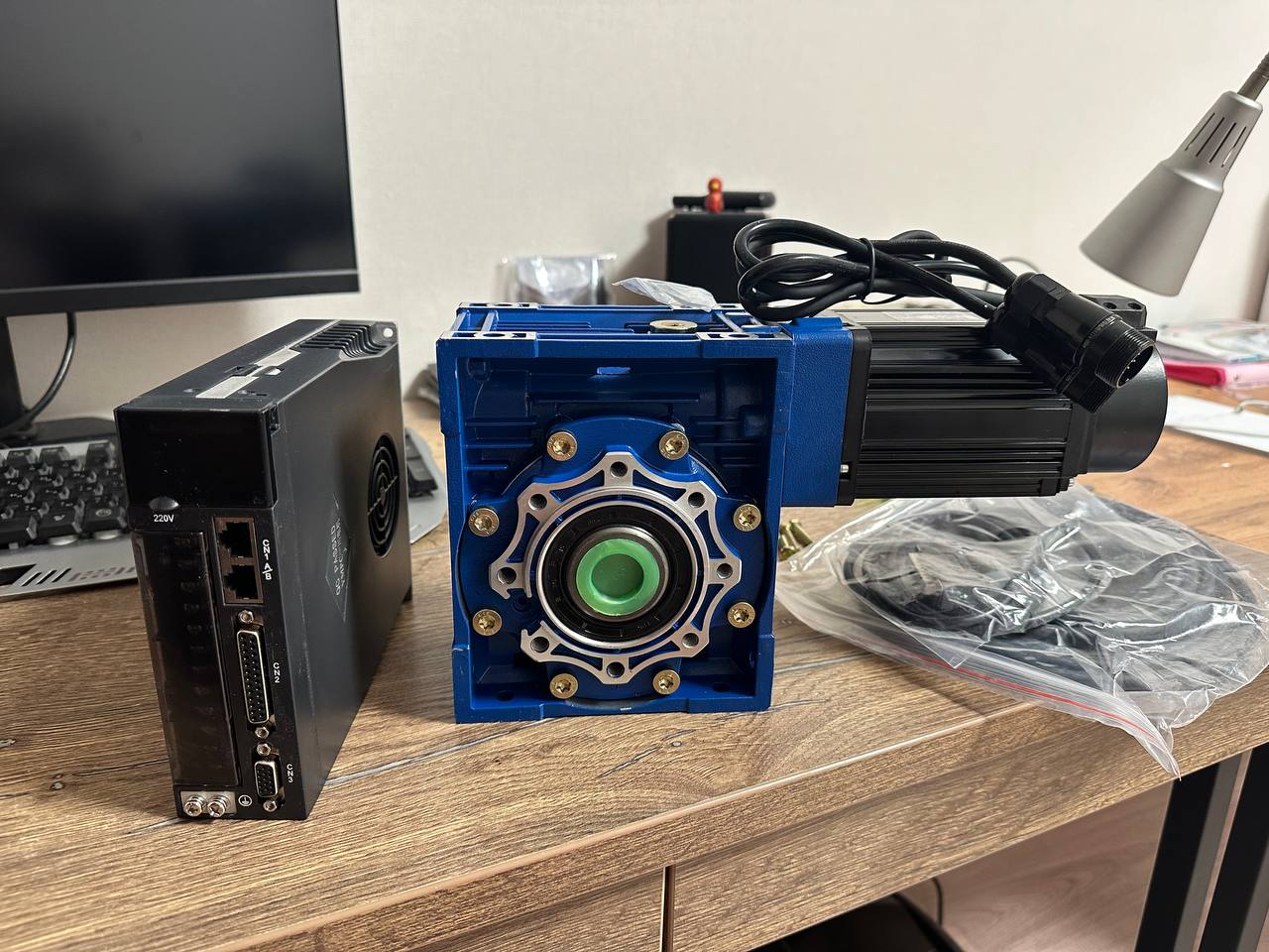

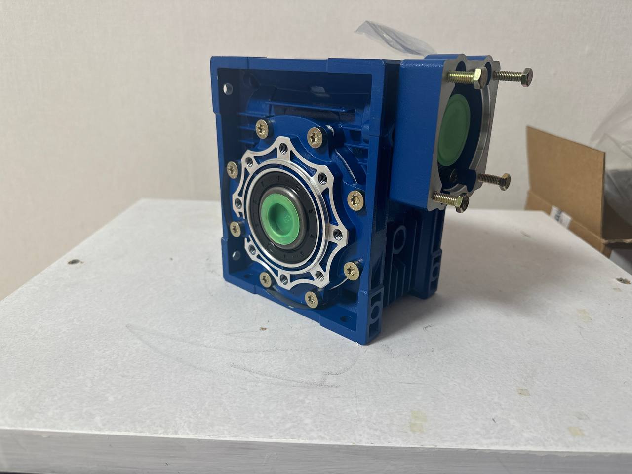

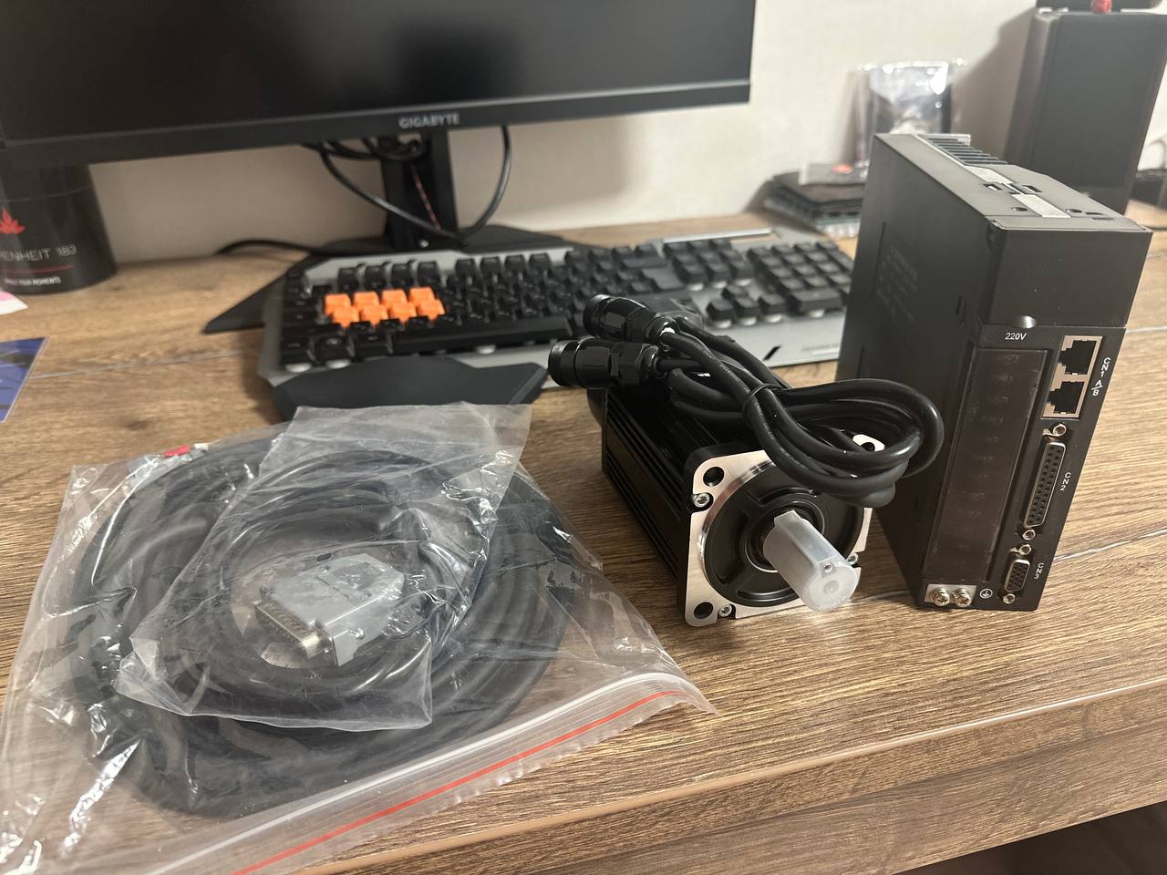

    As drives, I chose the 80ST-M02430 servo drive (A1-SVD15 driver) with a NMRV063-50 worm gear (1:50):
    80st.jpg nmrv063.png photo_5_2024-12-29_21-49-55.jpg photo_8_2024-12-29_21-49-55.jpg photo_15_2024-12-29_21-49-55.jpg

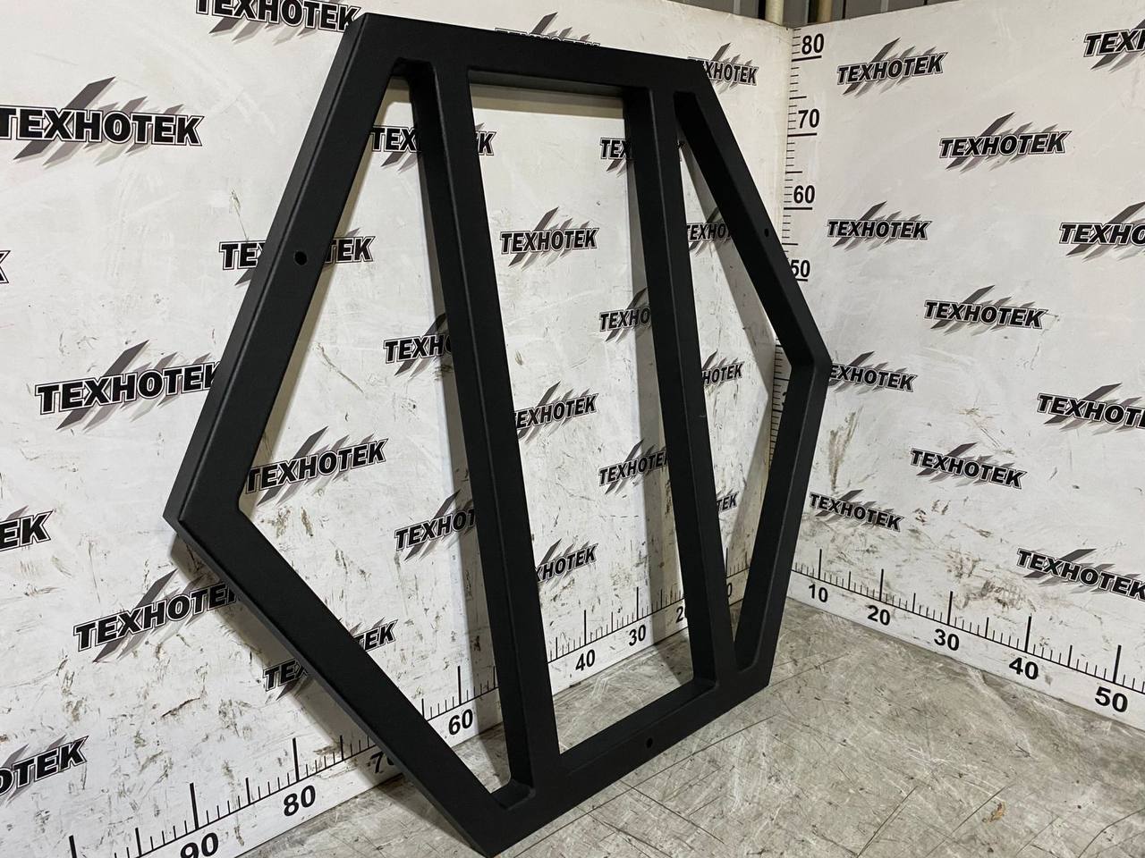

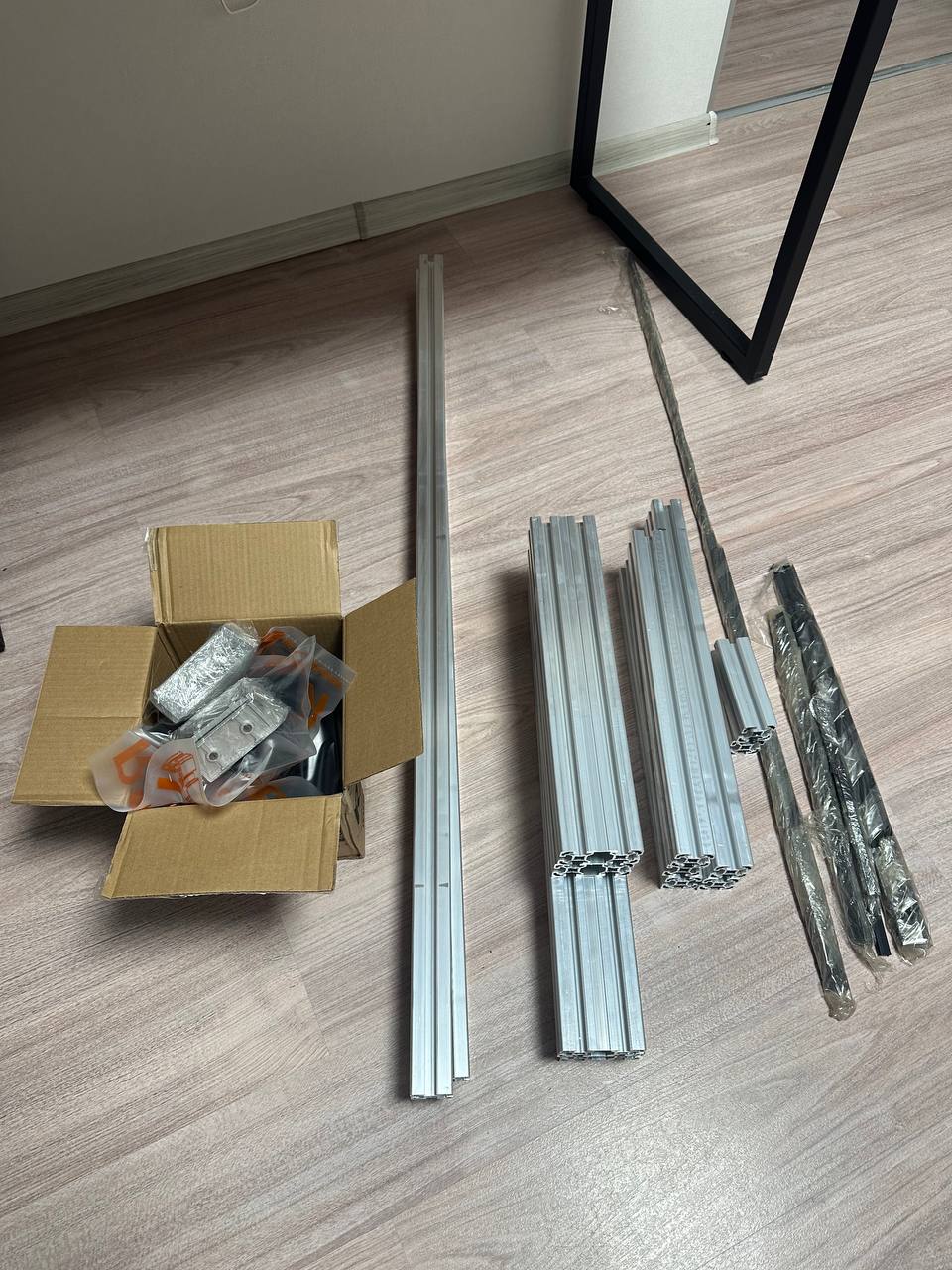

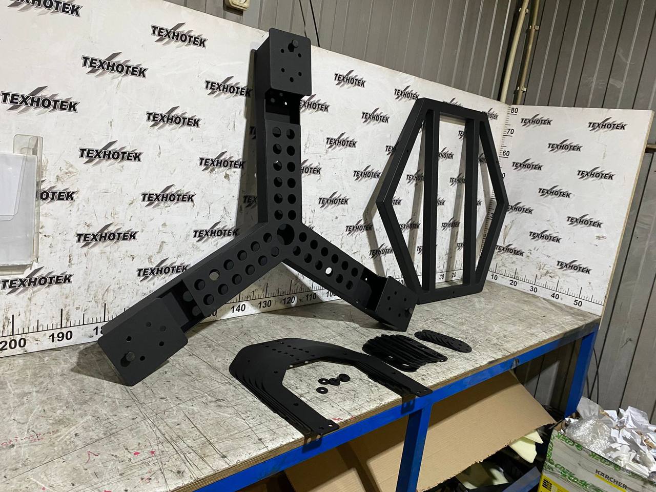

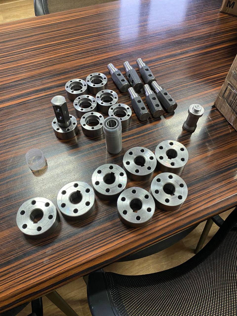

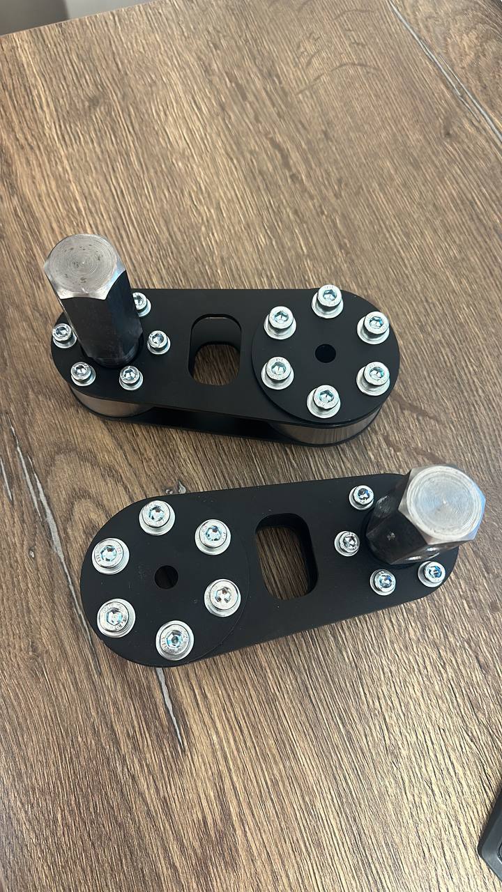

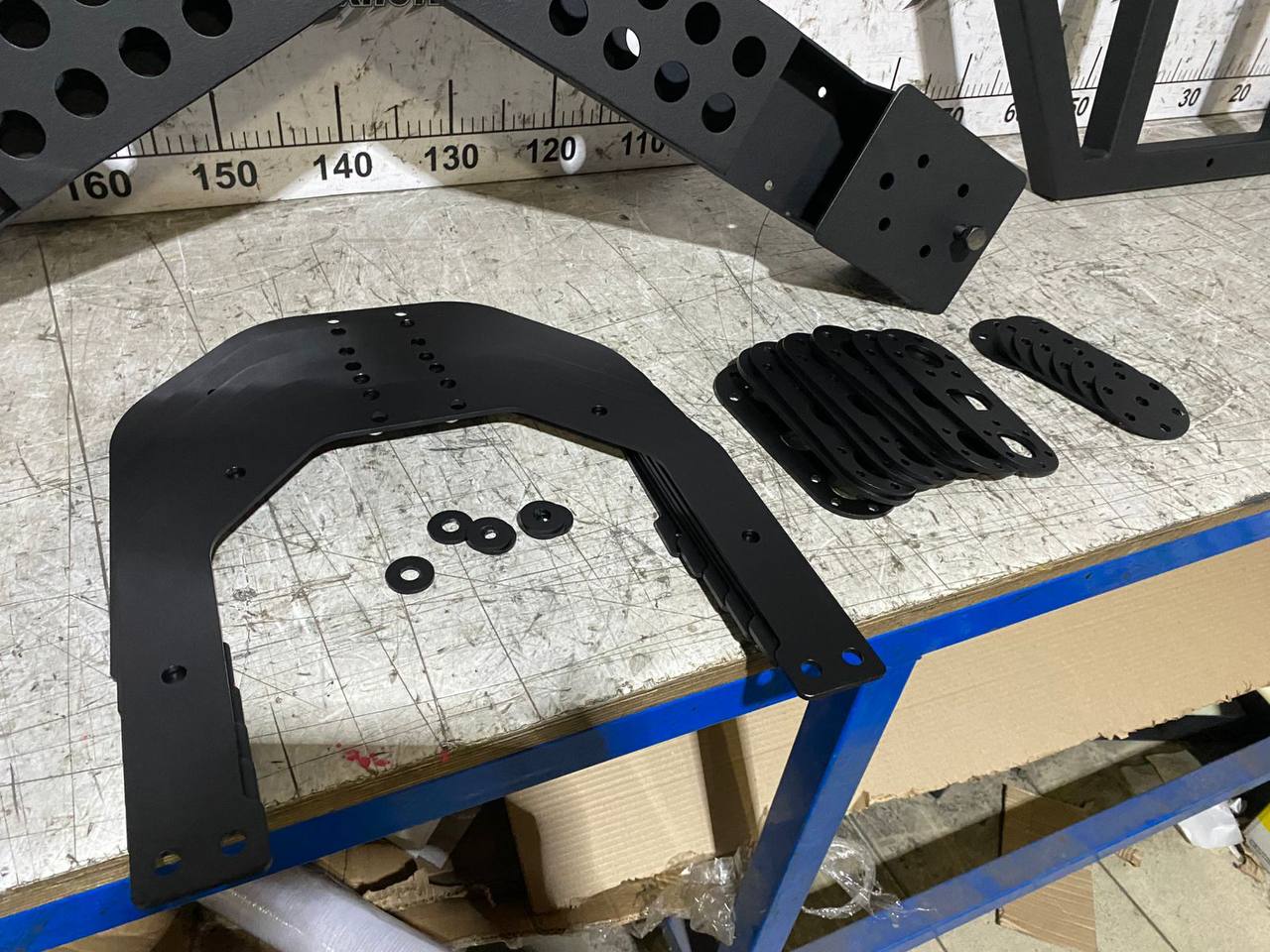

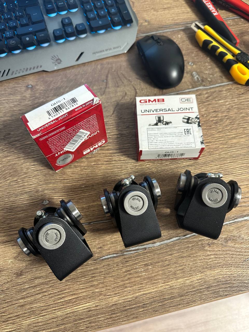

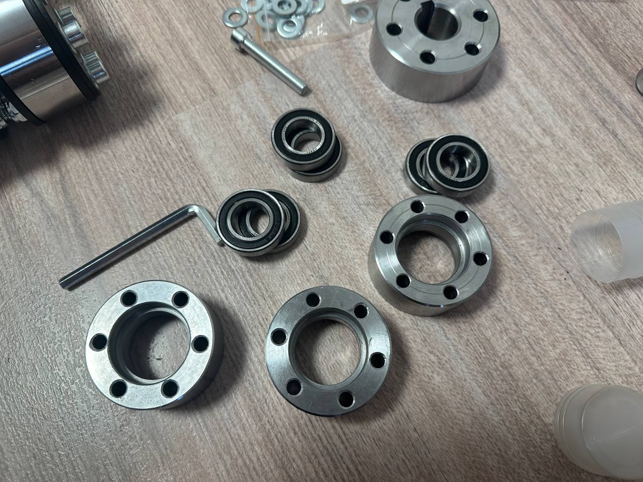

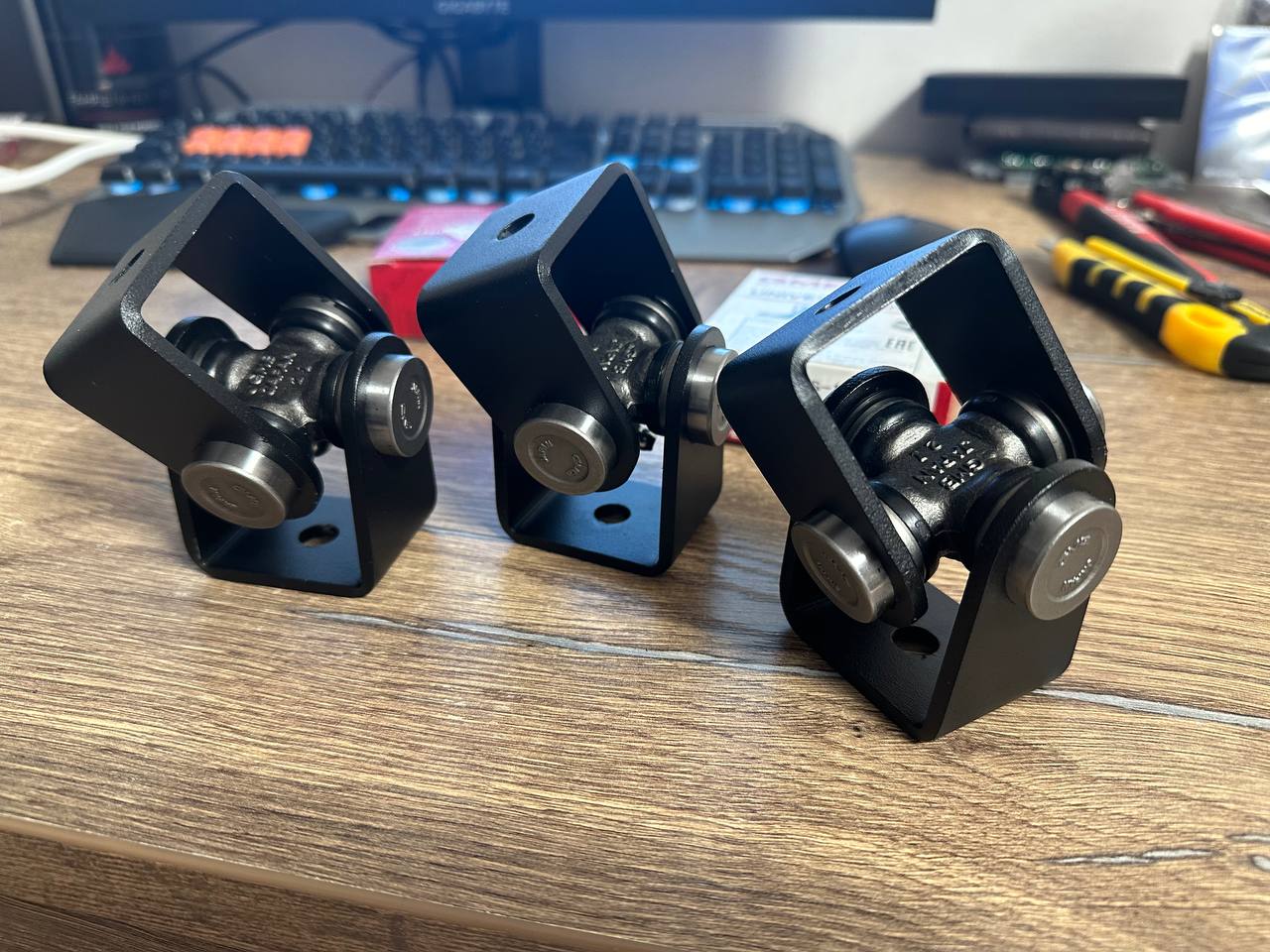

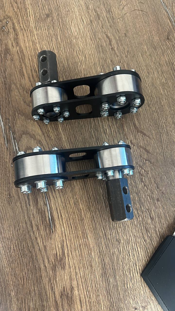

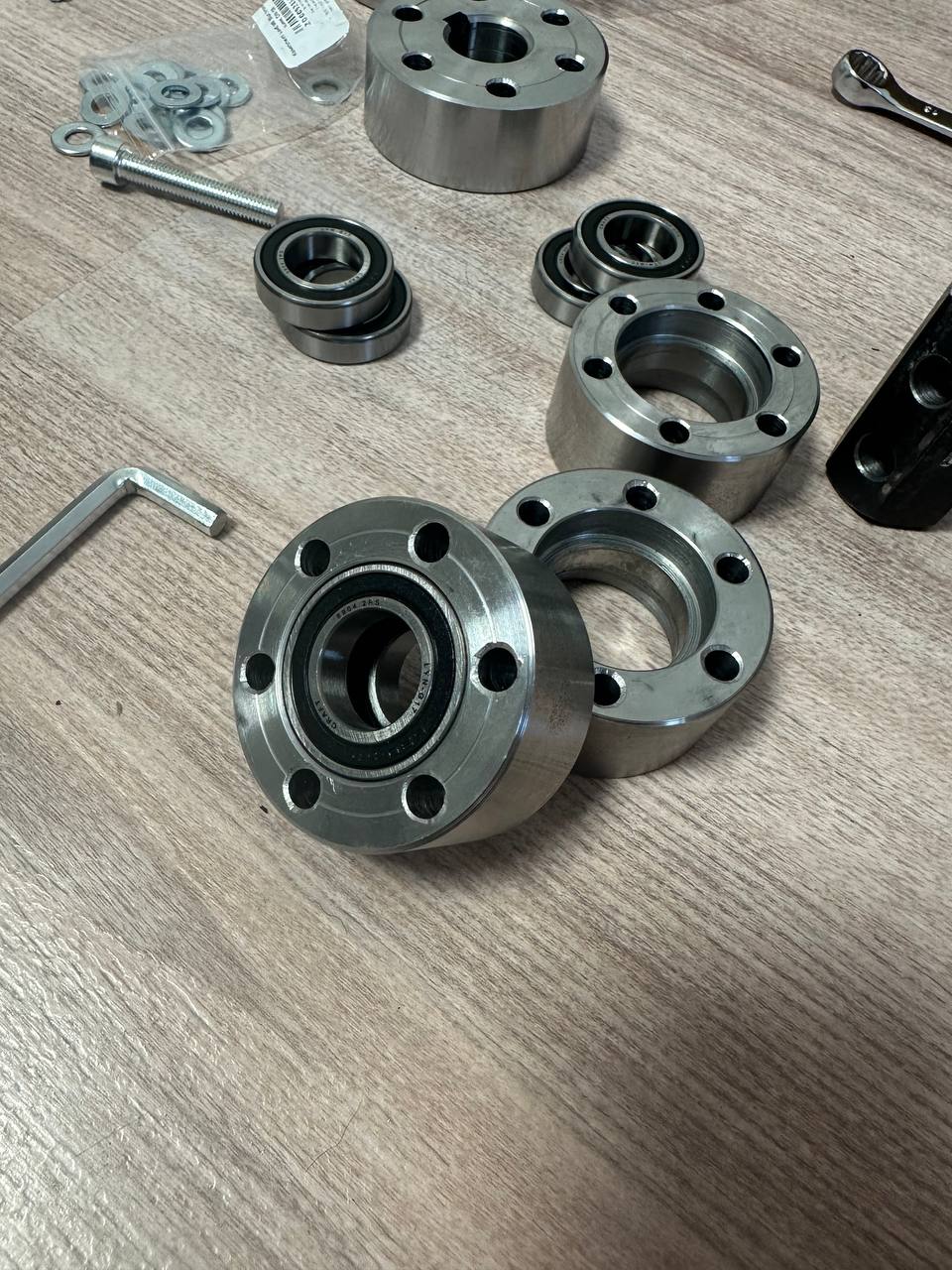

    After completing the working documentation, I placed an order with the factory. The parts were manufactured quickly:
    photo_4_2024-12-29_21-49-55.jpg photo_12_2024-12-29_21-49-55.jpg photo_7_2024-12-29_21-49-55.jpg photo_6_2024-12-29_21-49-55.jpg

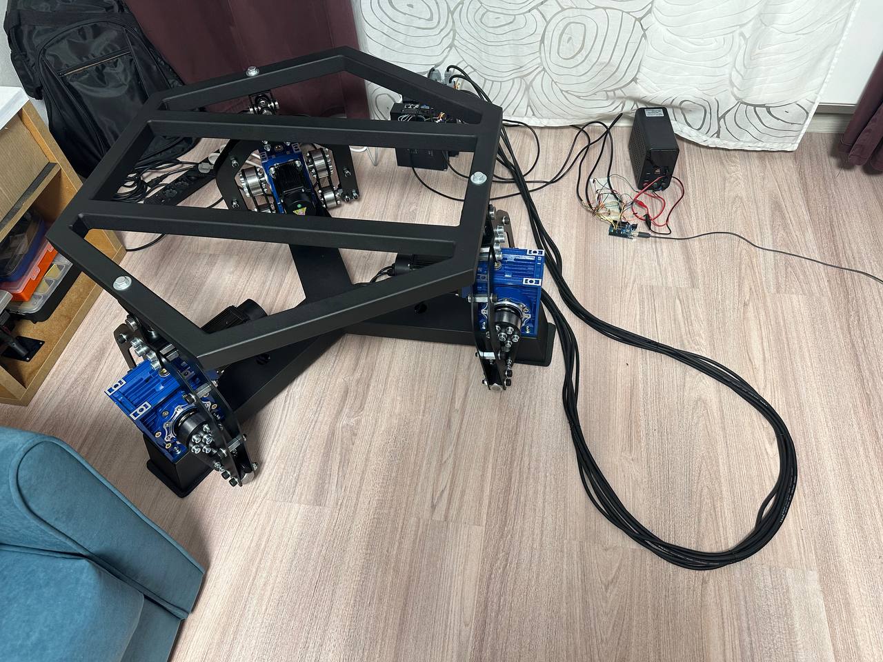

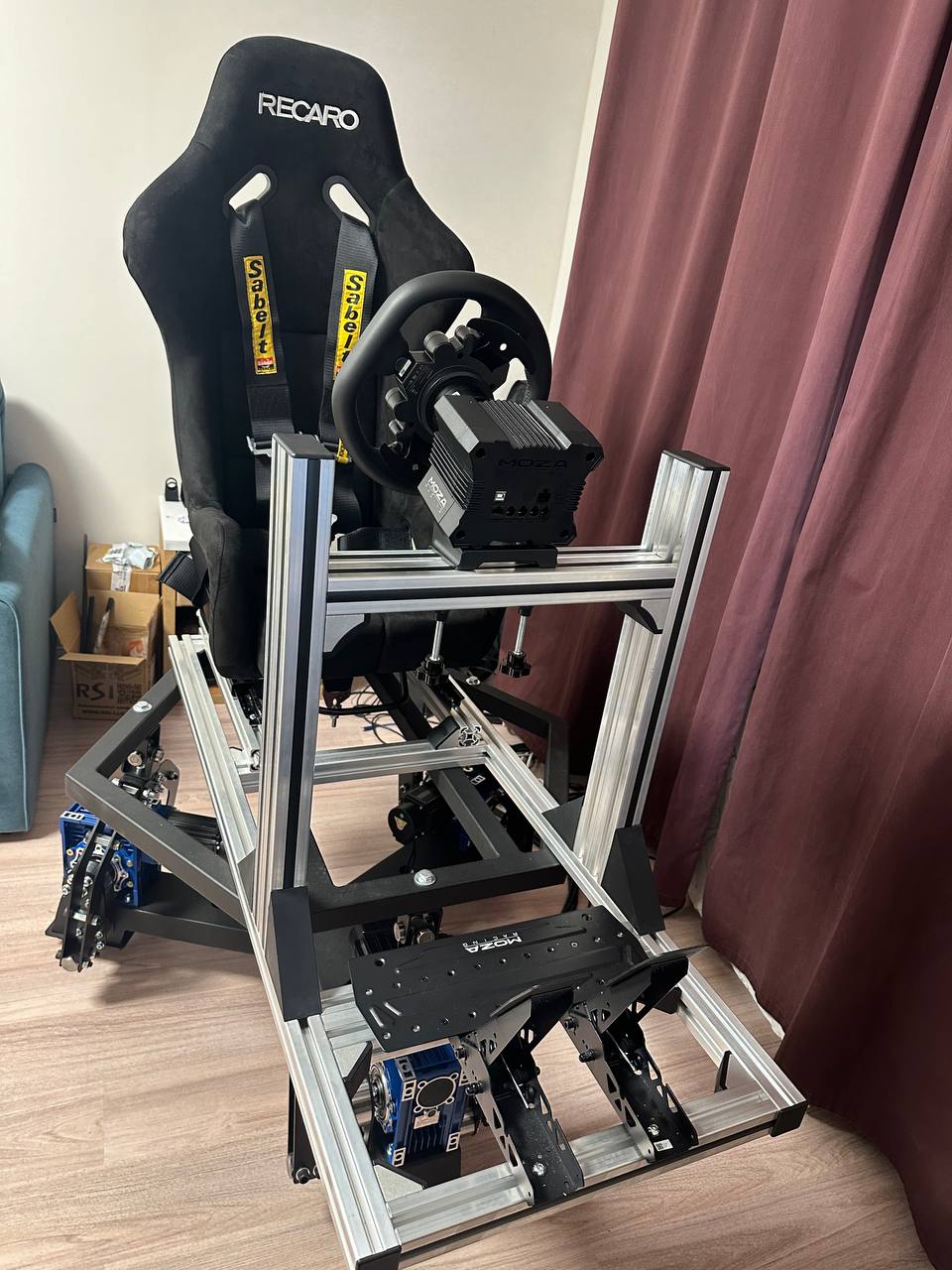

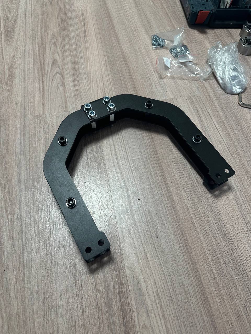

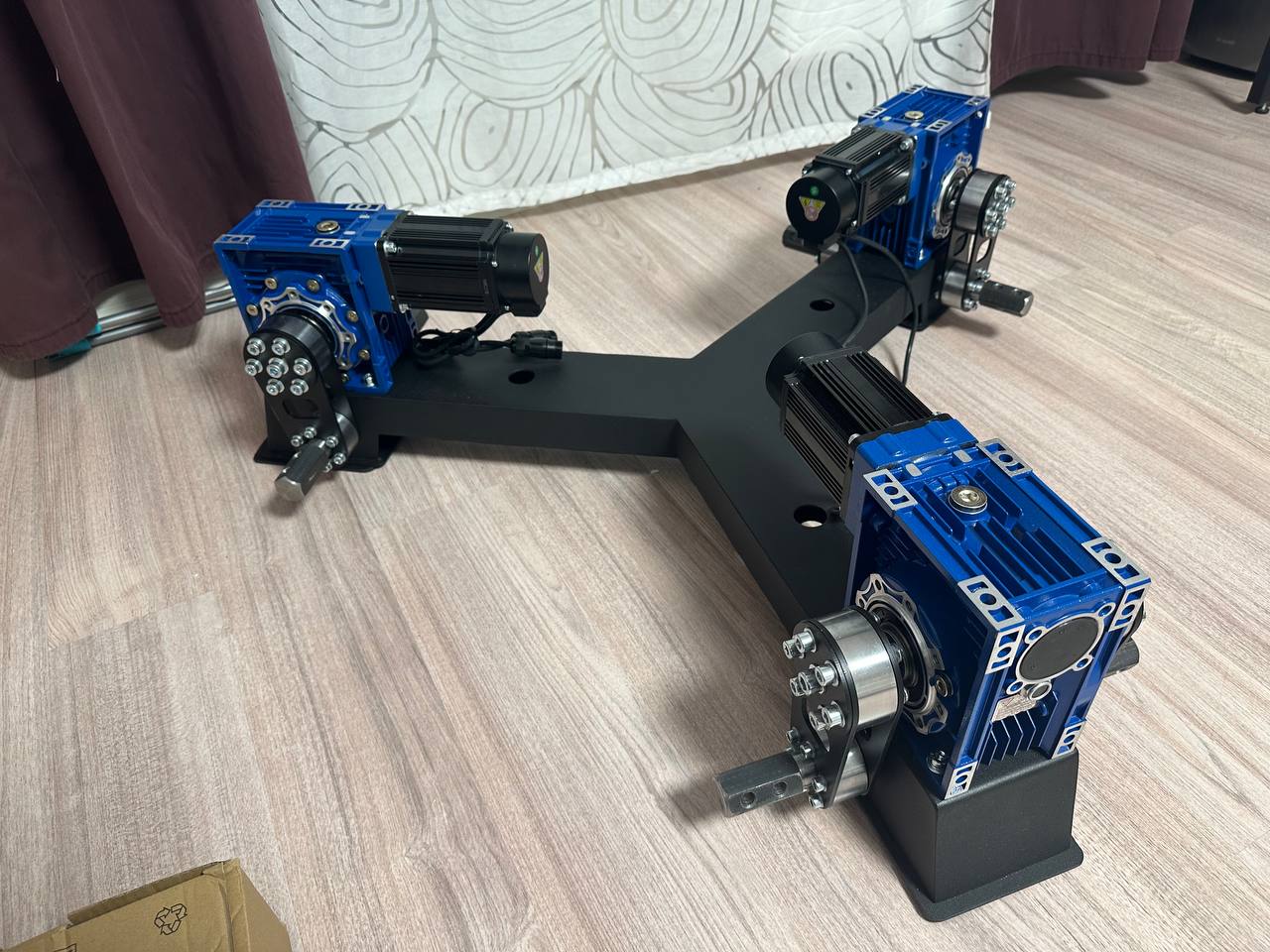

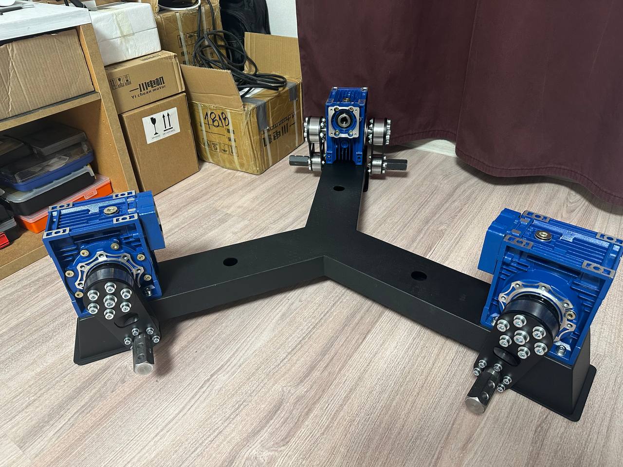

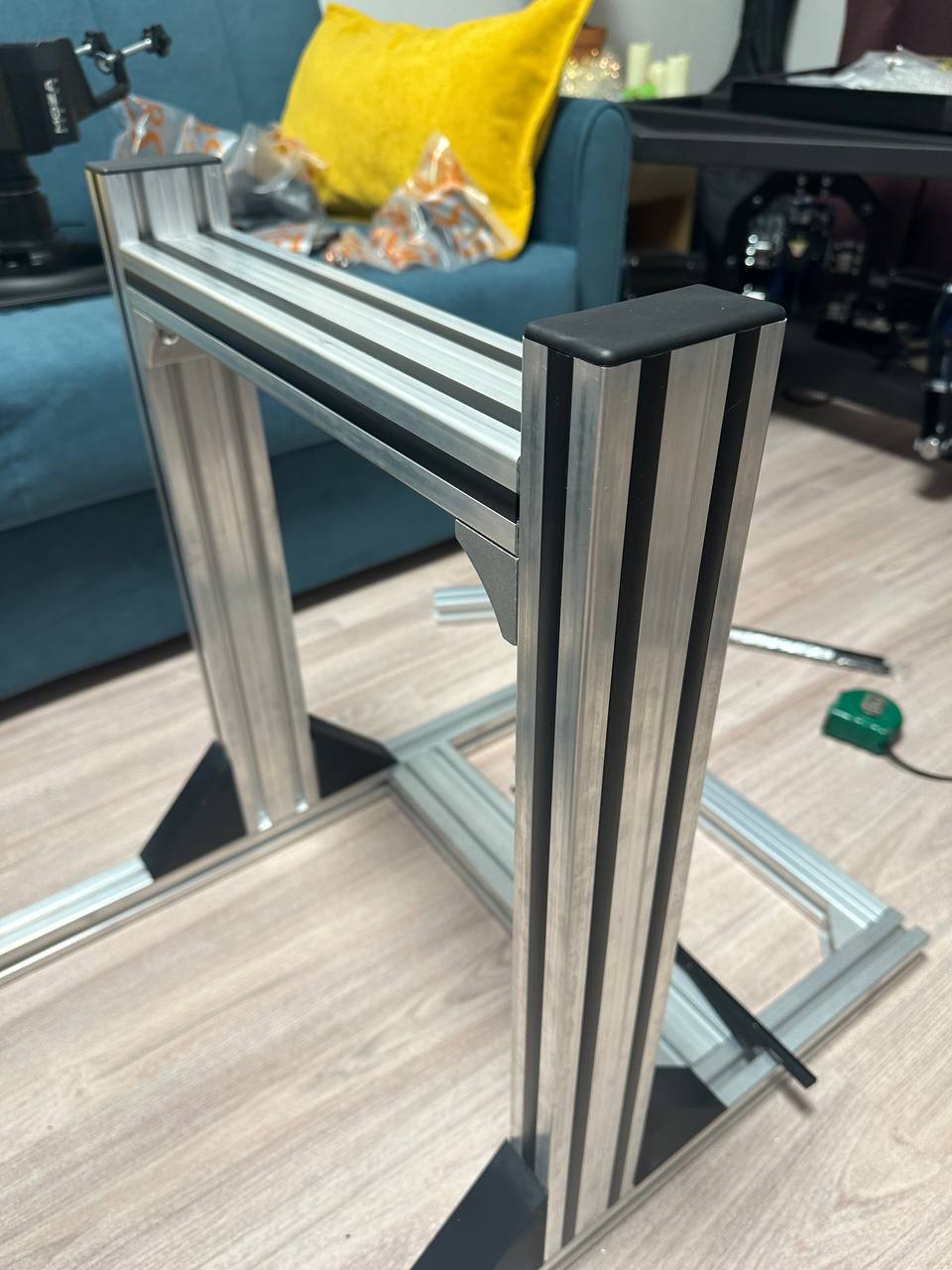

    When the parts arrived, I started assembling. There were no difficulties with the assembly: photo_26_2024-12-29_21-49-55.jpg photo_27_2024-12-29_21-49-55.jpg photo_9_2024-12-29_21-49-55.jpg photo_14_2024-12-29_21-49-55.jpg photo_25_2024-12-29_21-49-55.jpg photo_20_2024-12-29_21-49-55.jpg photo_17_2024-12-29_21-49-55.jpg photo_19_2024-12-29_21-49-55.jpg photo_18_2024-12-29_21-49-55.jpg photo_32_2024-12-29_21-49-55.jpg photo_30_2024-12-29_21-49-55.jpg photo_31_2024-12-29_21-49-55.jpg
    I use Arduino UNO as a controller. I found the servo drive connection diagram to the Arduino, the Arduino code, and the servo driver parameter settings on the @Lebois website. Thank you very much, my dear friend!

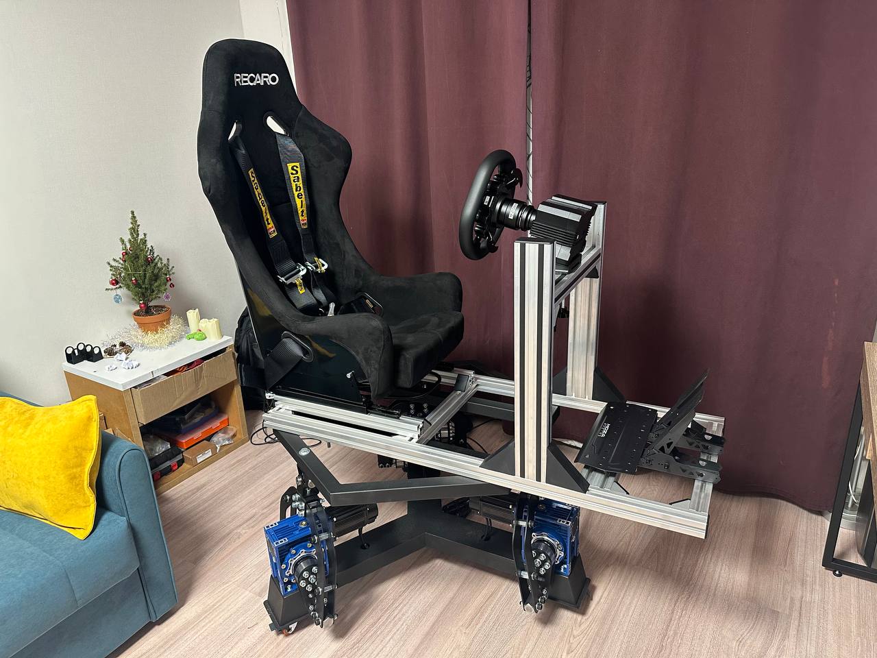

    At the moment, I have not yet purchased a SimTools license (I will definitely buy it later) and am trying to use FlyPT with the DIRT 3 game. The platform moves, but there are some problems, such as uncontrolled sharp rotation of the drives during platform operation (I will upload a video a little later). I understand that I need to configure filters, but I have not yet figured out all the FlyPT program settings.

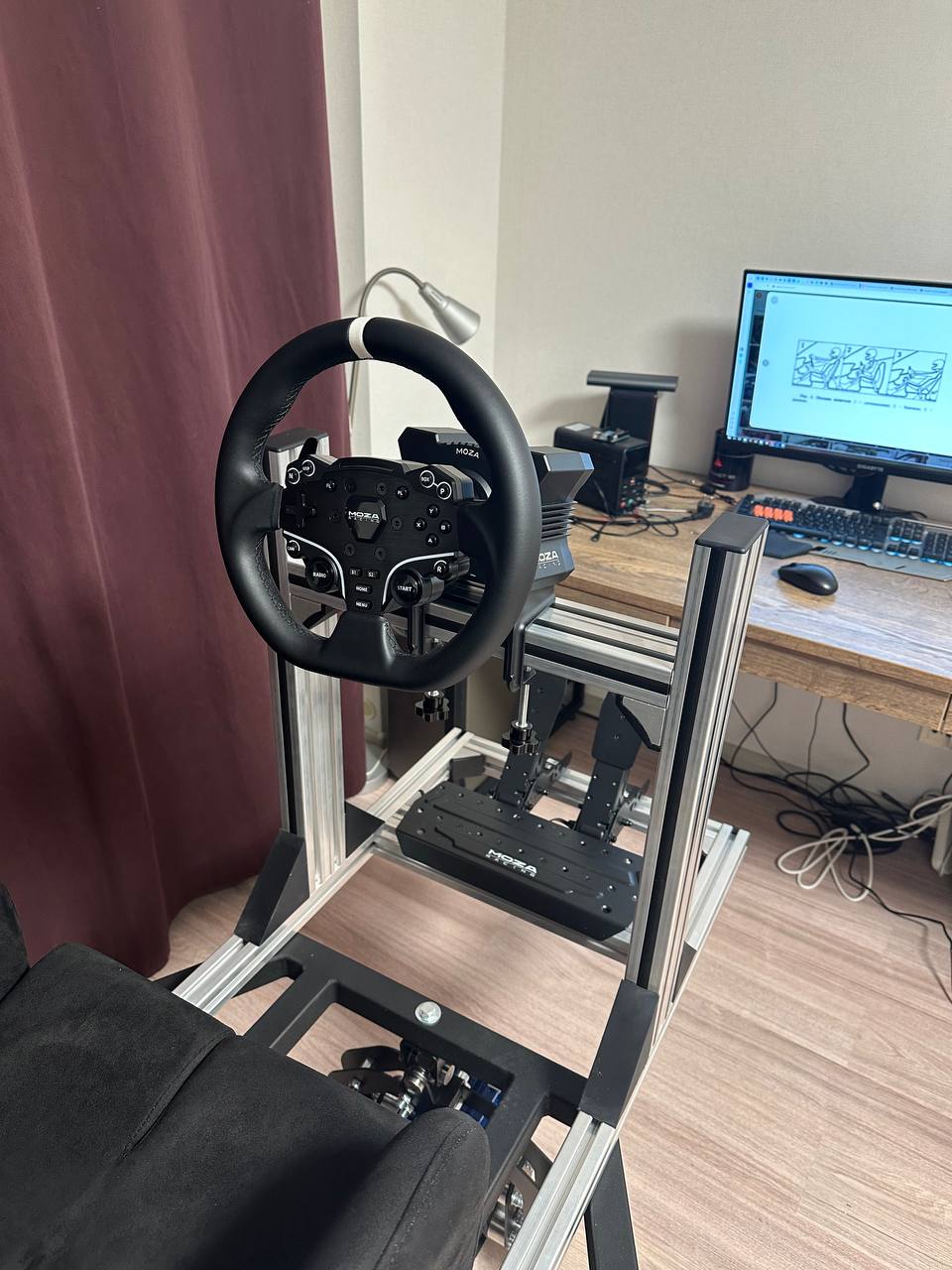

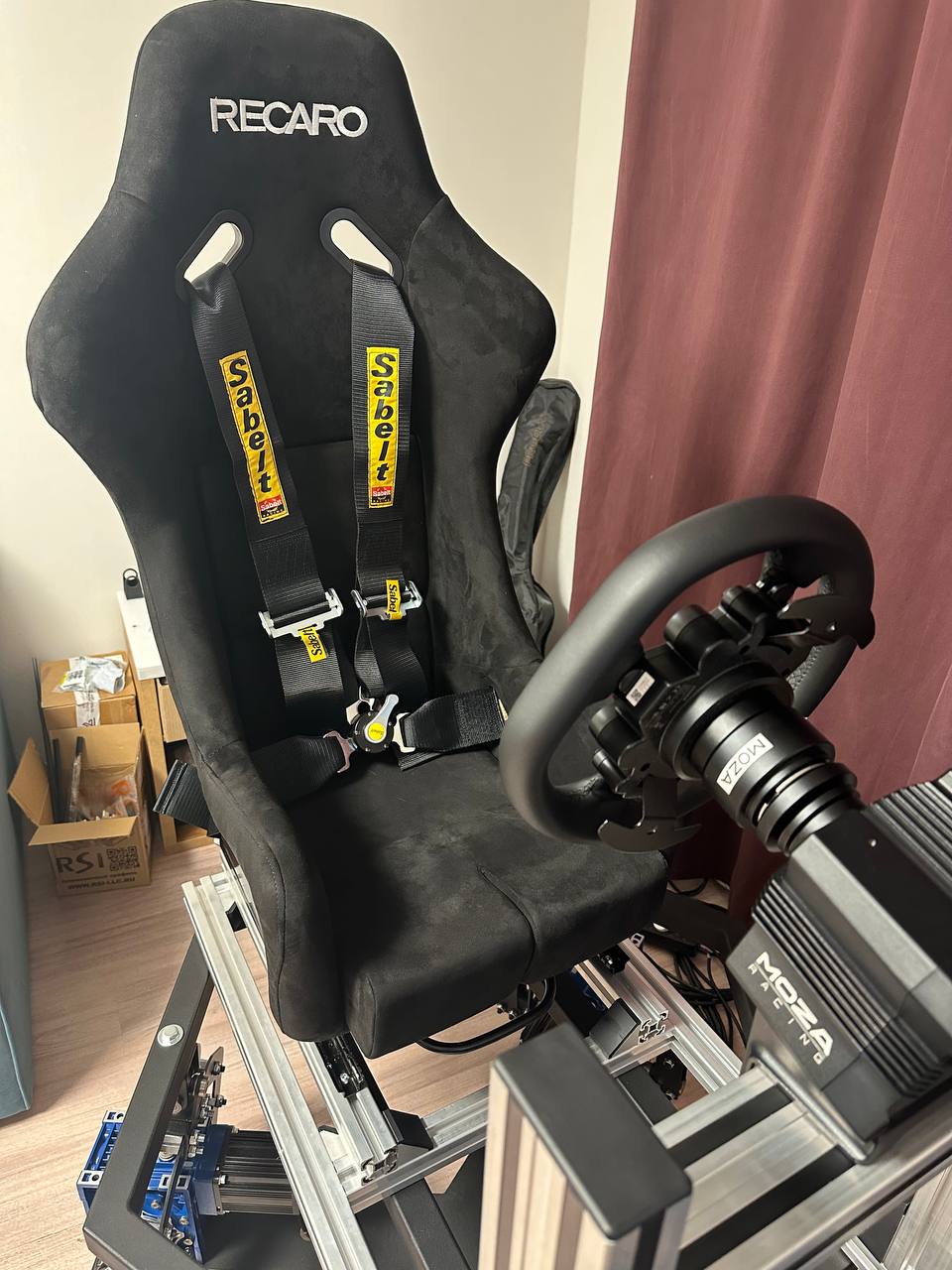

    After setting up adequate platform movement, I am going to install the chair and the Moza R5 kit.
    I would like to note a significant drawback of worm gear drives - this is a "knock" (noise, impact) when changing the direction of rotation of the servomotor. This happens due to play in the gearbox engagement. At the moment, I do not know how to reduce this "knock". Has anyone managed to solve this problem?

    Nice work! The knocks caused by the backlash of the gear will hopefully disappear when there is enough weight on the rig to ensure that the gear is always biased in the same direction.

    To test the reduction of knocking caused by backlash in the gears, I loaded a platform weighing ~ 130 kg (me and my girlfriend). The sound has become a little quieter, but still significant.

    Pragmatically, the longer the lever attached to the motor the more pronounced any inherent backlash will be.
    A small amount of positive weight bias can help mask backlash, but will not eliminate it it, particularly with a fast powerful rig.

    After the first test, I had to install filters: Roll, Pitch, Heave = EMALP(VALUE; 200.00)
    It is very difficult to stay on the platform without these filters!
