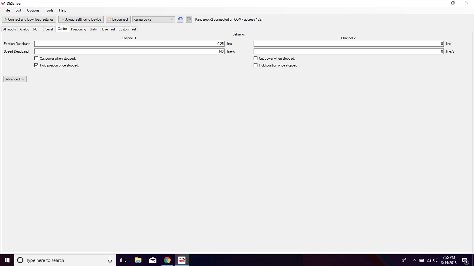

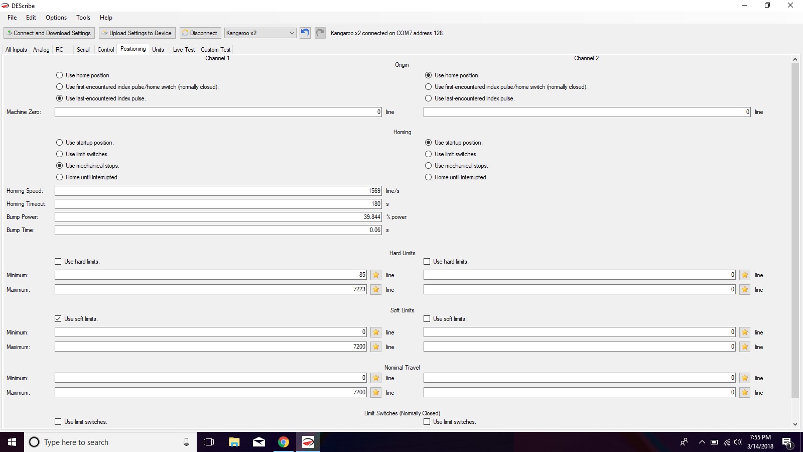

    Hi, Fairly new here. I wanted to build a 24v race sim, but so far ended up with a 12v bucking bronco and I need some help. I've have the rig built and running. I can tune everything, but when I run LFS or Assetto I don't get any consistent motion. The rig will center properly, momentarily work, then sometimes freeze start working again then kick to random angles.
    It's like someone is playing with a remote behind my back. Running 12v and game engine at 70% so it wont beat me up to much. Any ideas?
    21,188
    148,808Coins
    +10,918 / 54 / -2

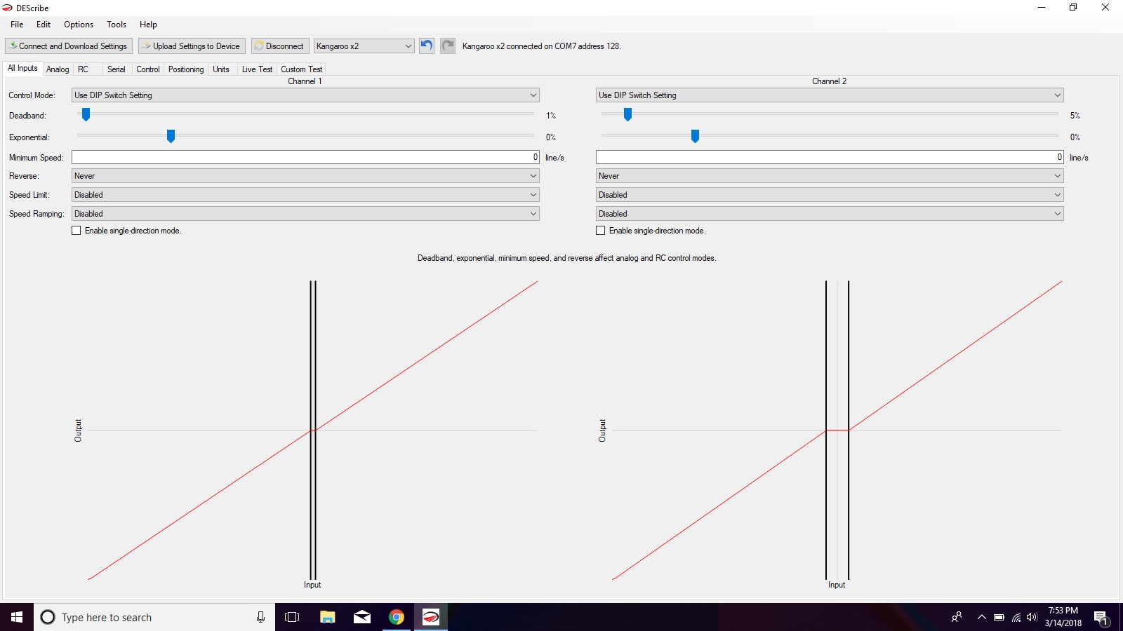

    Can you please post picture of all of your settings.

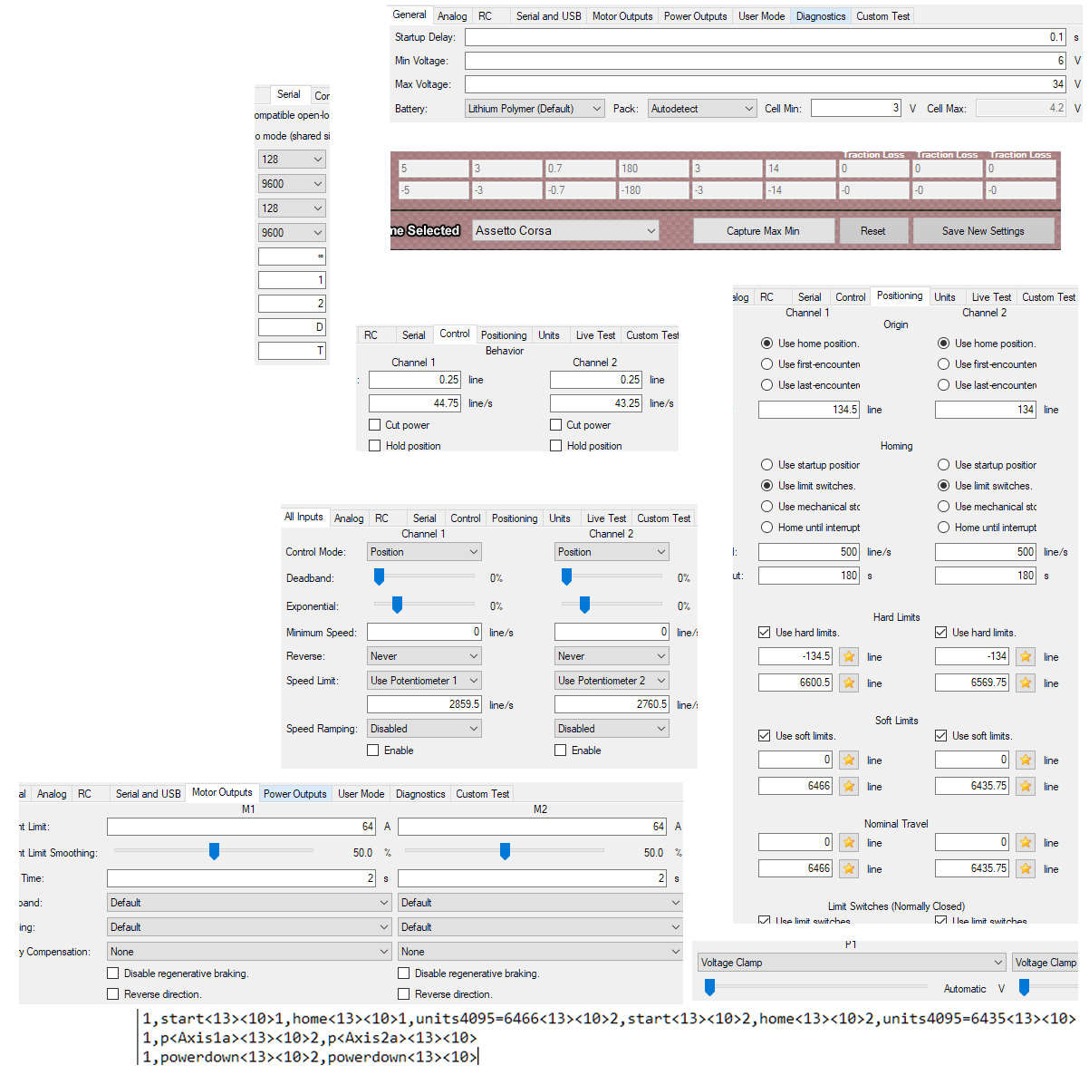

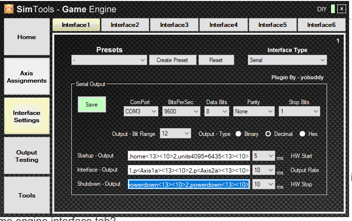

    try this for start up command
    1,start<10>1,home<10>1,units65535=6466<10>2,start<10>1,home<10>2,units65535=6435
    remove the <13> it isn't necessary

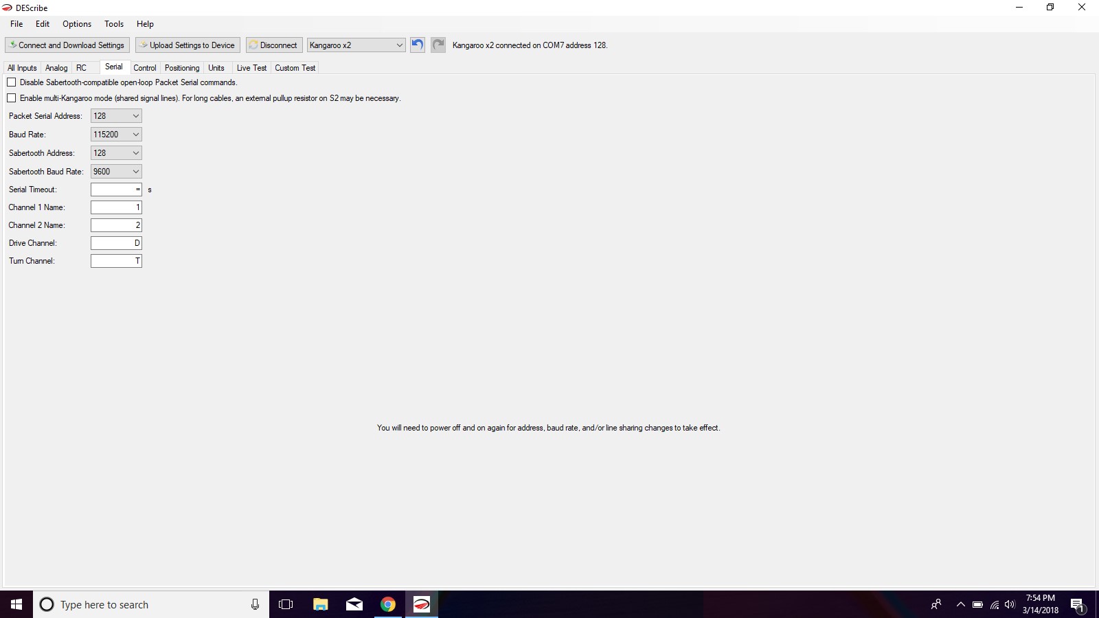

    you will want to also change the value for the baudrate to 115200 (serial tab in describe) then make it match in the game engine leave the sabertooth at 9600
    can you do a screenshot of the game engine interface tab?

    Is this what you need?

    I've changed the BitsPerSec to 115200 and removed the 13s

    I believe you can change it to 16 bit. and the baudrate 115200. (same as it should be under serial tab in describe) :grin

    Working with 115200 and 16 output bit range, but now it homes near the second limit switch not centered?

    hmm.... is set in describe, although I'm not sure where. I use the mechanical stops method of tuning the roo.

    Went back to 12 bit and everything works.
    Fired-up Assetto worked for a bit stuttered a couple of times then power supply shut off!?

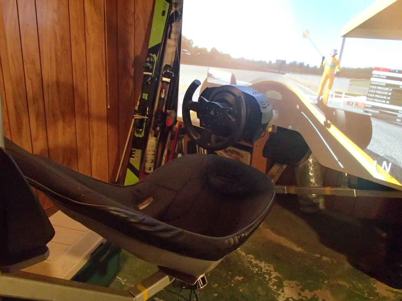

    Took the time to rebuild my rig. Same concept, new design.
    I'll post a video when I get it working
