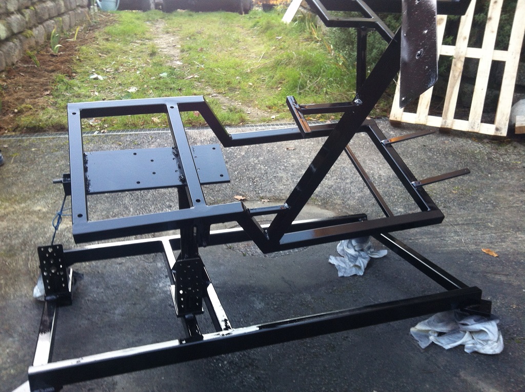

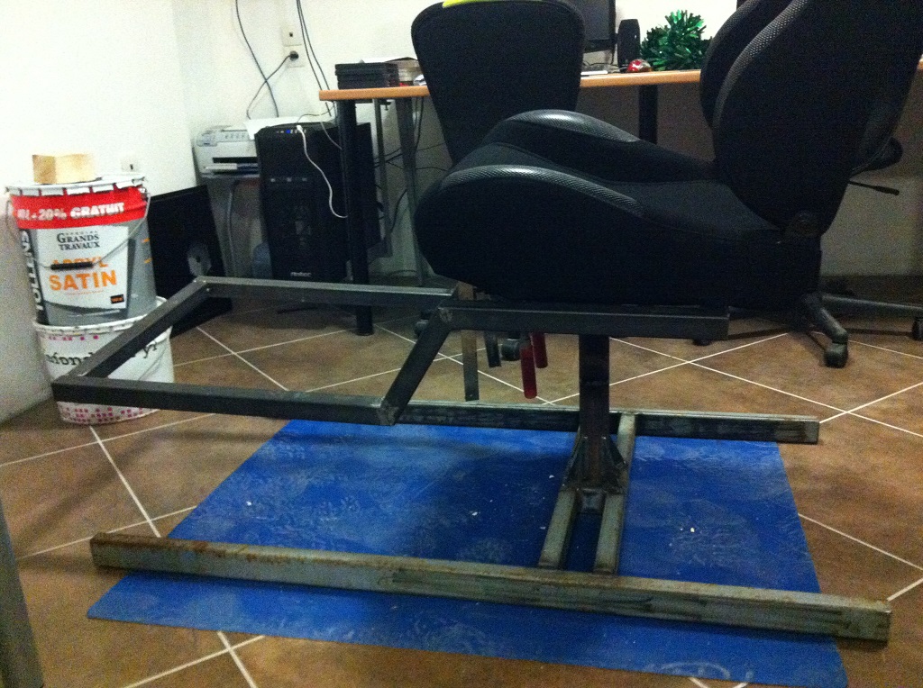

    IMG_2318.jpg IMG_2309.jpg 01b9dd9ed07d21d7cd286879adef162a86c9108c55.jpg Bon des Photos de mon simu:

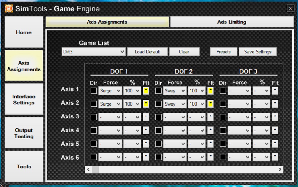

    Maintenant j'ai pointer le bon chemin et ça fonctionne presque.
    J'ai les effets latéraux mais pas longitudinaux o_O
    Now I have to point the right way and it almost works .
    I have the side effects but not longitudinalo_O

    Could you please post screen shots of your settings for SimTool and the Tuning Center.
    Have you done a base setting for the Tuning Center: http://www.xsimulator.net/community/faq/set-base-tuning-motion-values-in-the-tuning-center.122/
    As an example here is @prodigy's Project Cars settings, note the comment that the bigger the number in the Tuning Center the less powerful the force effect and do keep in mind each sim is different and the motion profile must be tailored to suit: http://www.xsimulator.net/community...sabertooth-moteur-essui-glace-24v.6387/page-2

    You probably need to check the Dir checkbox for some Axis

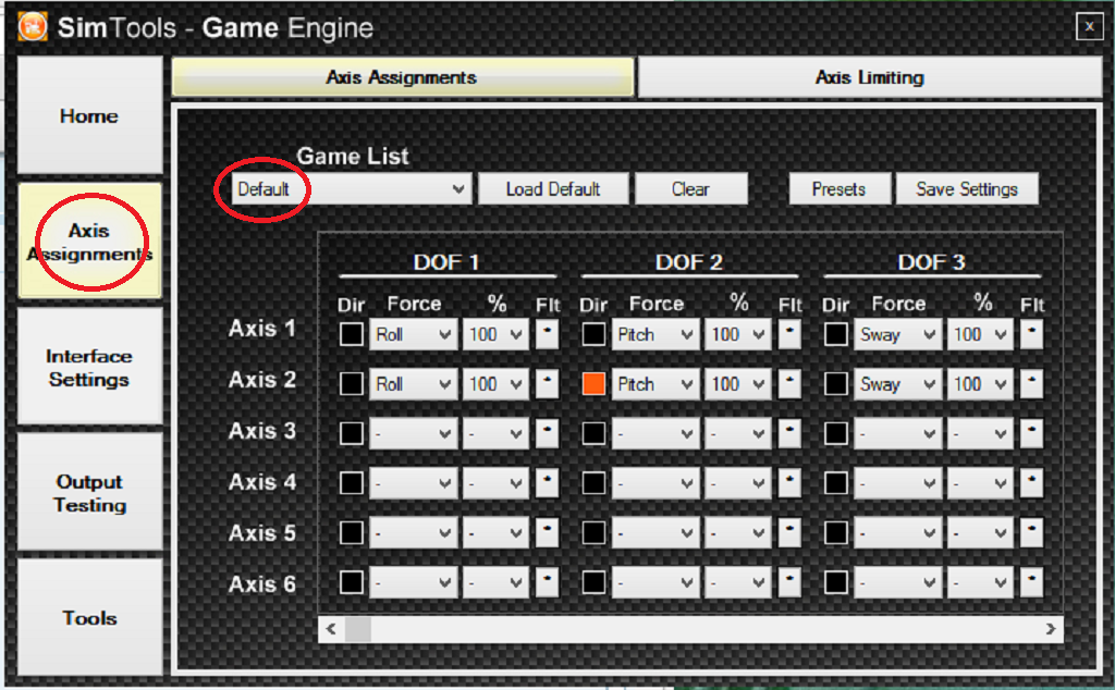

    Bon, j'ai trouvé pour l'axe qui ne fonctionnait.
    Dans "Axis Assignments" "Game Defaut" j'ai rempli les champs et sauvegarder.:thumbs
    Roll, Pitch, Sway et Surge fonctionnent très bien quand je teste dans "Output Testing".
    Mais dans un jeu j'ai très peu d'effets d’accélération et de freinage o_O
    L'effet latéral fonctionne bien.
    Well, I found the axis that worked.
    In " Axis Assignments" "Game Default" I filled the fields and save . Thumbs
    Roll, Pitch , and Surge Sway work fine when I test in "Output Testing" .
    But in a game I have very little effects of acceleration and brakingo_O
    The side effect works well.

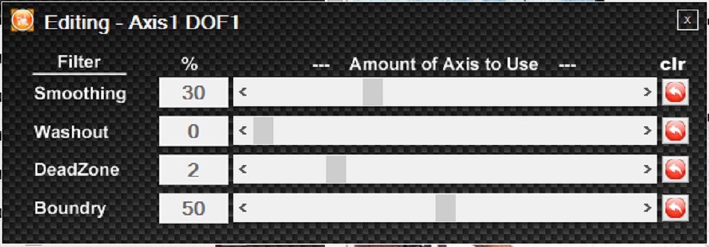

    You can play with the Max/Min settings in TuningCentre. The smaller the Max/Min settings the more motion you will have.

    Here is my earlier post regarding the Tuning Center: http://www.xsimulator.net/community/threads/salut-à-tous.7124/#post-82956
    Once you have a base profile tweak each force individually by manually adjusting the Min/Max for each force in the Tuning Center. When happy with each then turn them on and recheck what it feels like combined, as some forces like pitch and surge can have a cancelling effect on each other.
